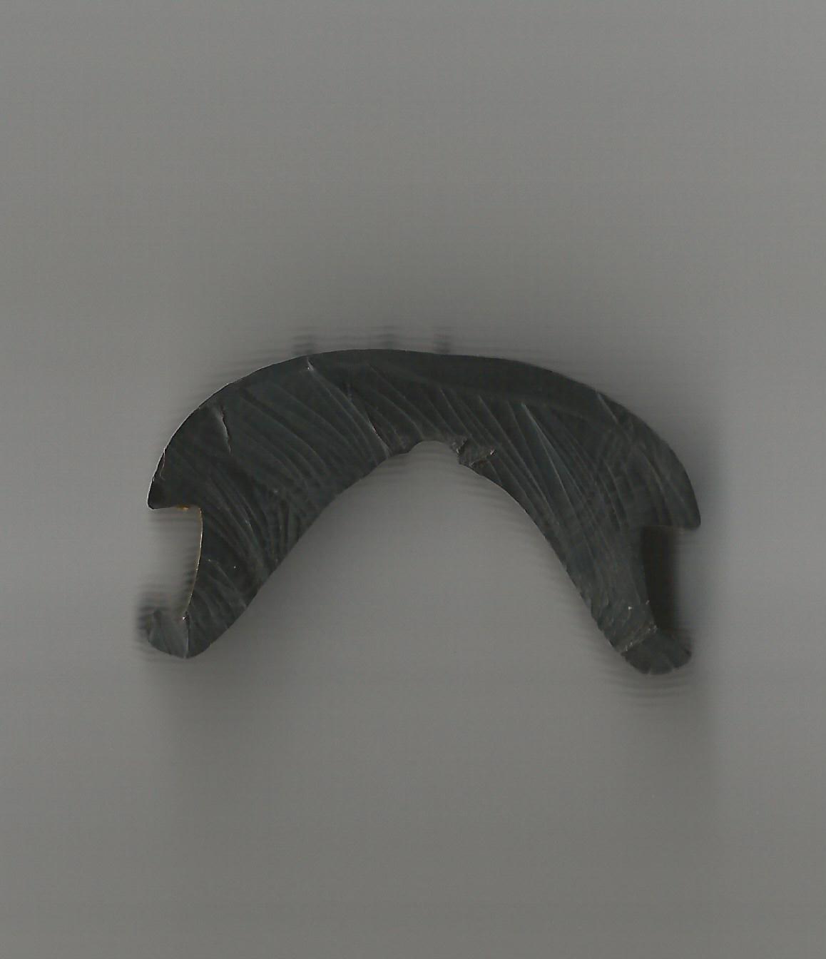

Being able to remove the rubber fender strip and then reassemble it. despite its age the rubber is still quite pliable and I think if I leave it until a warm day it should go back in OK. I've experimented with a short section across the stern and have been able to pull out and then reinsert the rubber without problem.
Has anyone separated deck from hull,is this a common practice? Also does anyone know if the rubber section is still obtainable?
I've looked on line but have not found a match yet.
The section is 1,5/16" wide and 3/4" high.

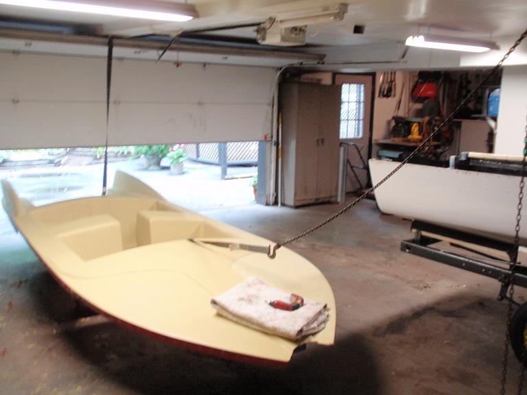

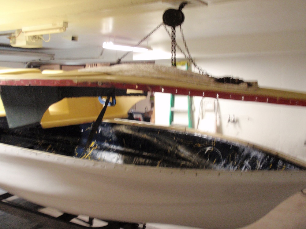

Your project is done fairly often. Sometimes referred as "popping the top" Most of the older model boats were constructed in the manner you describe, hull and topside. The rubber bumper serves two purposes, one is to hide the seam between the two parts and the other is to protect the boat from bumps and scrapes while tied to a dock. Unless you are a purest and want to put the two pieces back together the same as the factory there are several ways to re-attach the two. After you remove the top and replace the transom you can put the topside back on and glue it using 3m5200, use a bunch of pop rivets, screws with wood backing and or any combination. A word of caution though, before you remove the top put some cross member bracing inside the hull to keep it from spreading out.
I'm sure you'll get more advice on this from other members.
Here are some pictures from years back on one of the boats I removed the top on.
