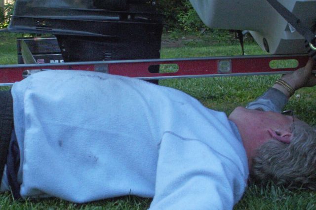

Please post a few pictures showing the height of the cavitation plate in relationship to the bottom of the hull.
Hold a straight edge (or long level) held firming against the bottom of the center of the hull with the aft part of the level extending aft enough to show its relationship to the motor's cavitation plate, and have a pal snap pix.
Also,...Since you are at the helm on the starboard side, but the hull leans to port underway,...Perhaps all you need to do is reset the aft edge of the anode (trim tab) more to port???

From what I see in the picture of you with the level, that's a Vee Bottom without a pad. So on a plane it will want to fall over one way or another. Trying to get pure V bottoms to stabilize is a real challenge. Not saying it can't be done, it's just not easy.
So I'd prolly lower the motor a bit because it seems you are getting air between the lower V and the leading edge of the LU and the cav plate. This can exasperate the torque effects.
I'd also try a good cupped 4-blade to even out the blade "bites" in the water. The 4-blade should add some stern lift so it will allow the boat to run flatter even with the motor trimmed back.
Is there no way to add a battery "hold" in the deck along the center-line? Would be really nice to get that weight low and directly on the center-line and forward of the transom ...
I also agree that hydraulic trim tabs will be your best bet to trim on the fly :)

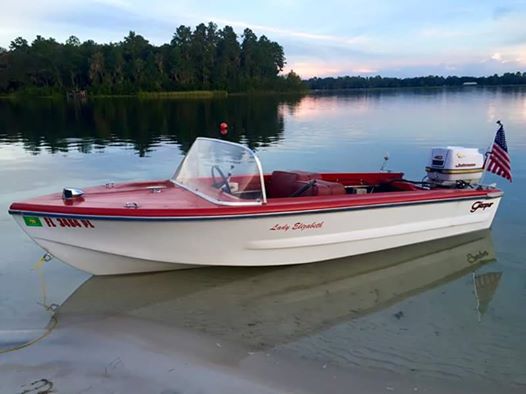

I have no problem with the 1969 Merc 1000 being too heavy on my G3!! Oh by the way, the pic here is at 55.2 mph and had more, but gets a bit squirrely at higher speed!! No pad on my G-3 either. This motor weighs 228 lbs I'm told.
Oh yea, I am a merc head, but I owned the other G-3 shown here from 1960 to 1975 with that gosh-ugly v-4 75 hp 1961 Johnson and this ole Johnson at 75 hp WEIGHED 238 lbs. plus!!! it ran 48 mph with my set-up.
And I agree with Dr. Frankenmerc, the white engines do make great anchors!!!!
Can't help it that my wife has a 1960 Glasspar Tacoma with a 1960 40 hp White thing on it. (She likes to go slow!!!)
Back to the topic---Trim that motor up more, get the bow up and enjoy!!!!
