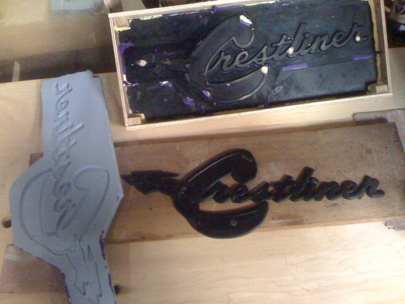

Hey folks. I have been searching for a replacement for the emblem on the port side of my 66' Crestliner Del RIo. Well, today my search finally ended. I made the damn thing myself! I just had to show it off.
One of the guys on the retro crestliner forums gave the suggestion, and it seemed like a good idea. So I made a mold of the one good one I had, and now I can cast as many new ones as I like. I figured if I was looking for one someone else may be as well, So if you would like a set of these replicas just send me a pm.

I have had a couple guy email me, so I thought I would try to get this back up to the top. Unfortunately this is the only progress I have made on my restoration...

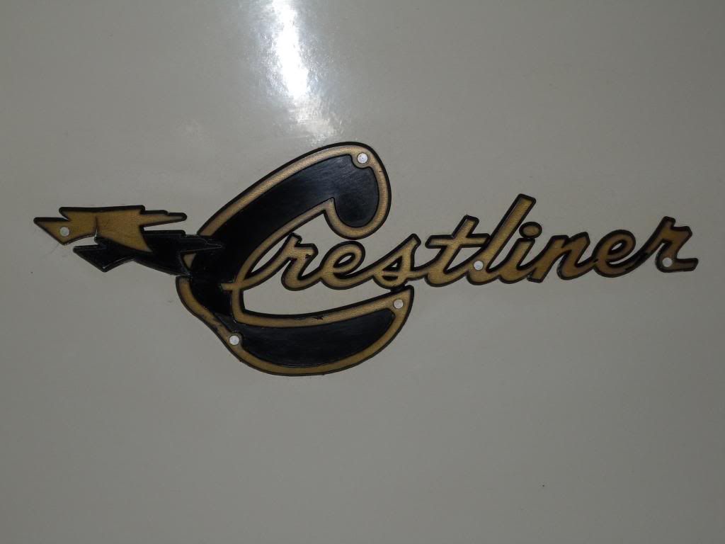

Hey Bob, you say you are developing a paint formula for the gold. Was the original version of the emblem gold or silver? The paint on my original has long flaked off so the emblem I have is just black plastic. Also, was the painting on the raised portions of the emblem or in the lower portions? Given the original date of this thread, I will likely end up doing the moulding and recreation project myself. I also have to recreat a Chrysler plastic emblem for the 65 Chrysler 45 hp I am refurbishing.
Re:Plastic Crestliner Emblem 60's era 12 years 10 months ago #85401
Here is a couple of pics of the Crestliner emblems. It is missing the one piece on it. This is the factory paint job on it. Hope it helps you. As I remember they were kinda pricey at the time when the person was offering them.
Re:Plastic Crestliner Emblem 60's era 12 years 10 months ago #85412
That's fantastic Skip! A great help. Thanks a lot!

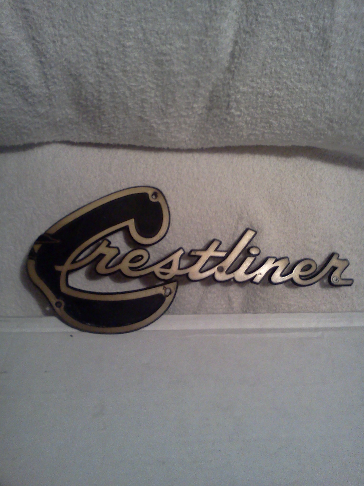

Re:Plastic Crestliner Emblem 60's era 12 years 10 months ago #85434
  • Jim L
  • Jim L's Avatar
  • Posts: 1426
  • Karma: 60

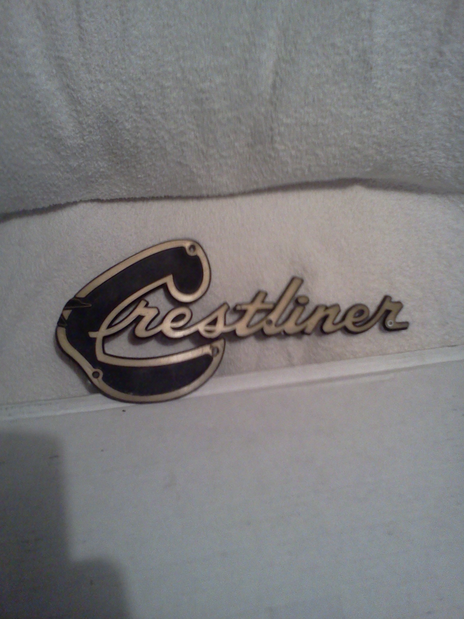

Here's one with the missing piece on it. Paints not as good as Skips though.
Re:Plastic Crestliner Emblem 60's era 12 years 10 months ago #85449
They are hard to find with the end piece on them. Skip.
Re:Plastic Crestliner Emblem 60's era 12 years 10 months ago #85450
  • Jim L
  • Jim L's Avatar
  • Posts: 1426
  • Karma: 60
The gold bird? on the end always looked like it was almost broke in half to me, but the other side is identical. jim
Re:Plastic Crestliner Emblem 60's era 12 years 10 months ago #85451
Jim L, yours is a complete one. I think this is the 2nd or 3rd generation script that they used. Most people liked it better without the bird on it. When I make my new ones I am going to leave the bird off of it. Skip.

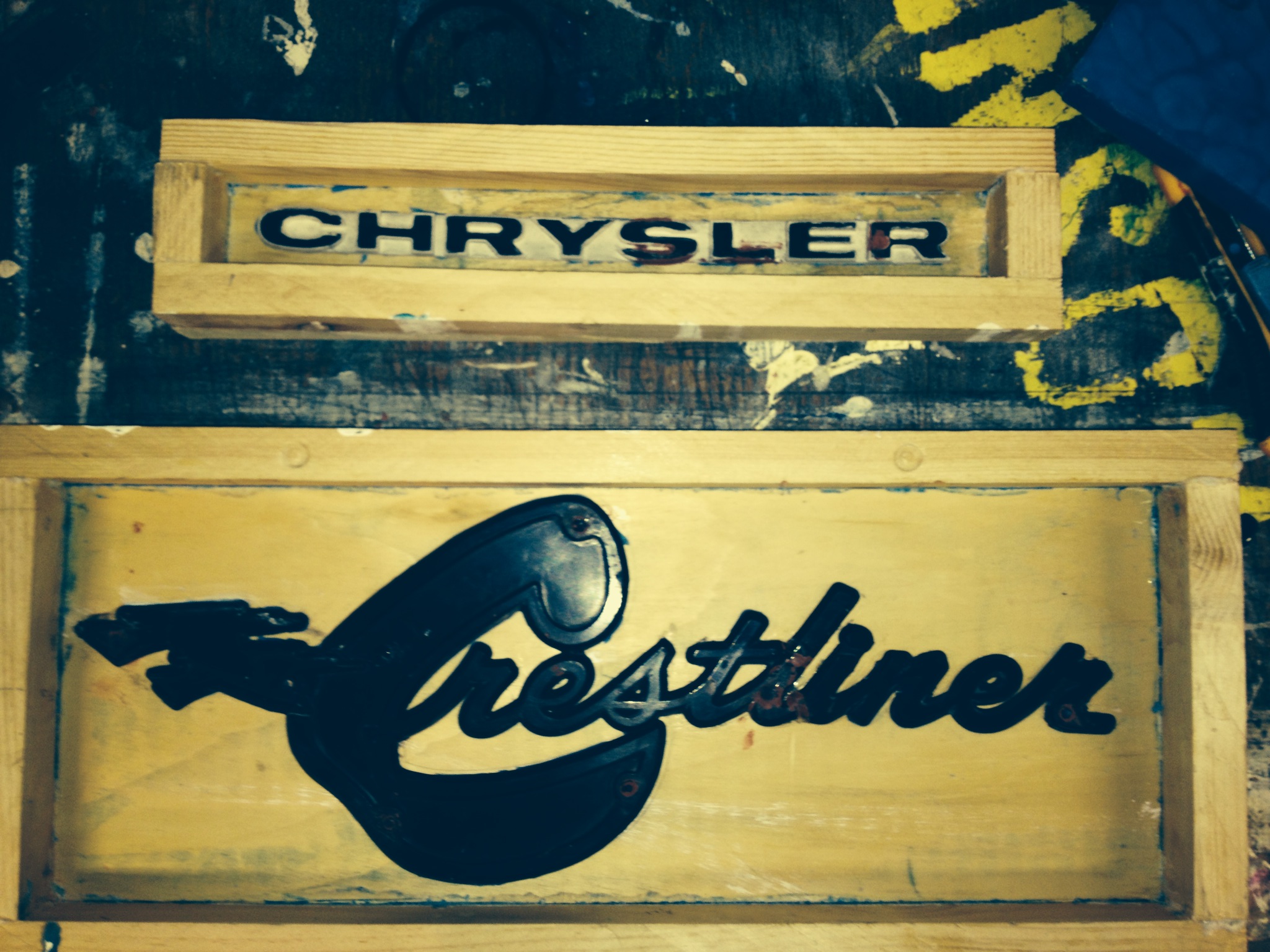

Here is a shot of the original mold boxes I built using the original Chrysler emblem and the original Crstliner emblem (which was in two pieces)
Re:Plastic Crestliner Emblem 60's era 12 years 7 months ago #89209
Here's the shot of the two molds I created to enable the reproduction of the original emblems.

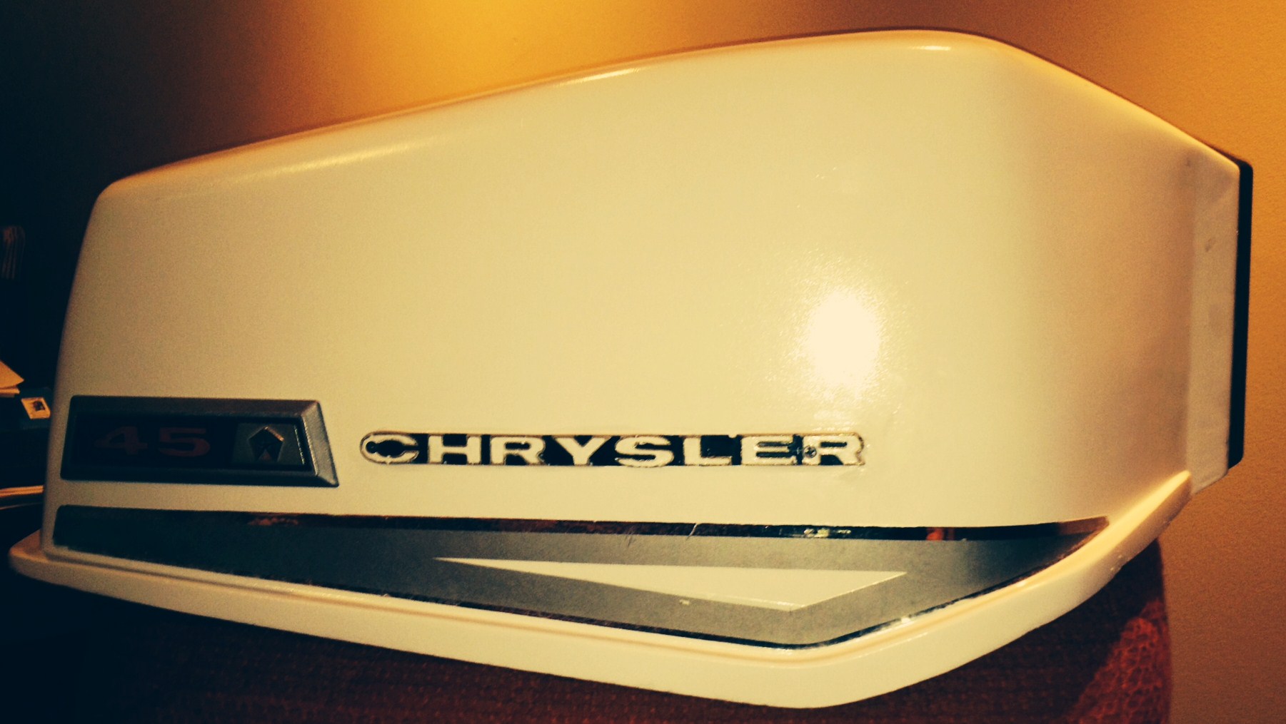

Thanks Jim, JB and Bob! I can't wait to attach them to the boat...but I'll have to given the ton of snow we have here.
I brought the engine cowl for the Chrysler home with me last fall and refinished it. The Chrysler logos were the finishing touch and I attached them yesterday. Here's the pic:
Re:Plastic Crestliner Emblem 60's era 12 years 6 months ago #89504
