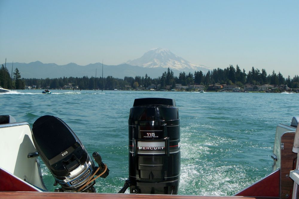

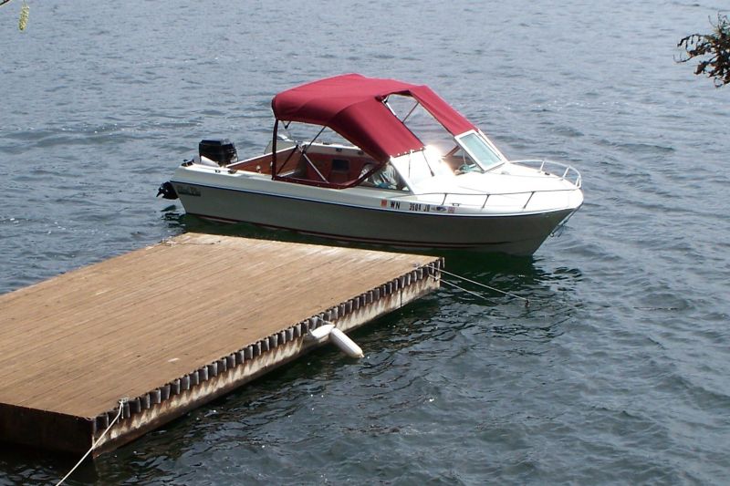

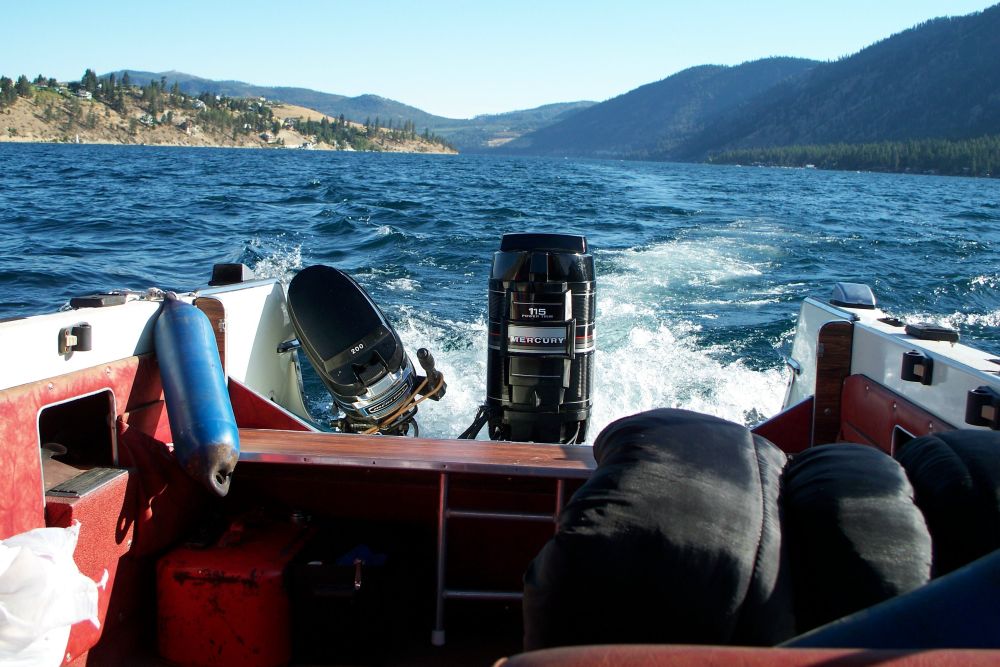

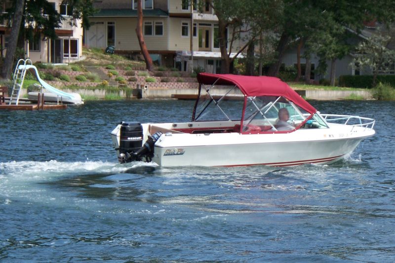

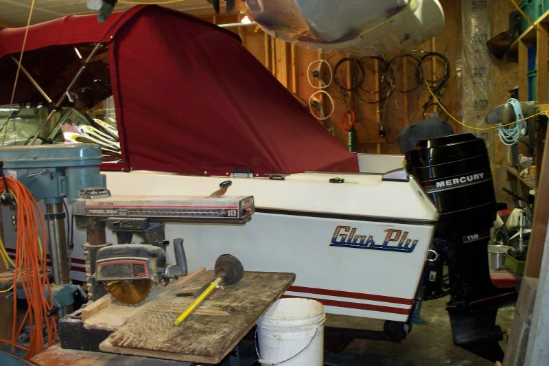

Just my two cents worth,...Stay away from I/O hulls.
If you will be running on big water - stay away from somewhat flat bottom or rounded bottom hulls - momma & sis won't appreciate the rough ride in bumpy water.
There are some great late '70s 19'-21'+ BellBoy, Fiberform, GlasPly, and other similar hulls with room for a head, and other covered areas that are very stable in rough water.
One of the nicest & most comfortable boats we have had for cruising was an '80s 19' GlasPly. It didn't have a cutty for a head, but was otherwise Perfecto-Mondo for us.
If you plan on cruising protected water, you might find something in the 17' variety, but the 19-21' will probably keep momma & sis happier.
doc
Holey Moley,...I REALLY miss that GlasPly. :(
SIGH,...Some grandpas take pictures of their g-babies,...I take pictures of my Merc 'kids'. WCIS??? SIGH
