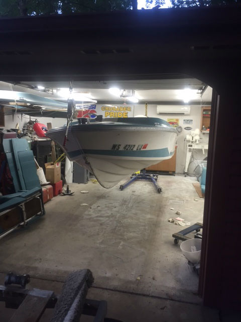

I used the motor lift ring to pick up the back of the boat. No issues at all. I used a heavy eye hook lagged into the header over my garage door (I leave it there for use from time to time) to lift the front of the boat, then the engine lift on the back. This makes it really easy to slide the trailer out. Once the trailer is out, lower the boat onto heavy duty dollies with polystyrene as a cushion and you can push the boat where ever you want.

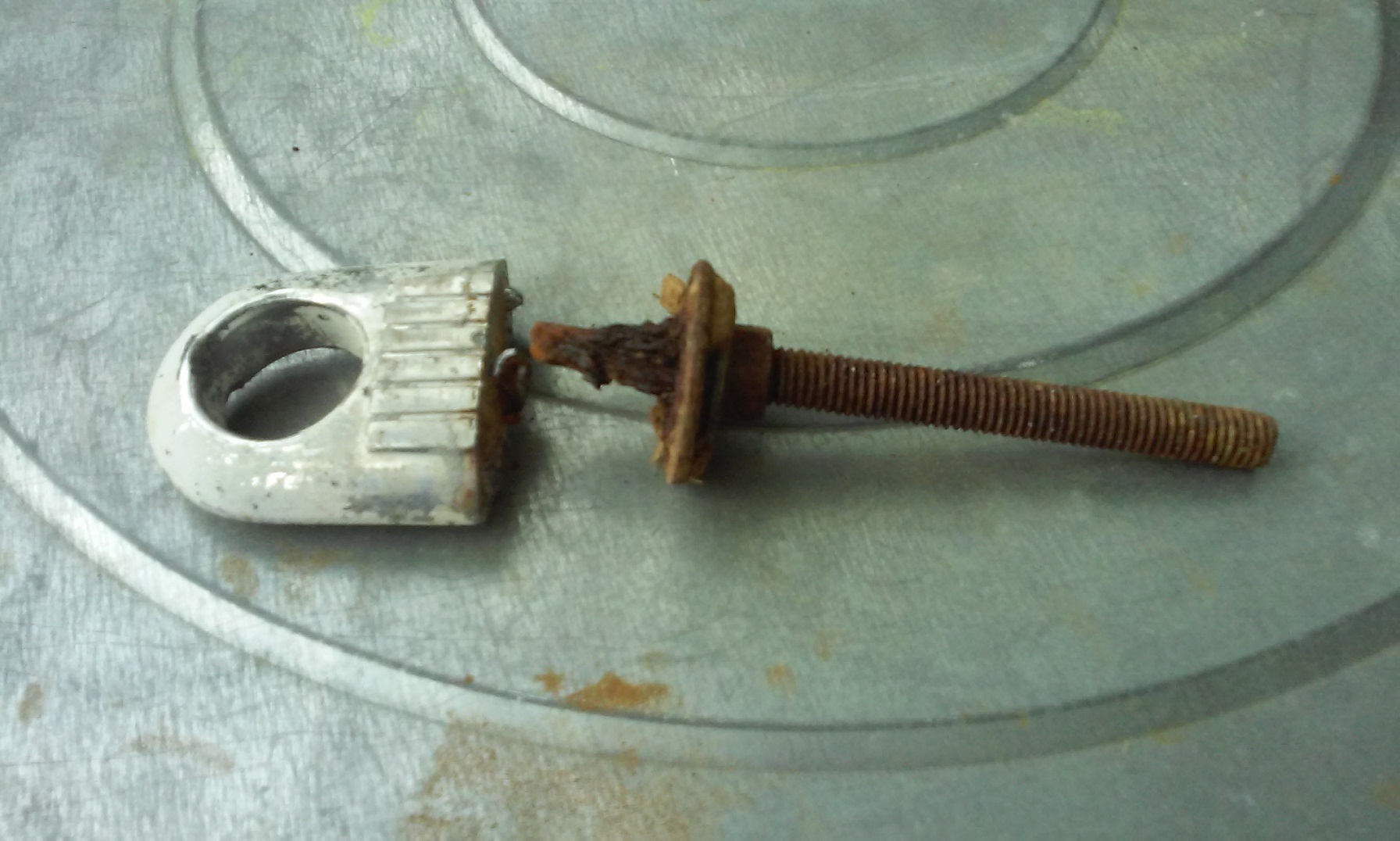

Re:Engine hoist Boat lift 9 years 11 months ago #127118
If you use boat hardware to lift any weight - be sure they don't look like this ( see photo ) on the inside where you can't see it. A lot of tow eyes on boats look like this one and people don't realize it.
Re:Engine hoist Boat lift 9 years 11 months ago #127119
Ditto Bruce, Those eyes are nothing more than steel eye bolts molded into a chrome plated fancy schmancy. I took a torch to one once and the pot metal just melted right off.

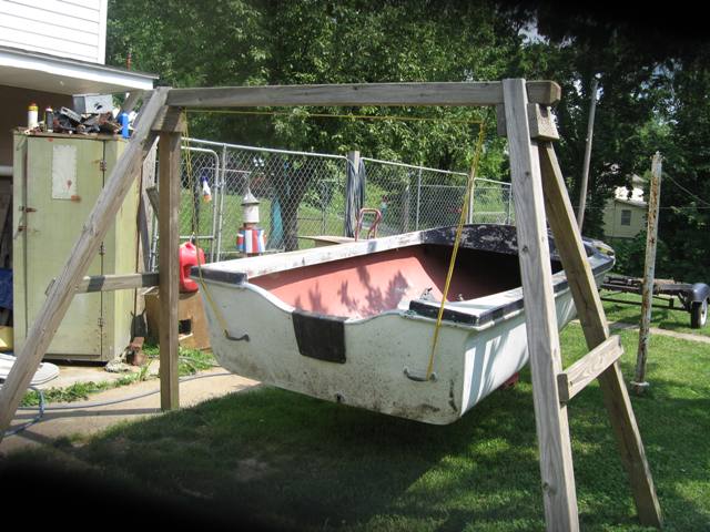

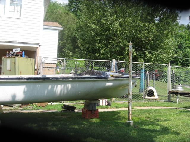

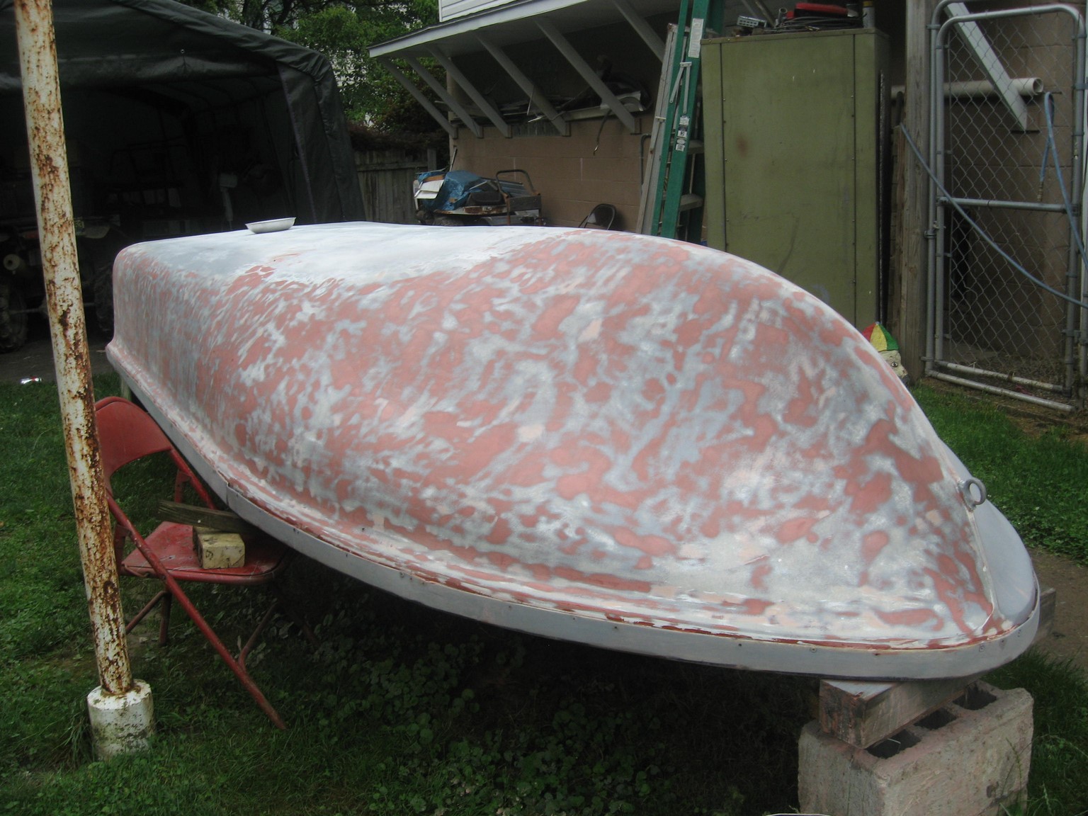

Re:Engine hoist Boat lift 9 years 11 months ago #127130
Make sure you hardware is not compromised. This is a swing frame. I picked it up off in back and drove the trailer out untiol the front was all that was left on it. I put this bunch of stuff under it temporarily. As you can see it was not heavy duty stuff. Boat was flipped after this. I'd take the motor off myself. It's easy with an engine crane.

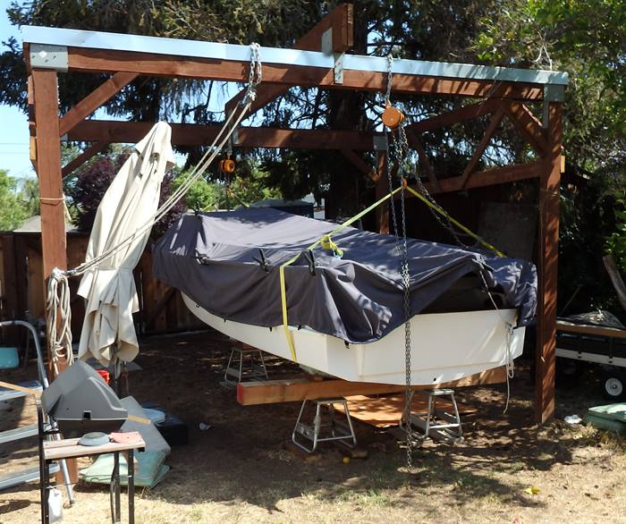

Re:Engine hoist Boat lift 9 years 11 months ago #127187
Great way to do it Jerry but I would strongly suggest an 'evener' on that sling to take the pressure off the gunwales.
Re:Engine hoist Boat lift 9 years 11 months ago #127193
63 saber - smart advice! A spreader is key, especially for long term storage. I was going to mention thatI have seen people put a strap around the engine and lift the aft section by the engine. The transom is obviously strong enough and it spreads the load out so that it isn't concentrated on one point on the hull with the motor pulling down against it.
