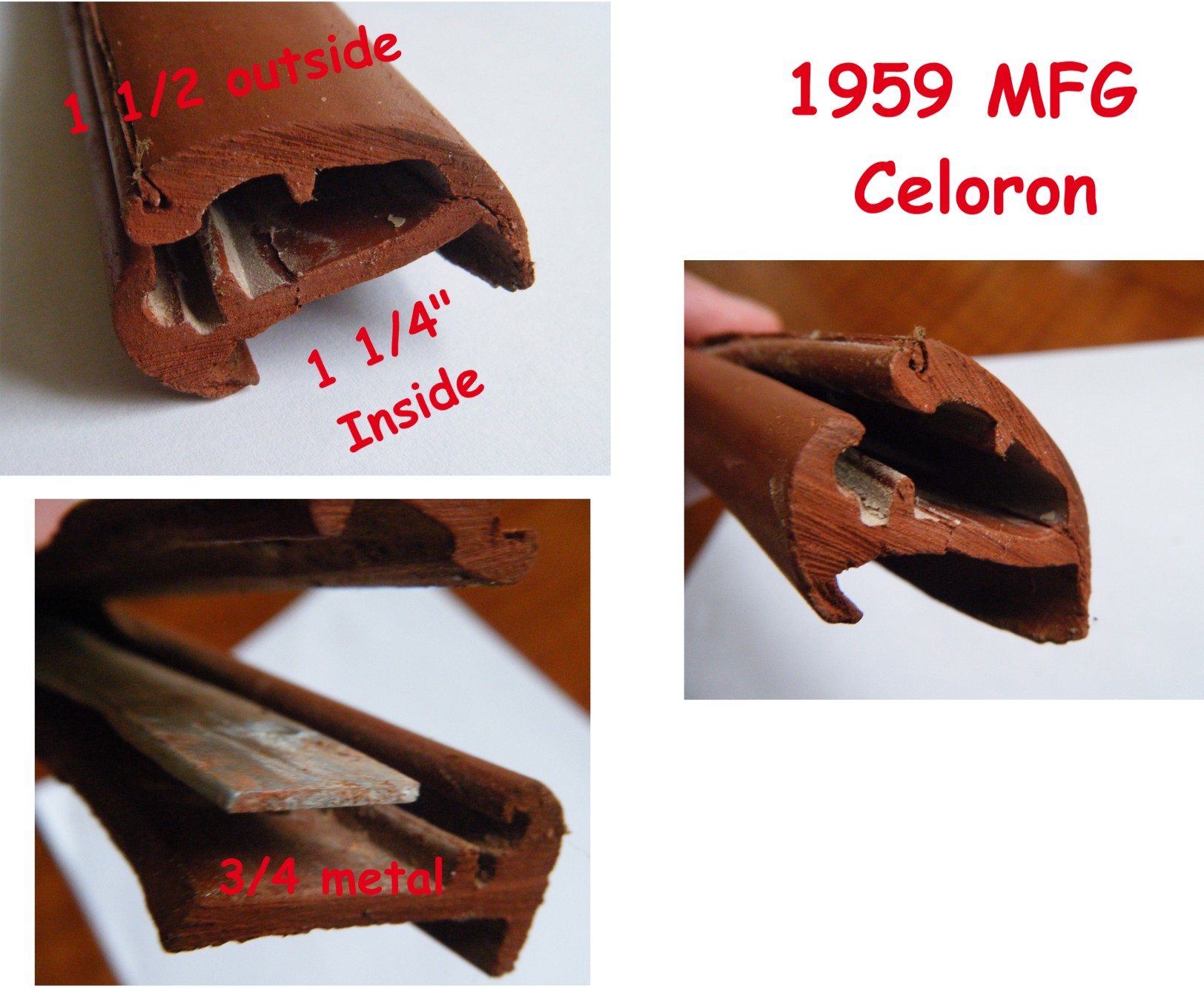

Just found a 1959 MFG Celoron in a barn here in Maine. Rubrail needs to be replaced. It is brick red rubber with a metal insert. Anybody out there know where to find some? I've looked on line and asked around to no avail. Thanks, Paul

The big supplier used here, WEFCO Rubber in Canoga Park, CA only provides, Black, gray or white. If you send them a cut away they can see if they match the mold as they have thousands of dies available. Never seen one with a metal insert.

I had that almost excat rubrail made for at Wefco. Now as Brain said I do not know if they have your color but they have the dye set up and can make you the rubrail. I had to make my own metal insert.

Thanks for the responses. I contacted WEFCO and they can make it but only in black or white. Set up charge fair, but out of my price range.

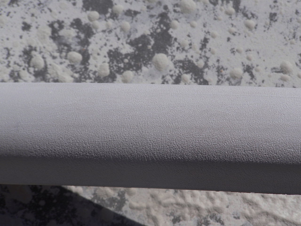

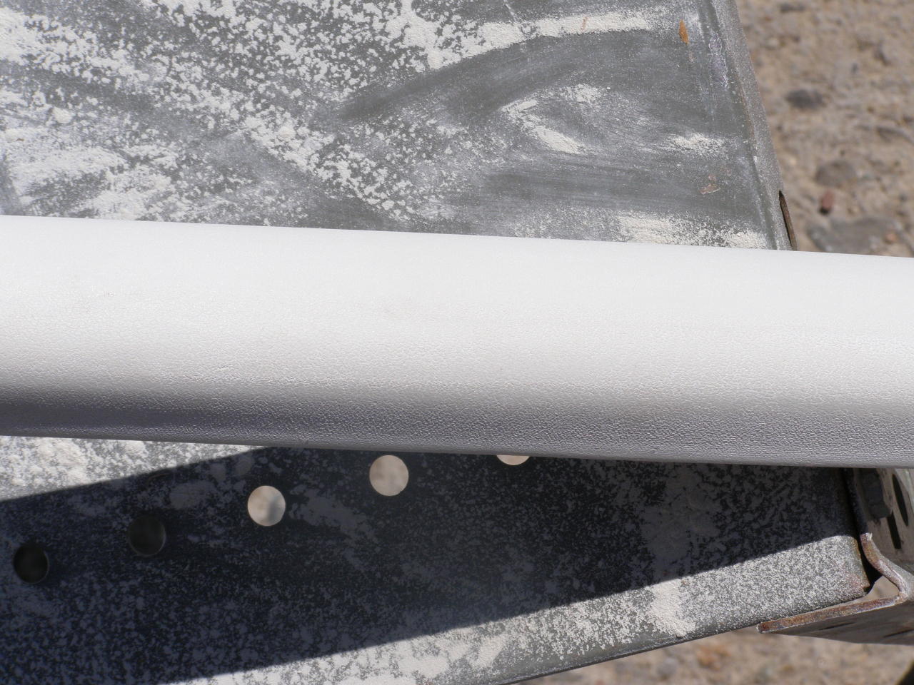

My rib rail was all cracked and drid out but still flexable to a point. I use my sander with some 80 grit and sanded the hell out of it and got all the cracked and dried off it came out almost looking like new. heres a pic of before and after sanding. I know this won't help you but might help somebody else.

Re:Red Rub Rail 15 years 7 months ago #20994
pathfinderz1, on the contrary, that will be useful to me if I'm able to preserve the original. Thanks!
