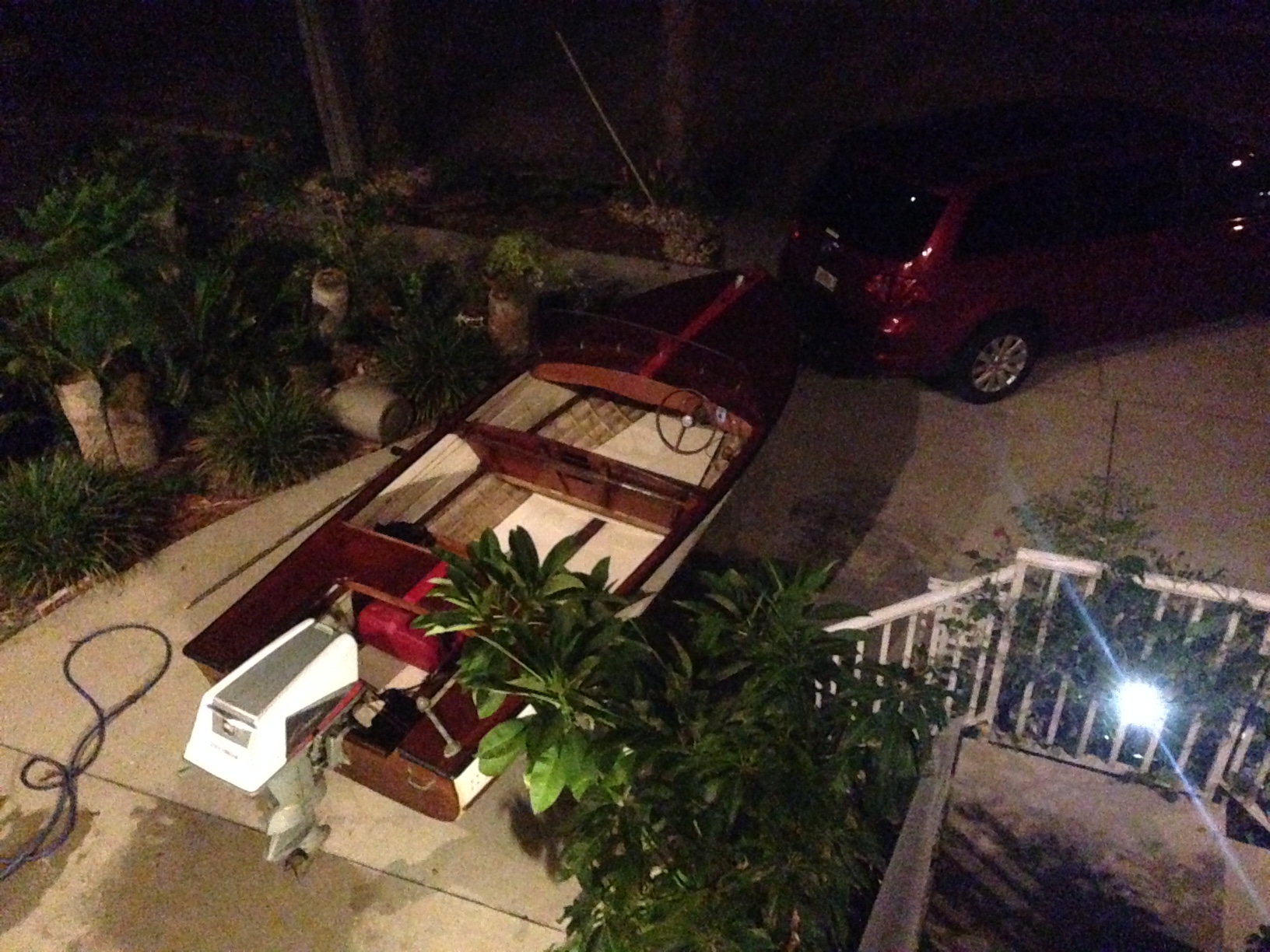

I just purchased my first classic boat and want some opinions/advice about where to start so I don't have a "bad outcome" on my first launch. My wife and I made the decision to take advantage of year round boating and a big garage.
We picked up a 1957 MFG Erie this week. Power is a 1960 Evinrude 40, Lark II. It was last registered in 2003. Seller started it very briefly (without water), perhaps 2 seconds. sounded solid
A key question I have is regarding the wood keel. Do I need to do anything like coat or protect the keel with any urethane or varnish?
*ANY input is greatly appreciated. I plan to pull it back out of the garage and get the engine into a tank so I can start the engine after draining carb and checking the plugs.

Saber- Thanks for the impeller suggestion. The registration is 13 years old but I think, or at least suspect, is has been in the water from time to time as there was a fairly current picture of the seller in the boat, in the water. Seller said his wife thought it would be a good idea to prove it actually floats. Probably still a good idea to change the impeller. I'm a bit of a chicken lifting a finger on the hull and engine since this is my first go at the vintage boat thing. Ironically I was a fighter mechanic in the USAF, and have flipped bikes so the mechanical piece shouldn't feel intimidating, but it does. I have a SELOC manual so I should be good to go. I just hate cracking open something that runs.
This weekend I'll be putting it in a trashcan/tank to crank it. I did read that this unit has a thermostat that needs to heat up first, and then water should come out the top exhaust. After I see the t-stat opening proof, I'll feel comfortable taking it to the boat ramp.
This boat fortunately is a fiberglass hull so I won't have the issue of getting through a soak period. Thanks for pointing that out though. I'll keep that in mind in case any true wood boats come home with me. From the research area of this site I learned that MFG company originally cast the hull from a prospective client's wood boat. The business deal never went through... It does give that interesting plank effect, with the practicality of glass.

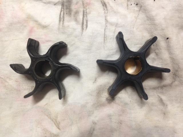

Thx to everyone with the strong opinion on the impeller change. I got one today at a local boat guy, and changed it tonight. Of course always a little pucker factor doing anything new like this, and double so when the new is on a 50+ yr old engine. eg; how hard should it be to pull off from the water lines... I'm also changing the lower end oil for good measure. Impeller wasn't horrible, but definitely had wear. I think I'll be needing to change the electric start solenoid in the start box. it gave me a click, rather than the starter action. I cleaned terminals, and it appears to work now, but like the impeller situation, its a cheap and easy change out $13 shipped for a fresh solenoid.
