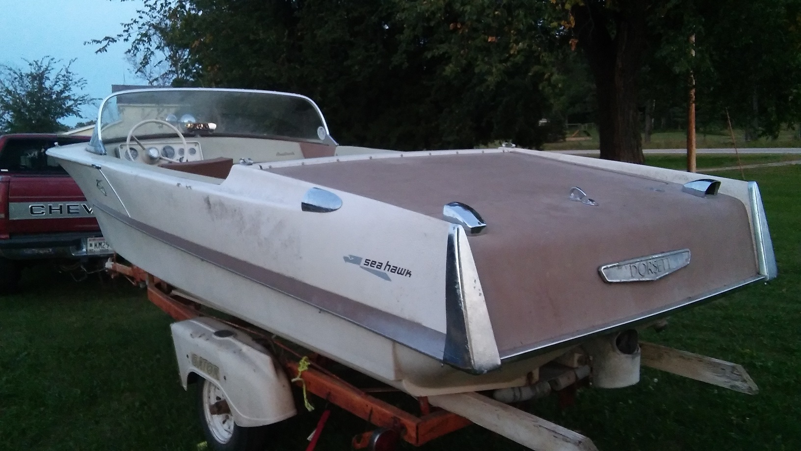

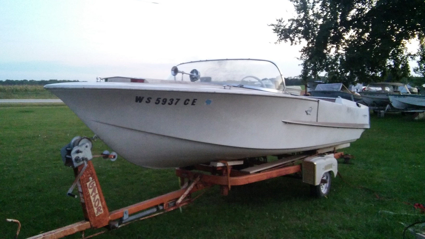

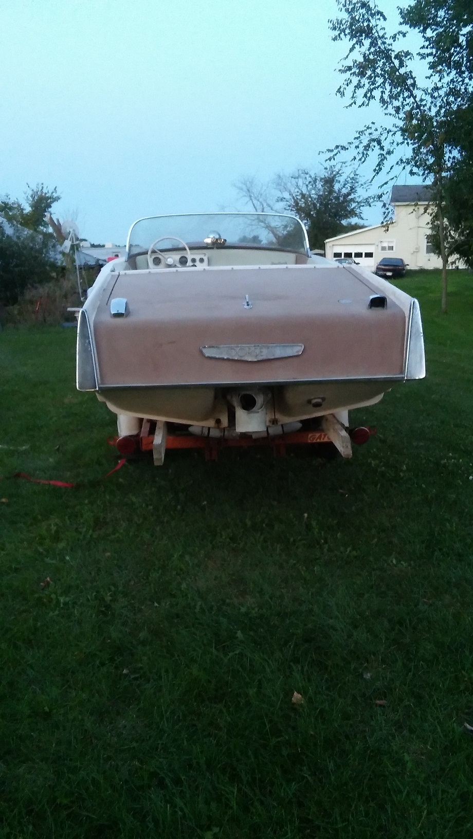

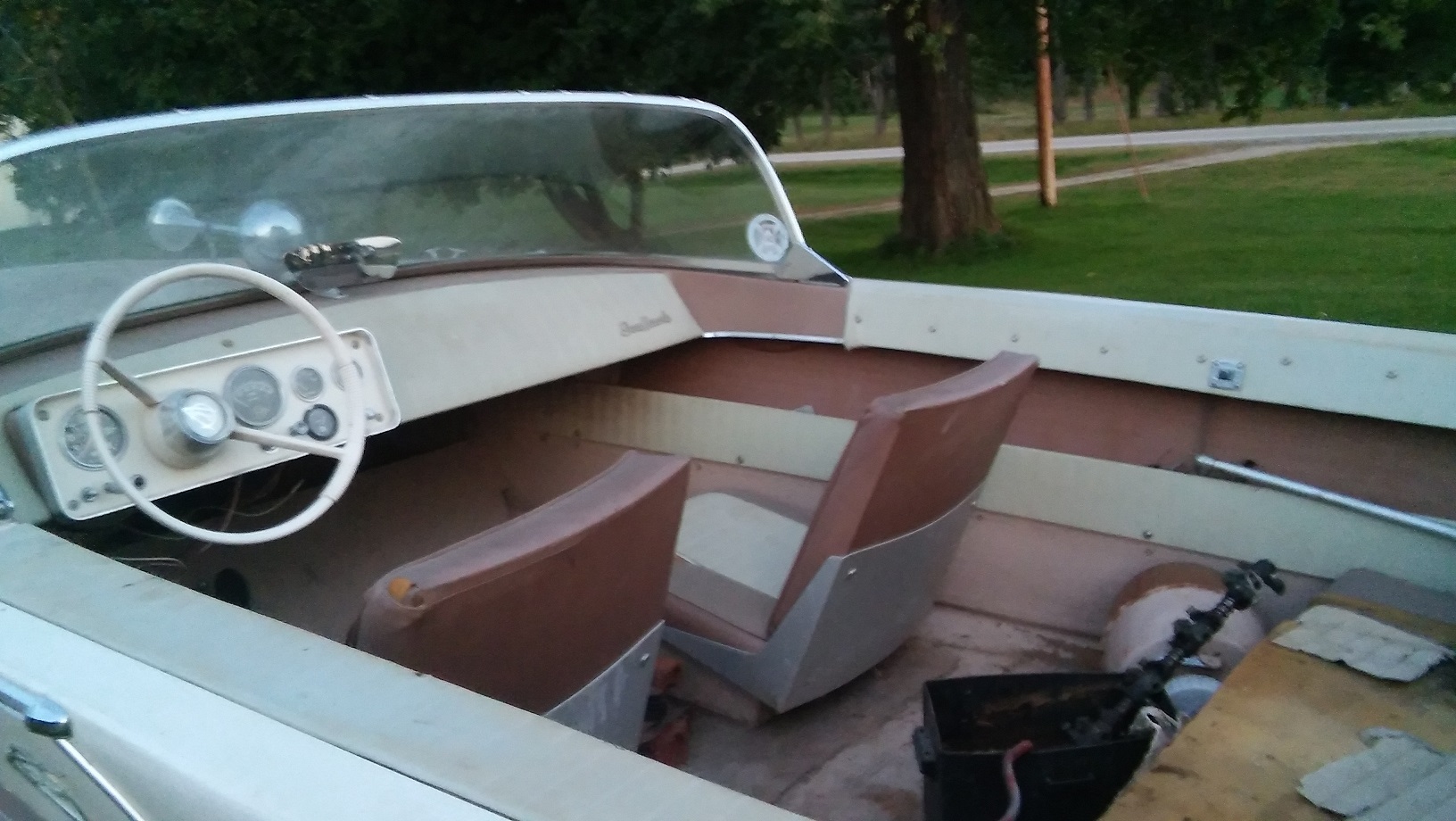

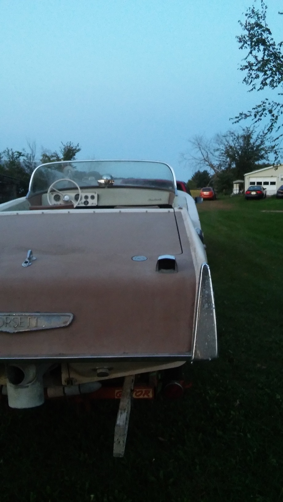

1961 Dorsett Seahawk I drug home on sunday...

joe, nice boat, and a super gator trailer to boot, nice find. greg

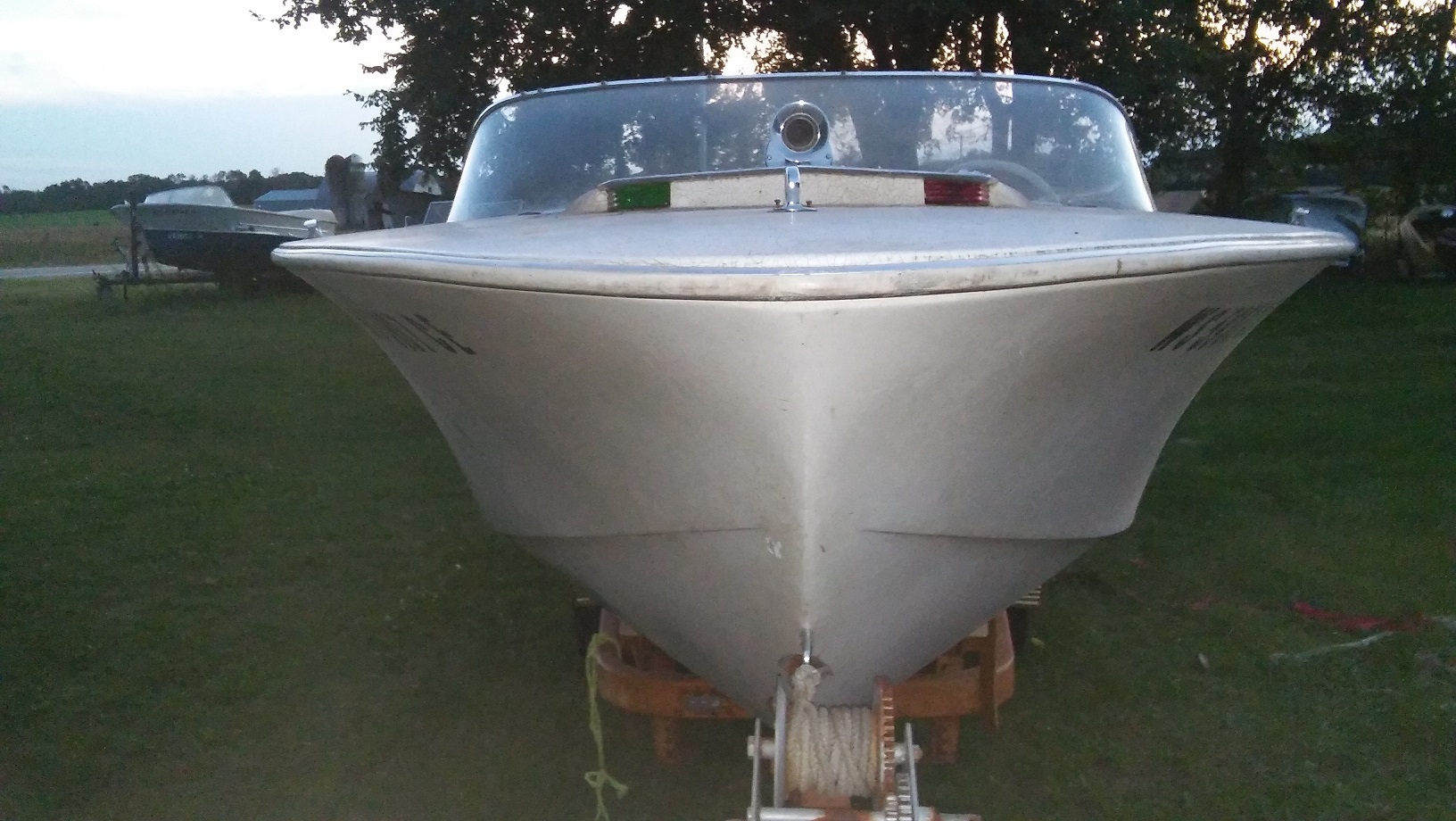

That thing looks nice ! But looks like it needs tail lights ?
AND it has Marty Feldman Vents ?

That boat is way to kool for skool. Is the sole sound? Does the Gel coat have a lot of spider cracks or other degradation? Just curious because that boat is so rare it really needs to be completely restored and treated like a museum piece. The total package is oh so nice. Thanks for sharing

gelcoat is crazed head to toe.. so it will need a complete tear down.. but I'm going to try to avoid splitting it if I can... hang it by the davits hooks and do the bottom first, media blast then gelcoat the bottom, then do the top......

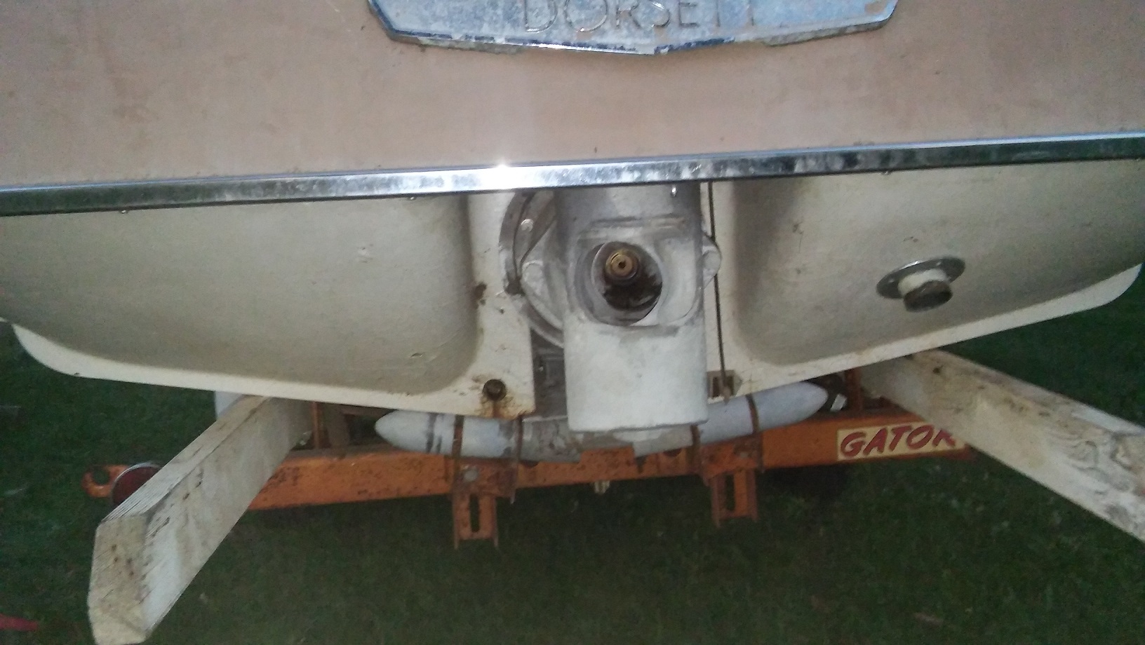

Nice!!! you're convincing me to play with the idea of that engine. This one already was hooked to a jet drive settup along the way..
Re:Ooops I did it again!!!! 9 years 7 months ago #126878
Perfect if it already has an adapter. Most all parts are the same as the Buick V6 and then the Rover versions. You could easily source a Rover fuel injection setup, if so inclined...

Great find with such a cool design on the transom. Dorset was ahead of their time. It needs a V8 as the six cylinder was not too performance oriented. Excited for you and your way cool find!
