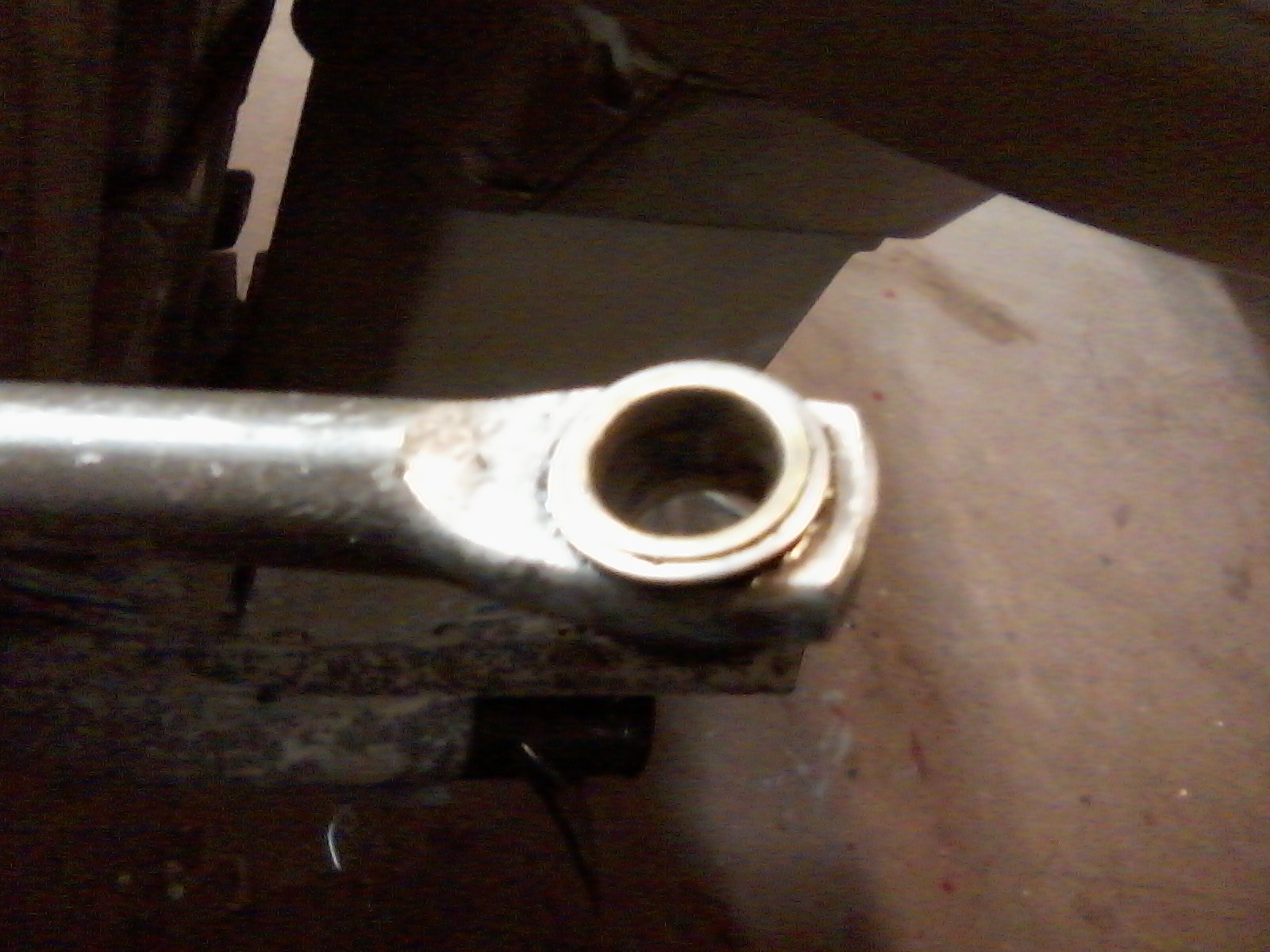

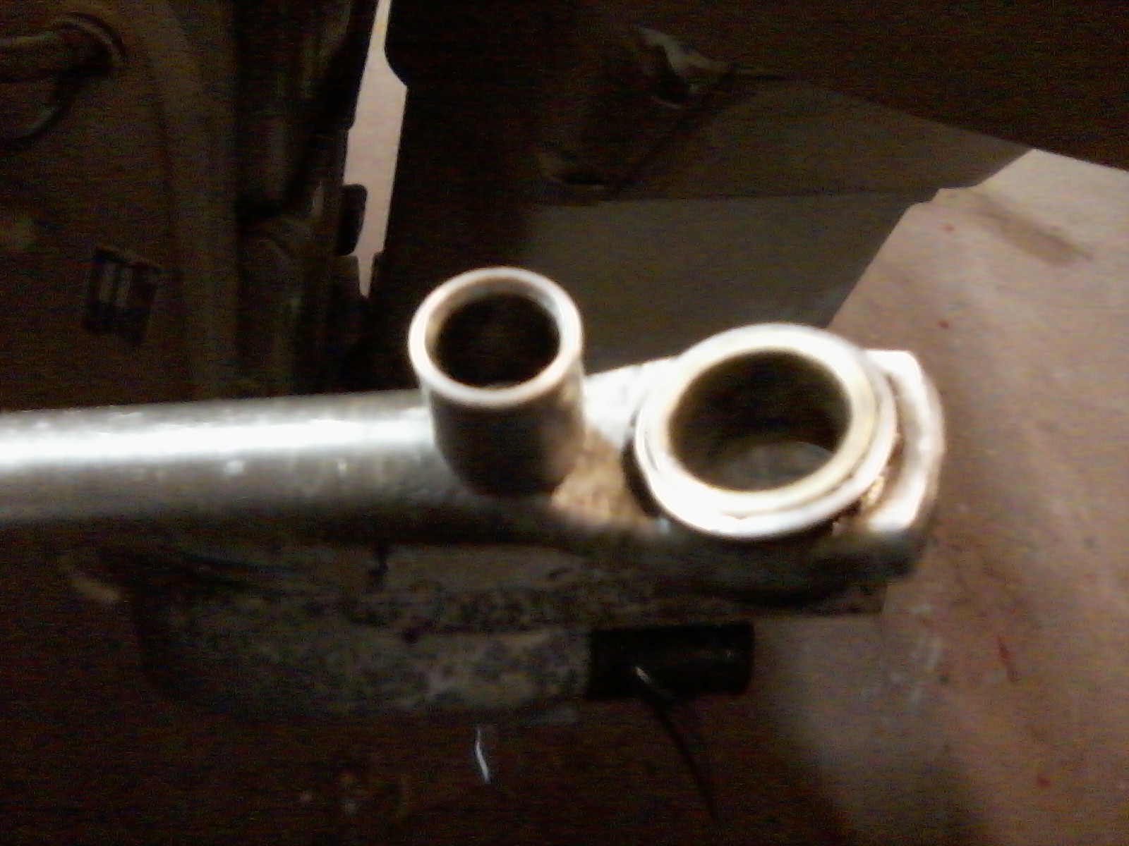

I was moving the motor trying to check the rubber mounts, all seemed tight but I noticed some slack in the steering knuckle(s), I thought it was just loose. I removed the connection by the motor and it seems the brass bushing, ss sleeve and bolt are sorta egged out, almost enough to cause any motor vibration to amplify and pop back and forth to the steering system. I could really feel the vibration in the steering wheel. Hope it's as easy fix as this.

Whoops! This got by me too! YES! Replace!
"I was moving the motor trying to check the rubber mounts, all seemed tight but I noticed some slack in the steering knuckle(s), I thought it was just loose. I removed the connection by the motor and it seems the brass bushing, ss sleeve and bolt are sorta egged out, almost enough to cause any motor vibration to amplify and pop back and forth to the steering system. I could really feel the vibration in the steering wheel. Hope it's as easy fix as this."
Re:Shaking and vibrating underway 9 years 11 months ago #126805

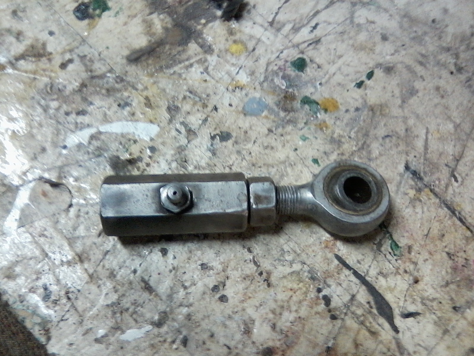

For now I just put in a brass shim. If that works I will plan on replacing the entire motor end this winter. I do not believe this is the proper fitting for a trim/tilt motor because there is no swivel on the motor end and any trim or lifting on the motor is putting stress on the bushing.
I do have a swivel end replacement that would be proper but I will have to shorten the motor connecting shaft and thread the end.
