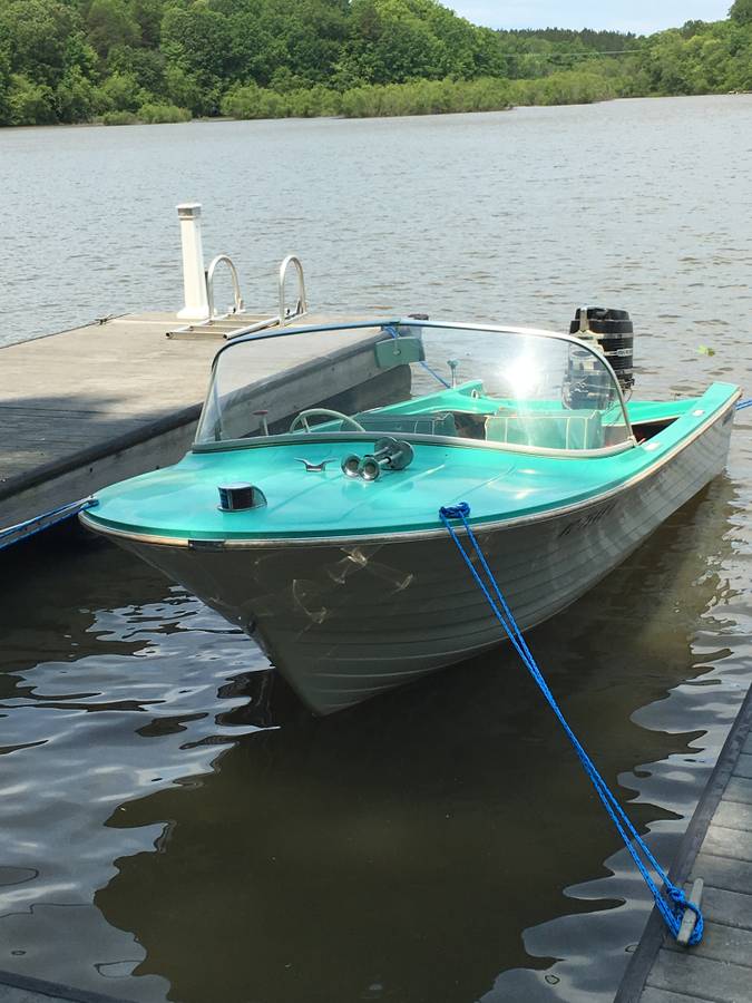

Just bought the '64 Starcraft pictured below - 16'-65 HP Mercury outboard, one owner boat. In beautiful shape, always kept indoors. The previous owner had everything checked and tuned prior to my taking posession. Question is, the motor could use a new prop. The old prop is a 2 blade. I called a prop website and asked for help but got none. The boat will be used as a cruiser, not to ski behind. Looking for an aluminum 3 blade that is a good all around run-a-bout prop. Any help would be appreciated.

I don't know about the props, but congrats on getting a beautiful boat!
