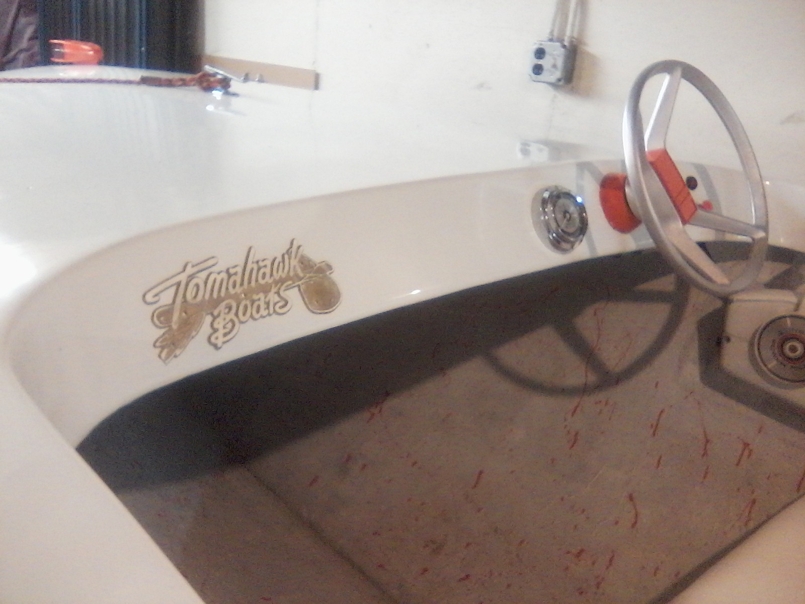

I've done both and I lean more to the roll and tip. Spraying if you are really good at gives a good finish but can get pretty pricey and messy depending on what kind of paint you use.
Your method of roll and tip seems a bit excessive. I've found that you can get a very high gloss finish using Rustoleum gloss thinned and then an off the shelf hardener (additive)usually 2 coats. Let it dry for 24 hours and use a 600 grit wet/dry with a soft backer block. This will take down any streaks then maybe some 1500 lightly afterwards. Finish this with a buffer and polish, I use Mcquires(sp)and keep it wet with a water spray bottle while using a foam pad on the buffer. I've had people swear the finish was sprayed and couldn't believe it was brushed.
