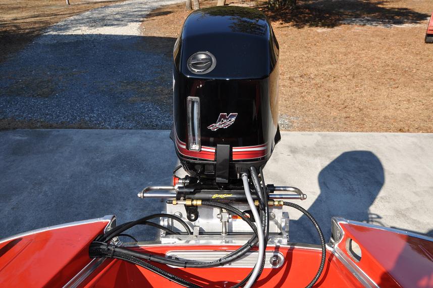

Like you, our 1960 G-3 originally had the old "cable and pulley" system and after my Dad passed away and left the boat to me, I decided to upgrade not only the engine but also the steering system.
I went to a "Baystar" Hydraulic System on the G-3 and could not be happier with it! :) I found mine online and installed it with the help of a friend who runs a boat dealership. They are more expensive than a straight cable system, but to me the benefits of the hydraulic steering is much better. To me it is like having power steering although like you we have a Merc 50 Outboard on our G-3 too. On our 1960 Glasspar Seafair Sedan, I bought and installed the "Uflex" Hydraulic Steering System. The outboard motor on the Seafair is a Merc 90, much heavier than the Merc 50 and again, the "Uflex" System works great.
I would look around online and see if you can find a deal. This may not be something you want but I wanted to let you know we really love the two systems on our boats.
Below is a photo of the "Baystar" System on the G-3:
