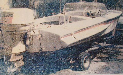

Raced this ole 75 hp 1960 Johnson wide open racing and skiing for 15 years and it ran on whatever I poured in it, all the same. This ole motor was a tuff one. I replaced 1 water pump impeller, one rotor button and one fuel pump in 15 years and this motor ran probably 4-5 days a week as I lived on a lake and ran it many, many miles!!
