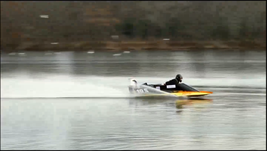

Pictured here is our performance model mounted on a pickle-fork racing hydroplane. It reached a top speed of 40.8mph

I'd like to see more pics of that Performance model, info on batteries used, running time before charge fades, total weight of motor and battery(ies?) lower unit used.

The performance model had a larger battery pack (4kWh), and could run at 40 mph, also for about 20 minutes. While the outboard was more efficient than the previous model, the setup was not ideal, as you can see in the picture the hydro has too much of a wetted surface. So there is a lot of room for improvement there!

I don't have additional pics with me at the moment but I can certainly dig some up for you! Total weight of outboard 60 pounds, peak power production of 30 HP, champion hotrod lower unit, batteries were Enerdel Lithium-ion batteries and weighed about 100 pounds. It would run for about 20 minutes at moderate speeds before we saw any power fading.
