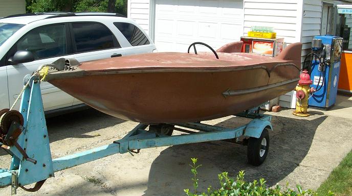

Hello, I have a 1957 Duofoil Flyingfish. I have had it for about 10 years and now that I am retired ... It's time to redo it. A friend gave me a trailer recently,so it got me motivated. It is just a shell with only the back aluminum fin covers and the front nose piece. I plan on putting all original parts back on it and park it on a 1957 Tee Nee Trailer. ( the tee nee plant was up the street from me!) I will learn to navigate around this site and look forward to any knowledge you guys can share with me. I was a carpenter for my working life, so I have some mechanical skills .. but not a lot. :) Thanks, Mark ....... P.S. Parts I am looking for: Windshield and brackets, 4 cleats, 2 step pads, all around light and pole, steering wheel and assmby, skid cleat on back bottom. So you see, I have a long way to go! Would not be opposed to buying a whole boat for parts.

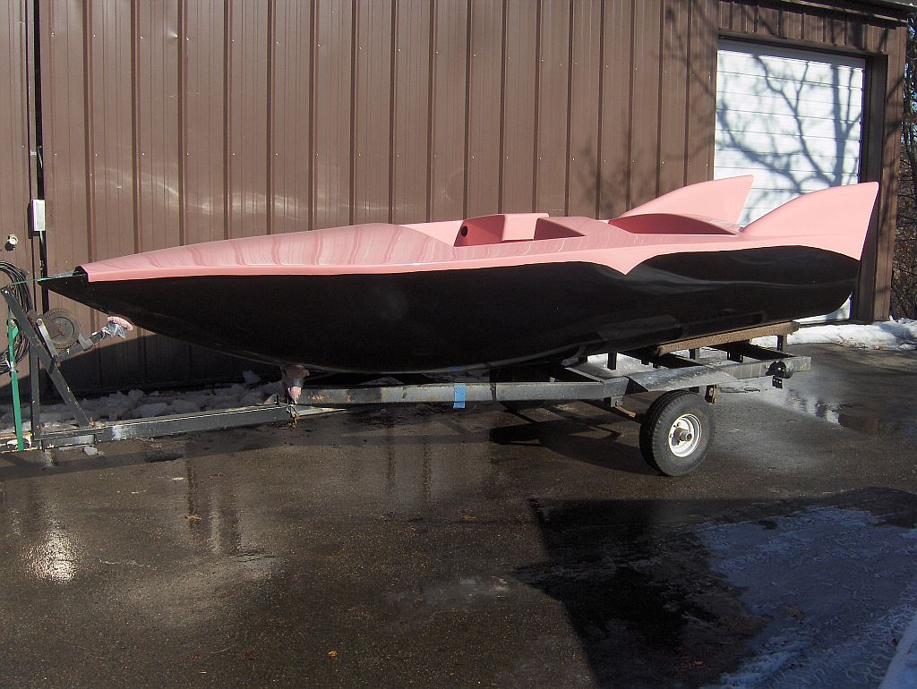

I have posted a scan of a 57 catalog page and a some photos of my 57 that I am just finishing up.
Don
Re:1957 Herters Duofoil Flying Fish 10 years 1 month ago #124336
Wow, those are some serious fins. Very nice!!!

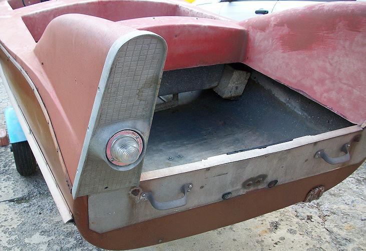

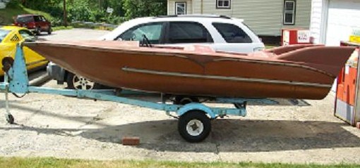

Re:1957 Herters Duofoil Flying Fish 10 years 4 weeks ago #124377
Hi Don, I took plenty of pics to share ... but the site said "too big" and wouldn't load. I will try to figure that out. I bought a '57 catalog, some ads and other Herters odds and ends in the past few years. I have been trolling eBay for awhile for actual boat parts with no luck. I do have a title for this baby! Also have the braces for the front, back seats and nose, and short aluminum transom that is straight with no cracks ...so I'm ahead there. Also my steering wheel assembly is on the left, so I'm wondering what the advantages are to each side. Looking forward to feedback when I get photo's up, Thanks, Mark

Re:1957 Herters Duofoil Flying Fish 10 years 4 weeks ago #124384
Mark,
Sounds like you have the most of the critical parts.

This a list of 57 Flying Fish castings that are crucial.
Bow piece
Tailfins (2)
Transom (could replaced with wood)
Transverse floor members (2)
Longitudinal floor members (2)
Transverse floor member clamp
Extruded keel strip
Bottom transom pads (2) They really aren't needed. Could just fill holes
These parts could be replaced by fabrication fairly easily.
Tube support pads (4)
Dash supports (2)
Seat bottom supports
There is some exterior trim. Hopefully you have it. It's basically impossible to replicate and the boat would't look right without it.

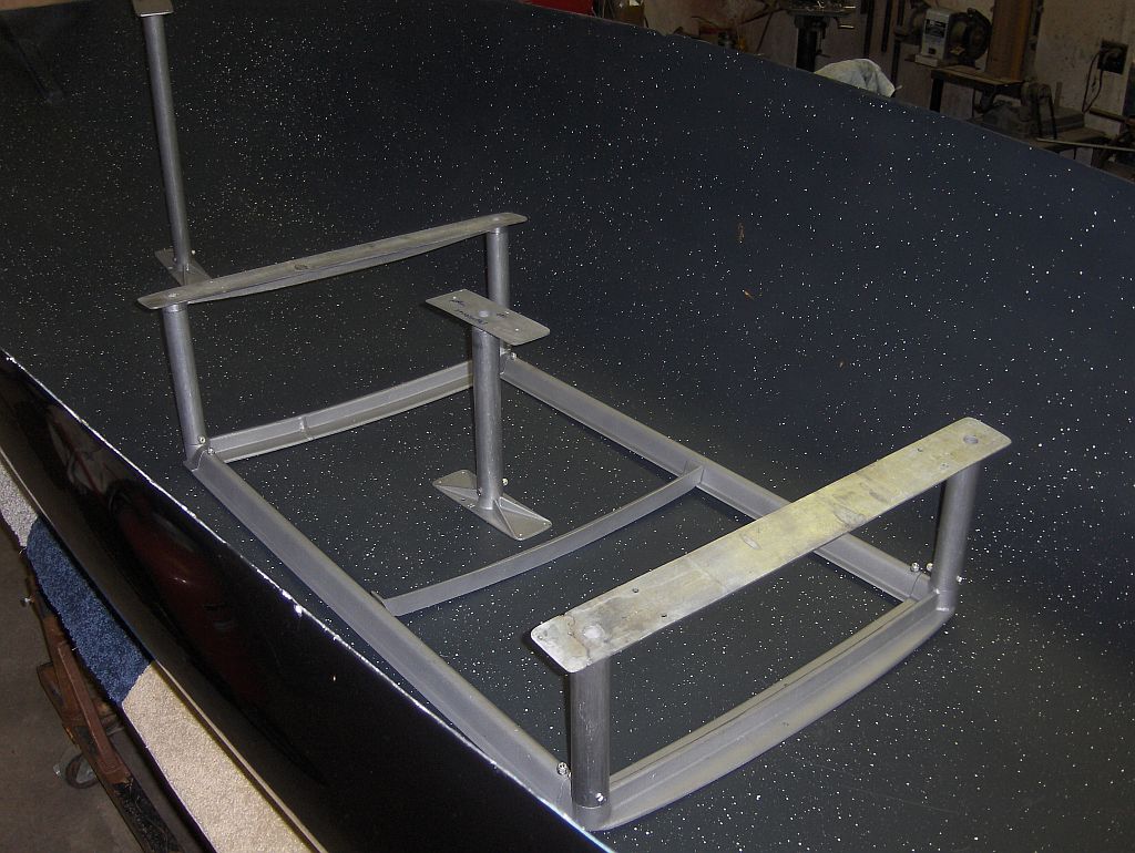

I attached a pic of my floor frame and front deck support as I was mocking it up for size.
Don

Re:1957 Herters Duofoil Flying Fish 10 years 4 weeks ago #124391
Mark,
You are in pretty good shape. It looks like you even have the EPO foam next to the seats. There should be more stuffed in the fins and a big block bolted to the bottom of the front deck.
The missing skid pad may be hard to find, but the right side can be used as a pattern for the missing if you have to recast it.
Your transom does look good from the pic.

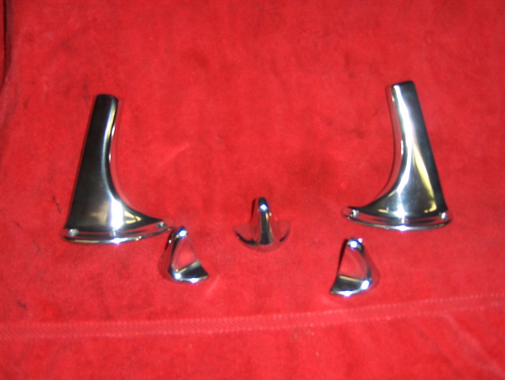

If you want to have a Herters windshield you will need to find posts and braces. The original cleats were aluminum, but there are many currently produced chrome cleats that look similar. The windshield is just a 1/4 inch piece of plexiglass that has one simple bend.
When your ready to begin the project, start a new thread in Member's Projects and I will post some of my pics that might be helpful to you.
I've attached a pic of my windshield posts and brackets I had cast off off a friends parts. It's a lot of work to polish them.
Don
