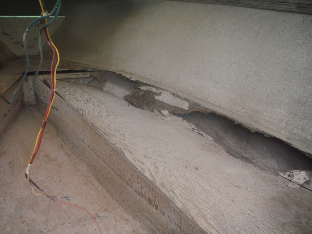

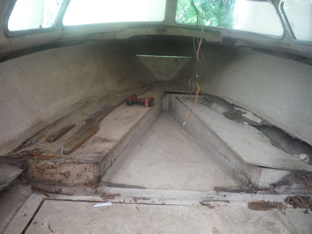

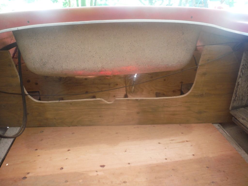

I have posted a few pictures - as you can see i have taken out the old transom wood and have two layers ready to be glued and screwed together in there. I cut out the old rotted floor and will 'scab' on some extra wood on the stringers.
Today i removed the bulkhead into the cabin and laid out - i have a friend who is an excellent woodworker who will recreate this section.
My question mainly is for the cabin storage units and the side 'shelfs' in the back - I was planning on grinding/cutting out the fiberglass which connects the wood to the hull - then replacing the wood and re-fiber glassing it back in place - does this sound ok to you? Was going to do the same thing on the side 'shelfs' in the back. I would really appreciate any comments, advice, suggestions

To post multiple photos, go back into your completed post with the "edit" tab and add another photo, repeat, etc.
What kind of plywood are you using? It looks like standard A/C plywood sheathing. I recommend you use high quality 3/4" 9-ply meranti marine plywood. (Call Al Jernigan at World Panel Products, 252-794-9944)
www.worldpanel.com/#!marine-plywoods/c1hvp )
Totally cover one side with 3M 5200 using a 1/8" grooved trowel and then sandwich together with copious stainless screws. Treat the finished assemblies with two coats of CPES, heavy on the edges. I always coat the bottom edges with 5200 as well...good insurance.
