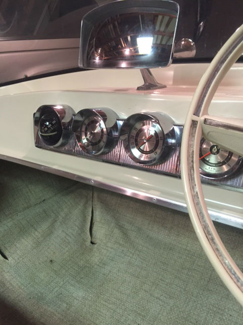

Any ideas how to tighten up the mirror on my Sea King? It is annoying as it drops down when were are under way, but much more annoying is my wife constantly wanting to readjust it. Help!

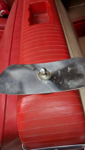

This is not your mirror, but the concept may be the same ?

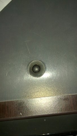

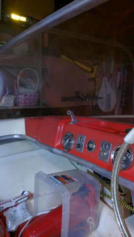

I will just add in case anyone is having a similar problem. I have a mirror that is loose too. But, it fits in a rubber grommet/fitting into the base and it is a ball joint.
I was trying to figure out how to tighten it up and one of the solutions I tried seem to work, although who knows how long for.
I took liquid electrical tape and dropped it in the hole with toothpicks and let it role around. I then let it dry overnight before I put the mirror back into it.
I was one choppy water today and it seems to have held really well. I never had to adjust the mirror once. So, it may not work long term, but it was an easy fix and it is easy enough to redo.
I'm attaching some photos of my connector type in case someone else comes upon this thread.

Well, that was interesting.
I went to get a heat gun, and no one in the store could find one. I needed a new clicker for my propane torch, so I just bought that instead. Then I got it home, and it doesn't work.
I was up until after 1am working on the boat as we are taking it up north for a long weekend, and when I finally came in to bed, my wife says, just make sure that darned mirror is fixed.
So, I used the gas stove top and heated it up while holding it with my welding gloves. The mirror came out easily. The plate that clamps down on the ball was loose, so I mushroomed the rivets over and it got quite a bit better, but not enough to be happy. So I took out my punch and tapped a few places that I figured would snug it up...wrong. Totally opposite effect. Extremely loose.
Huh.
So, after staring at it for a while, I got a strip of 500 grit sand paper and snuck it in between the ball and the plate. I had to pop one end of the plate off to do this, and then replace it and mushroom the rivet back down. Perfect. Hope it lasts...
