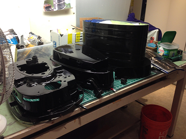

Thanks for the input guys, should have said that I was blowing this with a gun. Finally talked with a pro, the duration is no more than 24 hours. You can paint as soon as 3 hours if dry, more if needed but not more than 24 hours.
So two coats later, they look pretty good.
