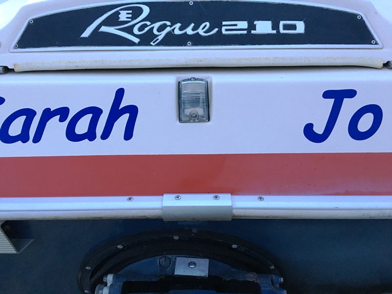

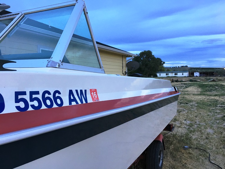

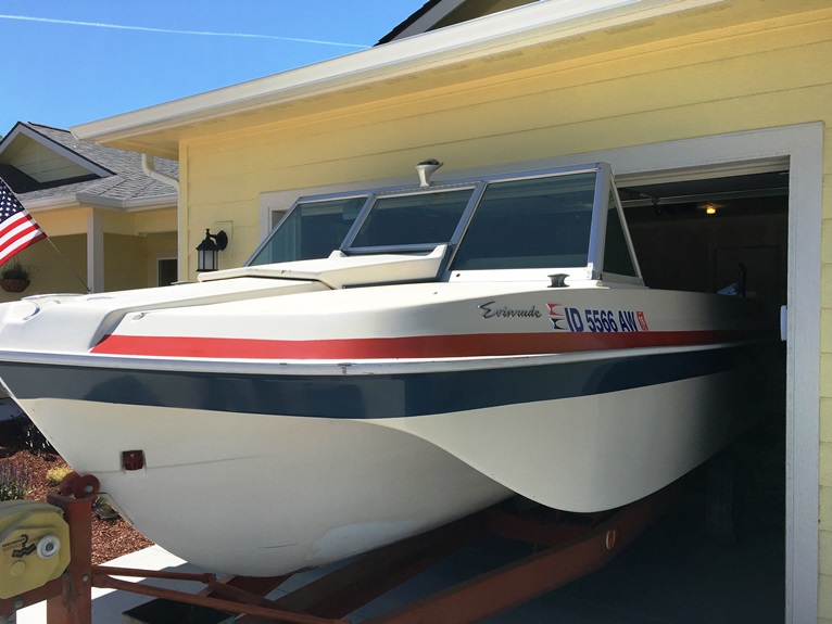

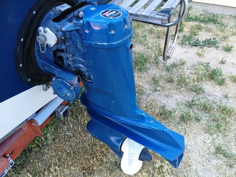

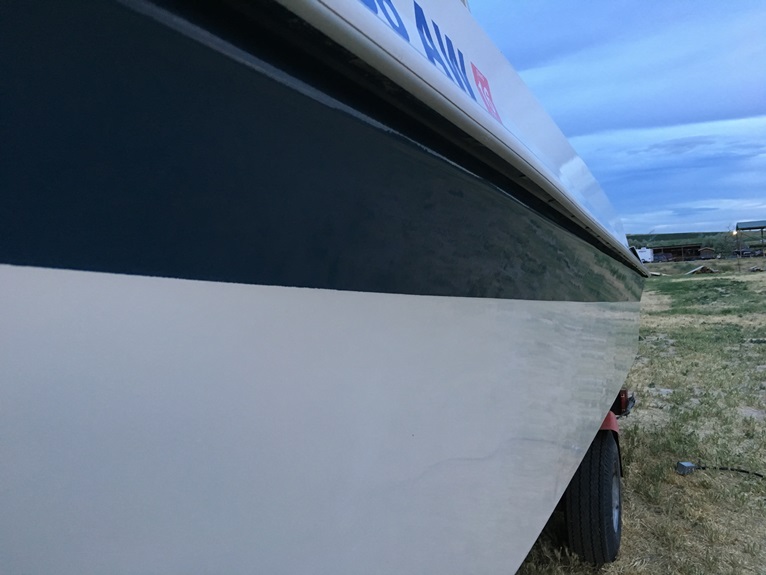

While the Sarah Jo is a very low-hour boat, one of the things that always bugged me was the chalking of the hull, so I decided to do something about it.
My plan was simple, wetsand, rubbing compound, polish and wax. I never thought it would take as long as it has. I started with 1000 grit, then moved to 1500 grit, then 2000 grit and finally 3000 grit. Then I busted out the orbital and used rubbing compound. When that was done, I used the polish and then the wax. The products I used were made by Meguiar's, and I can tell you that I will NOT use any other product again.
Here are pics of Sarah Jo, after I sanded the port side. I'm extremely happy with the results...even the outdrive turned out well. My favorite pics are img0252 and img0253, because you can clearly see the reflection of the landscape in the fiberglass. You can really see the difference in the picture of the stern.
I have been swamped with appointments this week, so tomorrow is set aside for the starboard side wet sanding, polishing and waxing.
I sealed the swim platform about ten minutes ago; it's hanging in the garage now and I'll take pics of it tomorrow. I love the way it turned out.
