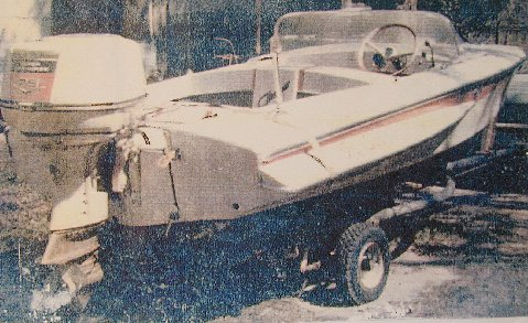

Ran my 1960 Glasspar G-3 110 miles down the Apalachicola river in 1965 with v-4 75-hp Johnson and it took every drop of 24 gallons of gas one-way!! Was running flat out most of the time!!
Made this trip (round trip again the next year)

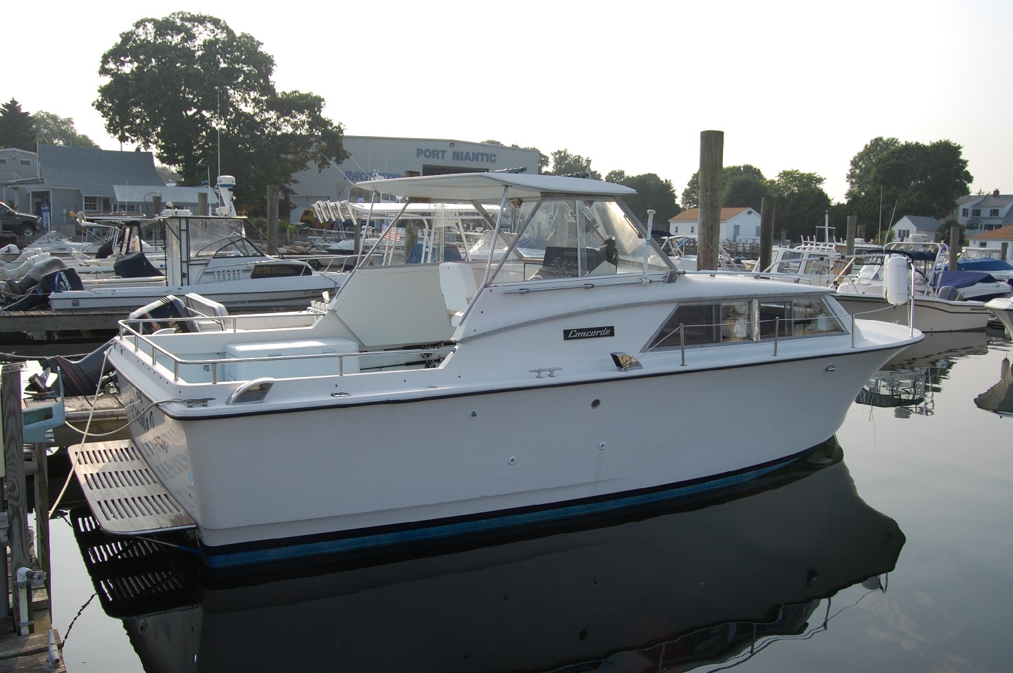

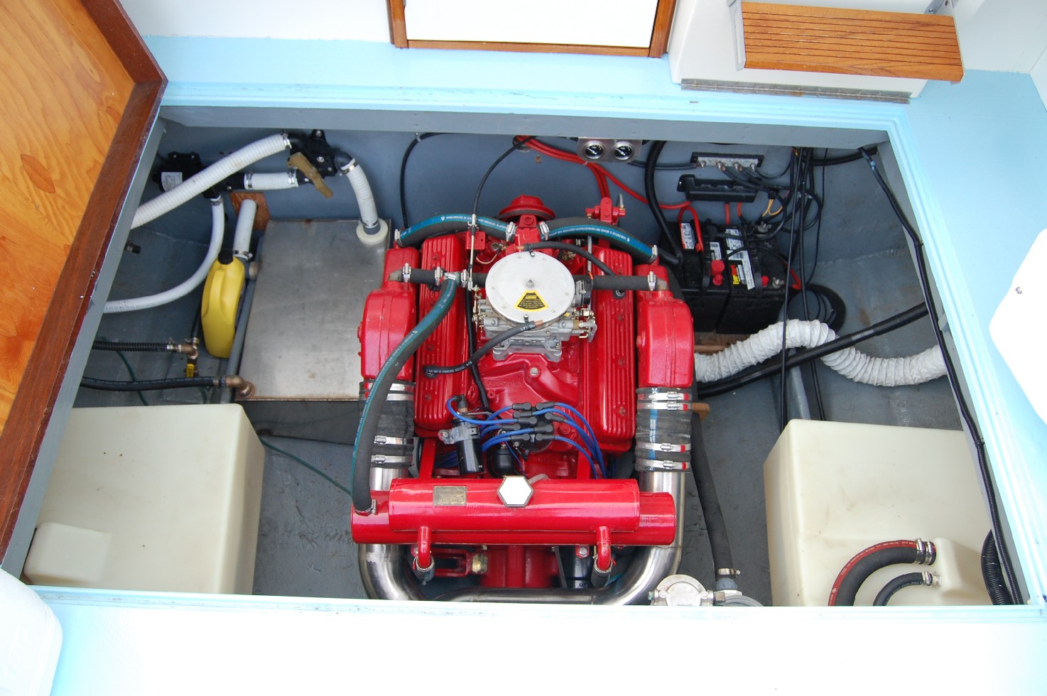

Agree that a boat engine's life is harder than a car engine's. A marine mechanic once told me that at a typical cruising speed its like driving a car up a hill at 80MPH. I average 40 to 60 hours a season with my 27 Owens.
We're out pretty much every weekend, but the length of our trips varies. Cruising speed is around 20 knots, 3450 RPM's at half throttle. I hope to get at least 1200-1500 hours on my motor before replacement.
On the other side of the coin, a properly maintained boat engine gets better maintenance than a car engine. I know of small block Chevy boat engines that have gone 3000 hours. I also have seen catastrophic failures at 500 hours. Go-fast boat motors typically are raw water motors 'cause they usually wear out or grenade before corrosion from being run with raw water cooling is an issue. Getting close to a 1000 hours on a go-fast boat motor would be doing pretty good.
I think that type of use and quality of maintenance are a better indicator of engine condition than just running hours.

Please throw some dirty oil on that engine. You're embarrassing the rest of us.
