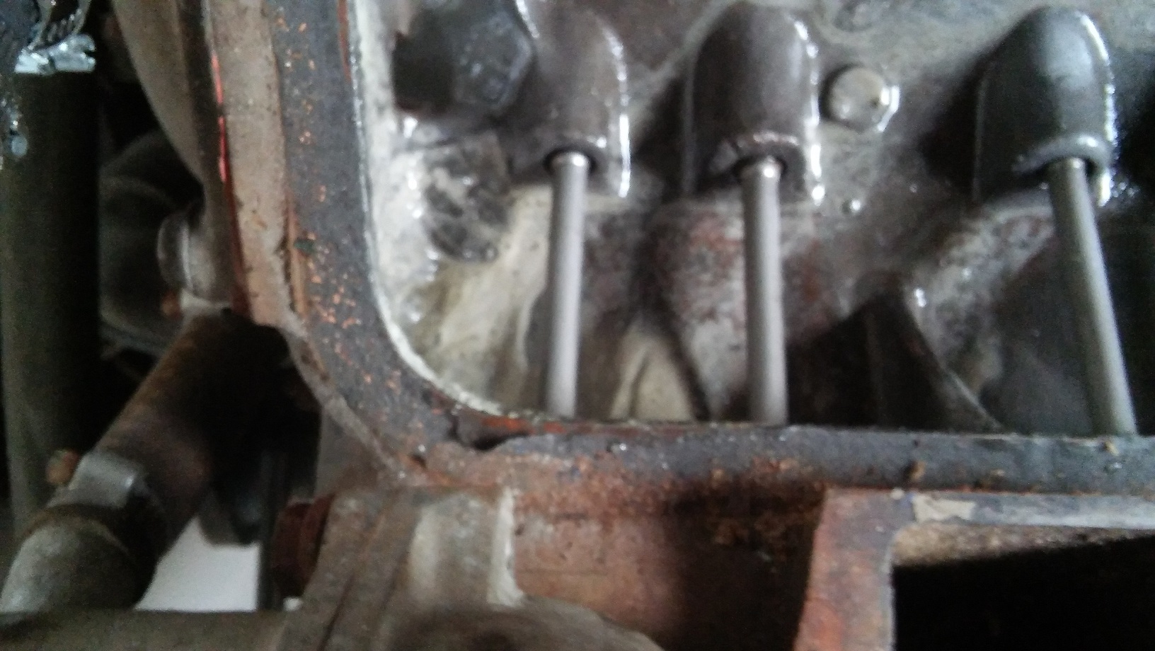

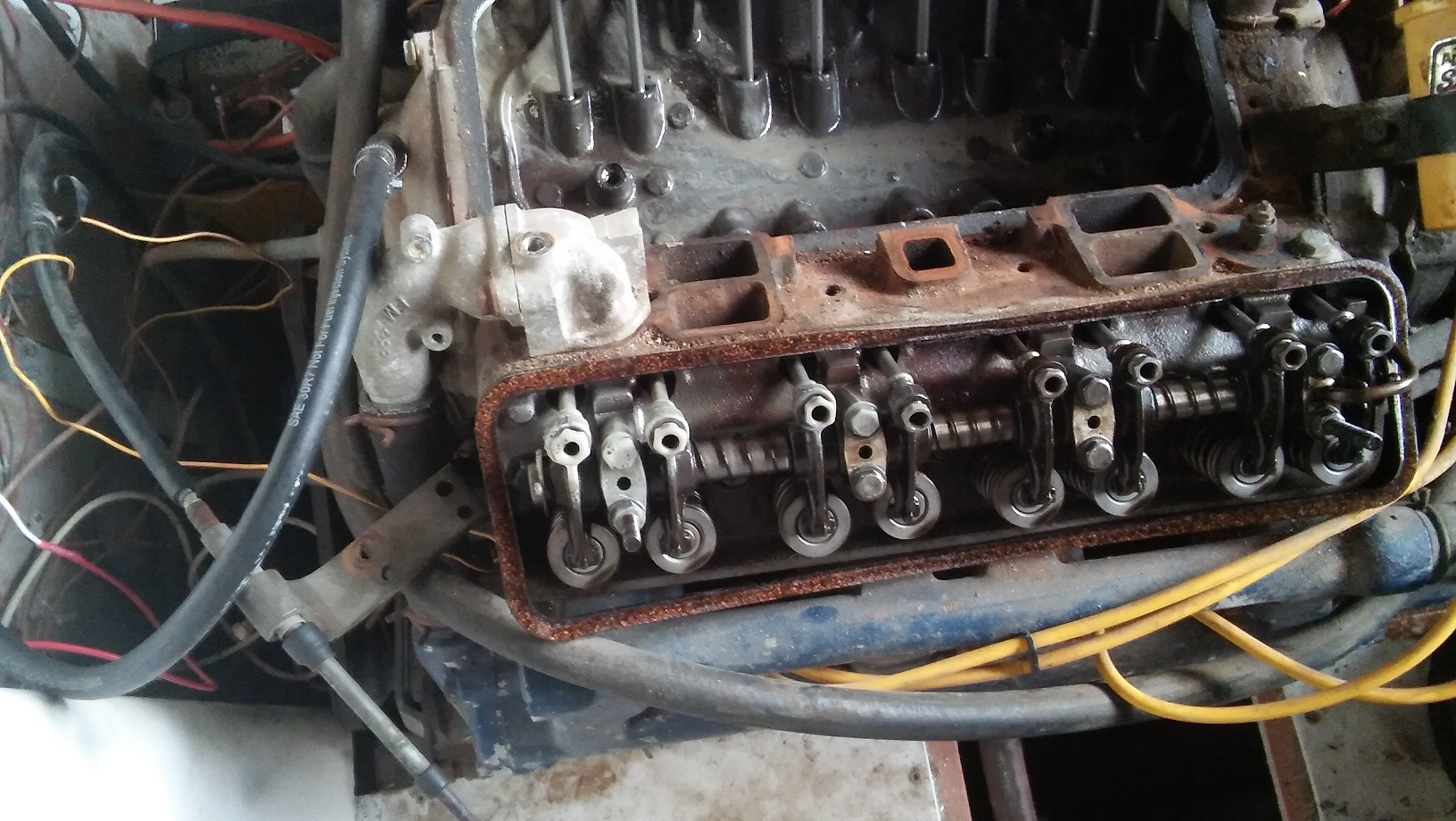

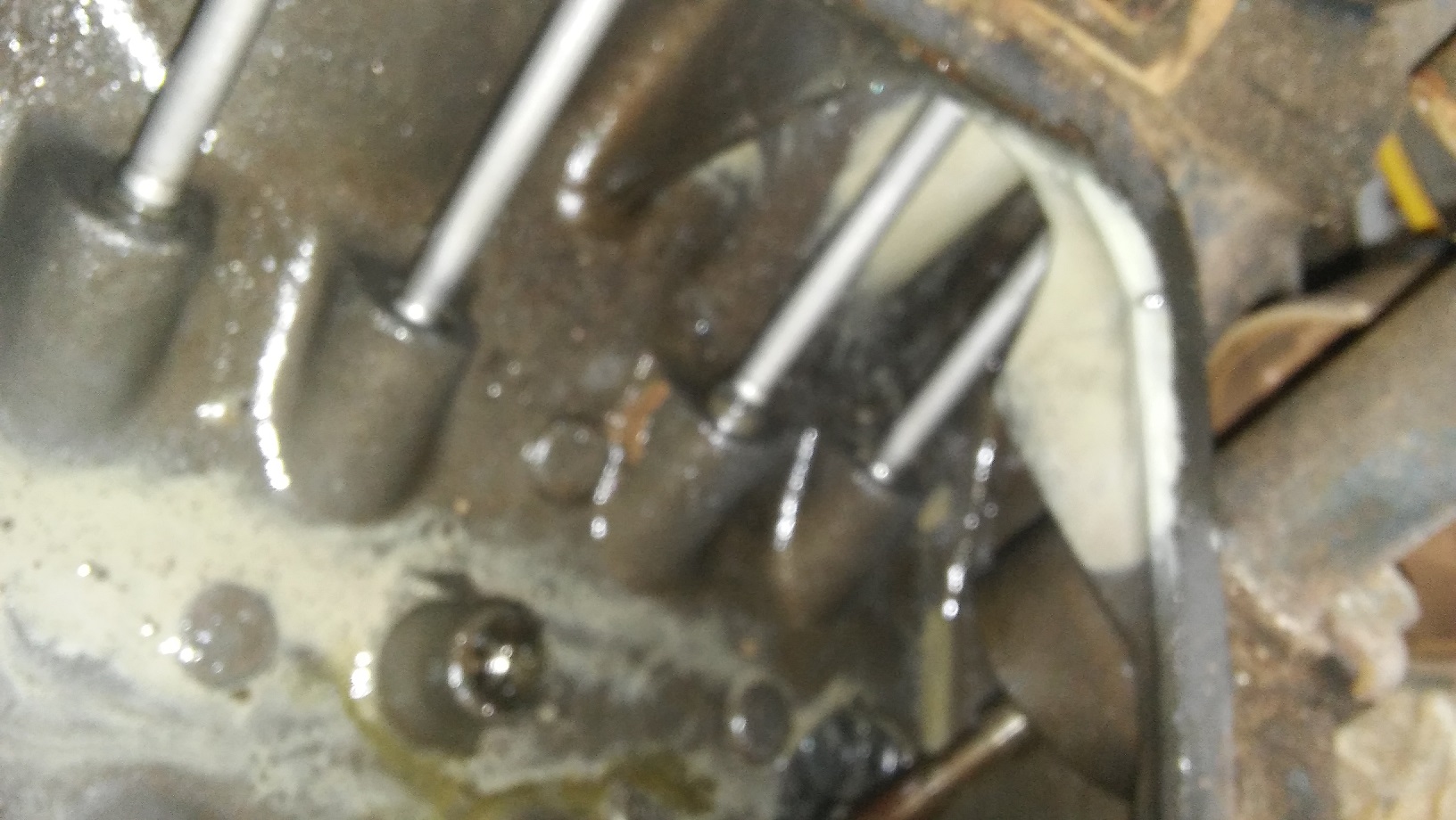

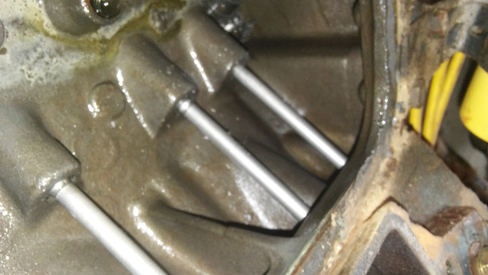

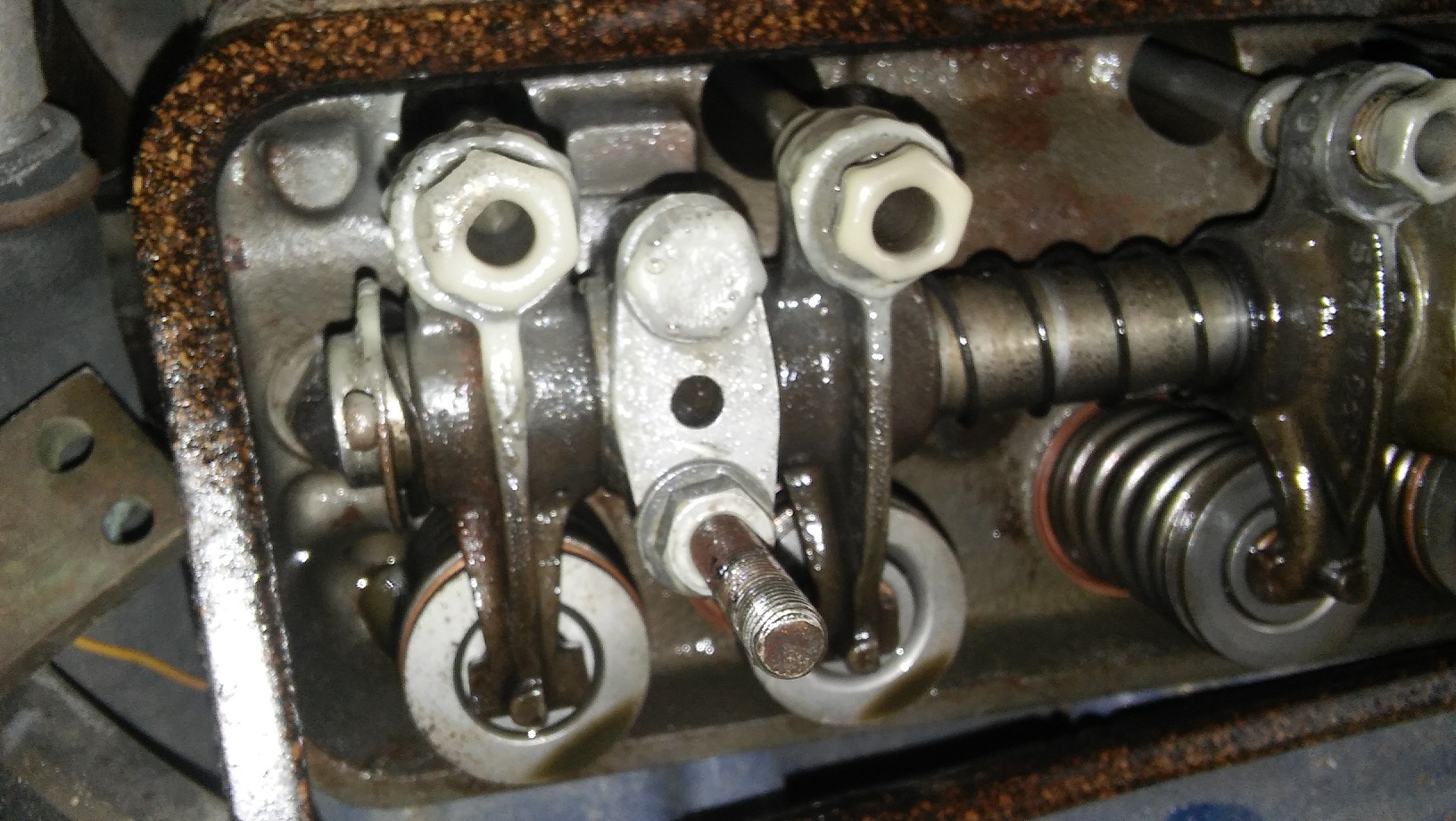

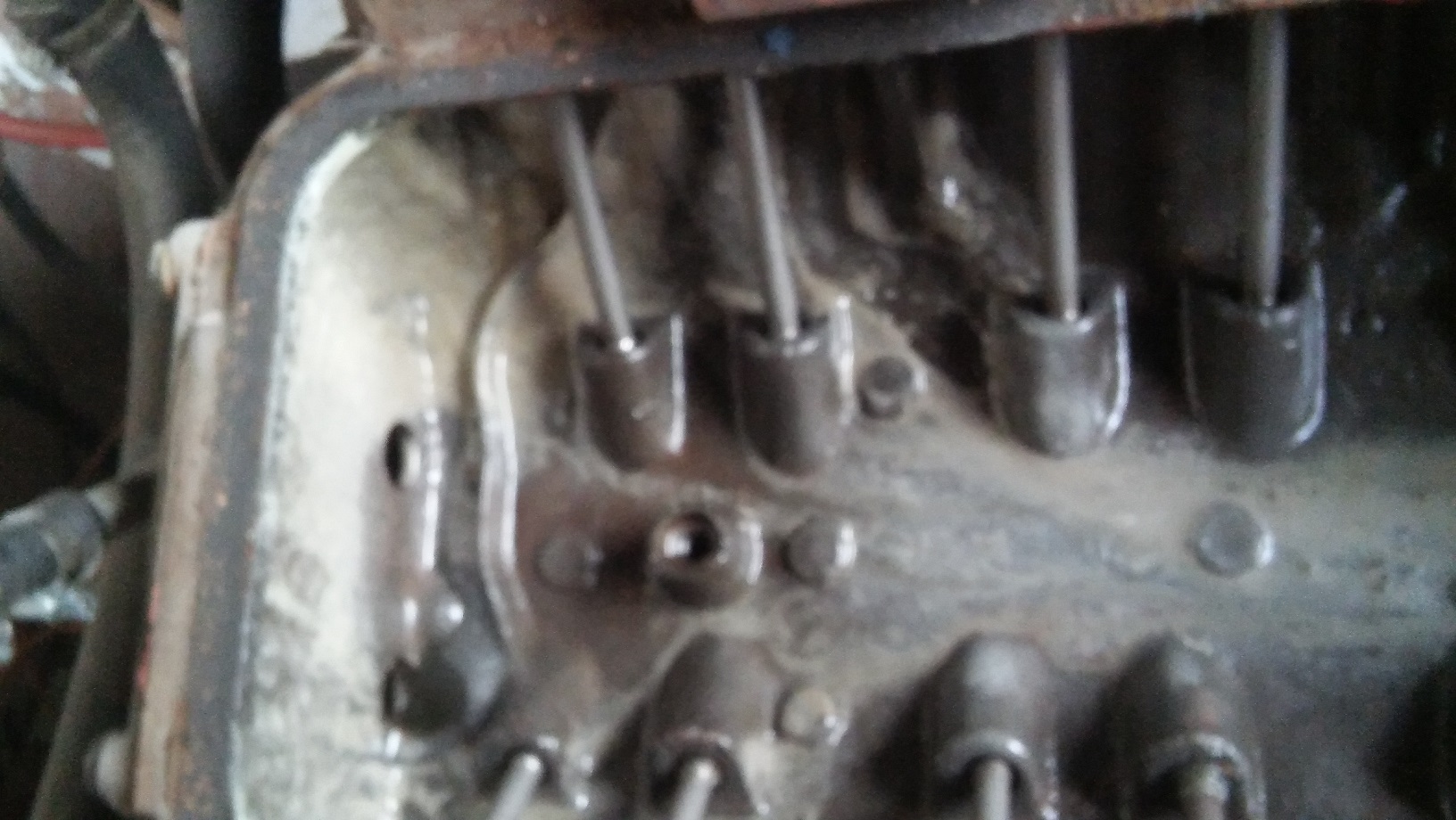

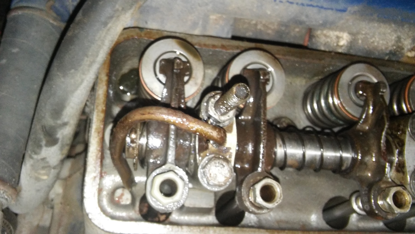

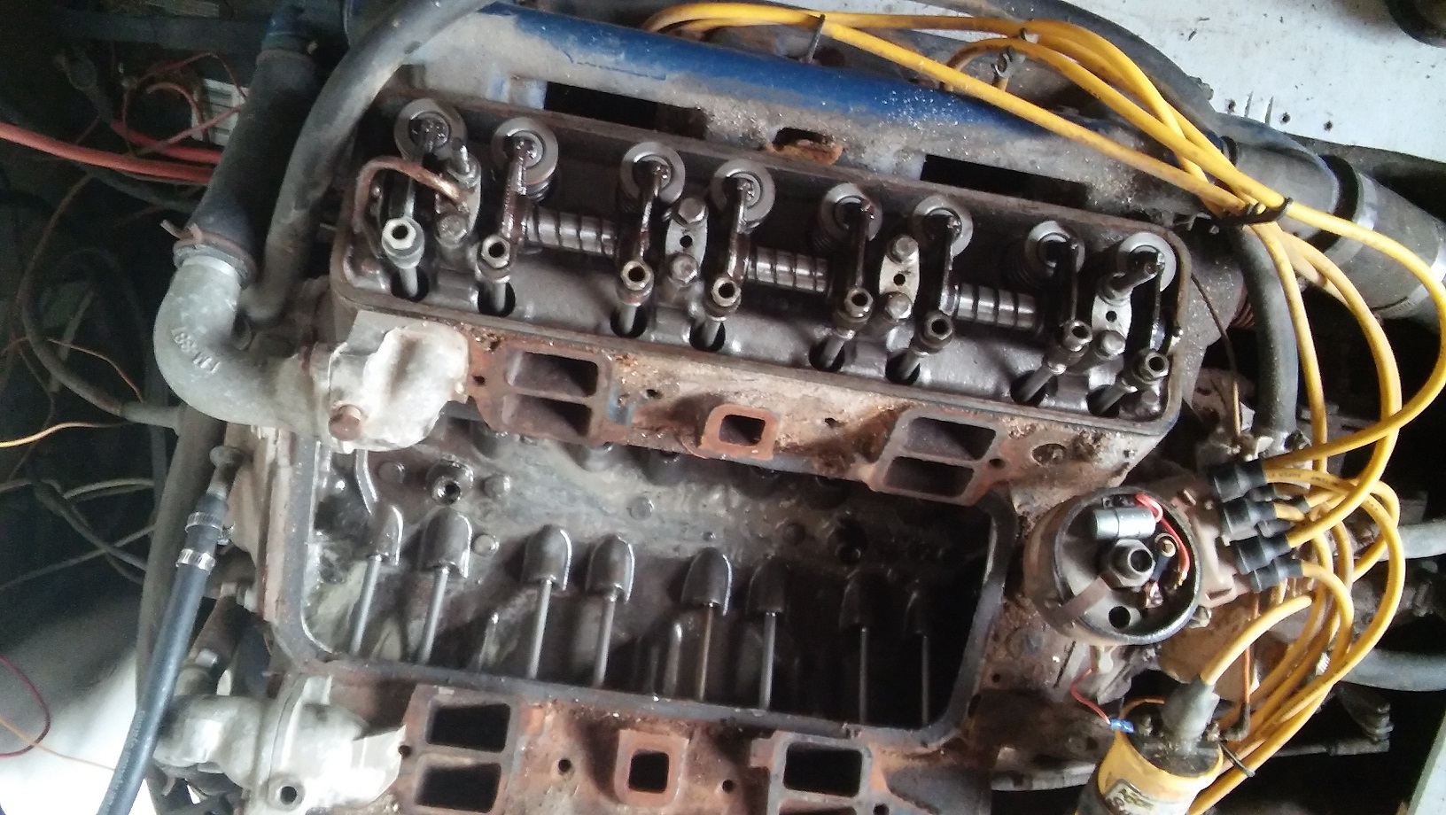

the one tank had a plugged (mud wasp nest) vent, other tank clear, still no fix, took the 4 barrel intake and carb off the saberflite, going to install that setup. Also I think I pinpointed my water source in the oil, Rocker assembly studs over/ through the water jackets in the heads leaking water into the engine.

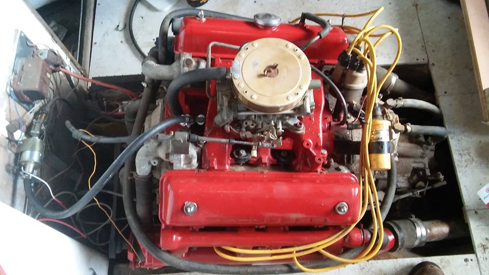

Back together and letting the rtv settup, splashed a bit of red paint on her, Looks good with the "new" four barrel carb and intake settup from the Saberflite...

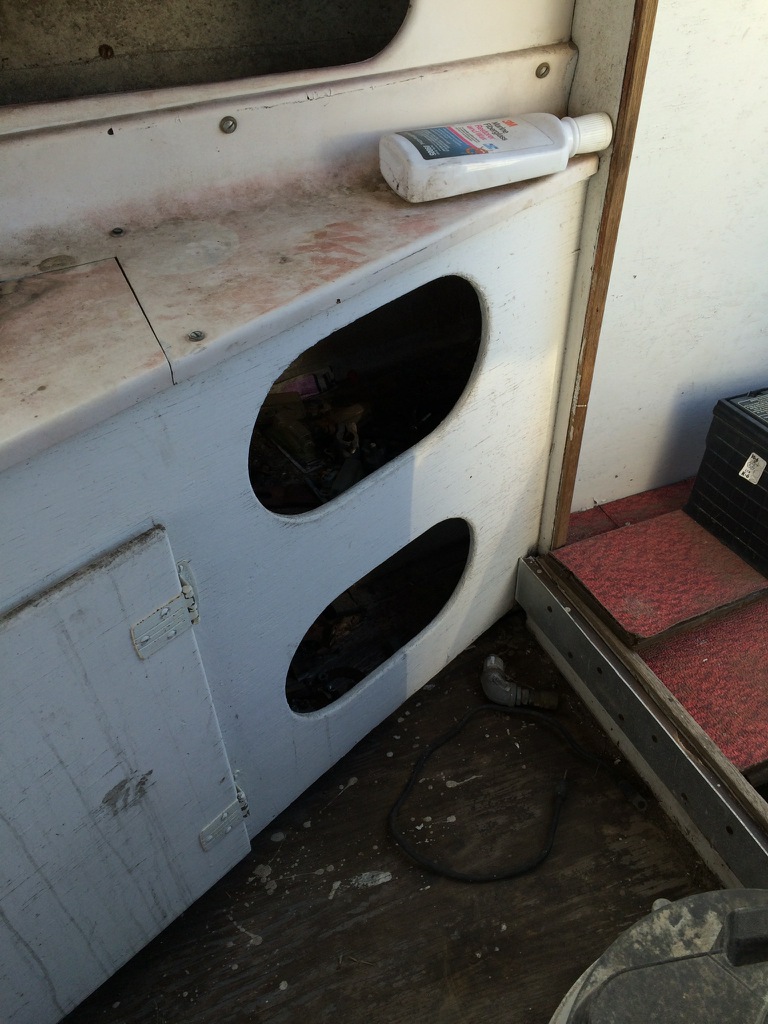

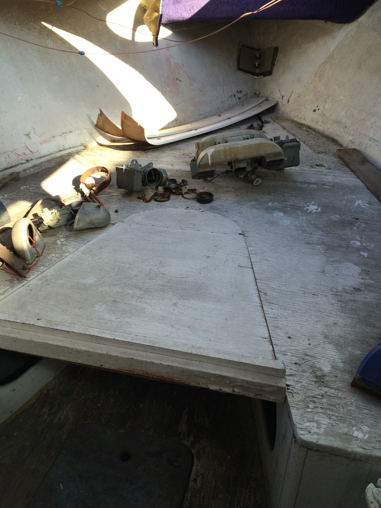

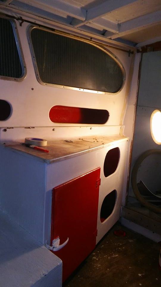

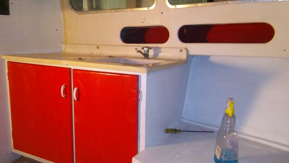

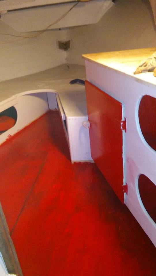

interior progress
