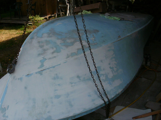

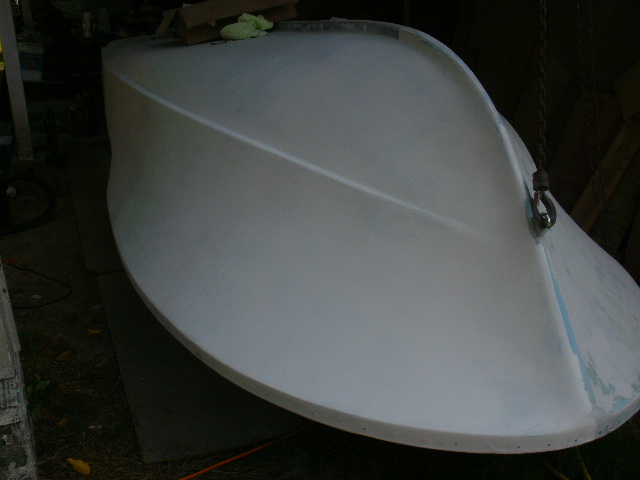

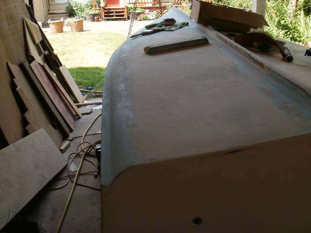

One side and the transom completely fair!! Took the better part of two weeks. Followed the instructions in the how to paint a boat posting and worked great. No shortcuts to a good job. Laid down a layer of kitty hair ( thanks Brian ) sanded fair, another layer of marine poly, sanded fair, then final touch up with marine poly finish filler. Then sand everything with 150. Then primer coat and final sanding with 320. The result is amazing. Took a lot of work to get the bottom fair. Very important to get that bottom absolutely flat! Will be ready for final topcoating (interlux blue/glo white) toward the end of next week. I'm liking the results even with all the sanding! Couldn't have done it without the instructions from this site. I'm very grateful. Mike in Oregon

WOW that is looking sensational Mike, what a great Hull! and now you only have half way to go! on the downhill side now! we will be seeing this hull in paint in no time!
