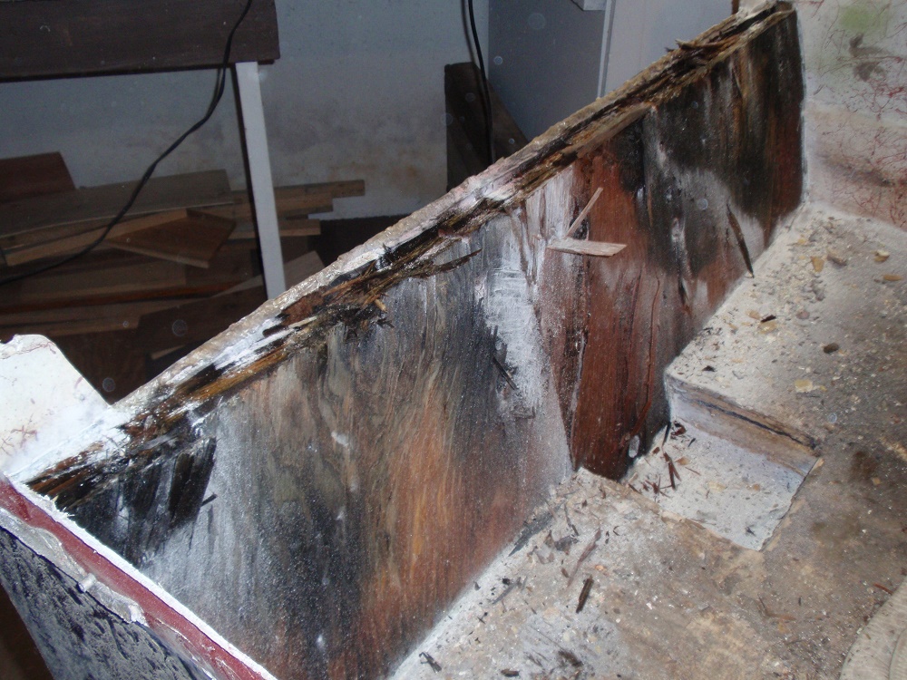

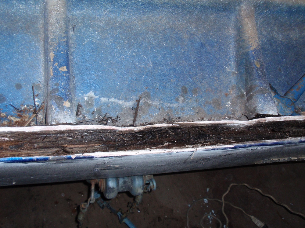

Most transoms are sandwich plywood between layers of fiberglass. The outside back is what you see, usually glass with gelcoat. That is glued with resin to the plywood and then the inside portion is coated with another layer of glass to seal it up. Whenever a hole is drilled into the back of the transom whether it's for motor mounts, depth finders, speedometer or any accessories the seal integrity is compromised and water eventually creeps in. Once the wood is wet it begins to rot. Over years the moisture eventually spreads through the entire transom or floor and weakens it to the point where it is no longer safe or able to support the engine. Had a nephew that barely made it to shore with his family after his 115hp Merc ripped the transom apart. Seems like once the water is there it never dries out...ever! Some are easier to get at than others. Here are two different boats I've done. One was a partial transom that I was able to dig out from the top, the other had to have the topside of the boat pulled off.
