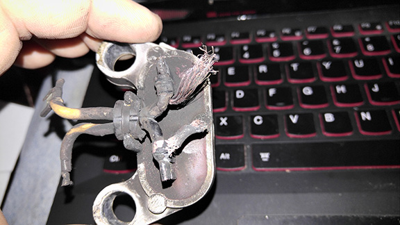

I found our charging problem. The outside diode (?positive) shorted and burned the harness lead in two.
I'm off to find the wizard in hopes of locating this needle. The fuse is good, I lucked out there.
Should I change both diodes when I do this?
Thank
Re:Thanks to those that helped us out at Eden Isle 10 years 2 weeks ago #121887
If they're cheap then get two. You can check the other with a multimeter to see if it's bad. IF I remember right most have a diode setting.
Re:Thanks to those that helped us out at Eden Isle 10 years 2 weeks ago #121890
Hi Bob,
The one I pulled is open both directions
Re:Thanks to those that helped us out at Eden Isle 10 years 2 weeks ago #121921
Yep it's bad.
