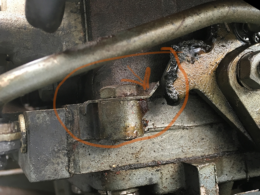

My 1963 Evinrude 60 horse will not go in forward easily. I found that the (not sure what it's called) spring lock was broken. I need to find another but don't know what it's called. Does anyone know?

I tried to post a photo but with no success.

If you look for your motor on www.marineengine.com you can usually find the actual part number which will make your internet searches much easier.
Re:63 Evinrude 60 outboard. Forward lock spring 10 years 4 months ago #121594
I found the part name. It's called a shift, detent spring. I have not been able to find the part number. Or where to buy it.
Thanks
Re:63 Evinrude 60 outboard. Forward lock spring 10 years 4 months ago #121596
If it came on that motor originally it will be in the parts diagram at MarineEngine.com and the part number will be listed below the diagram
