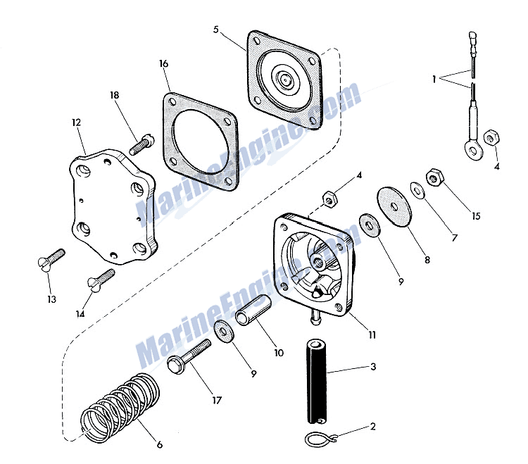

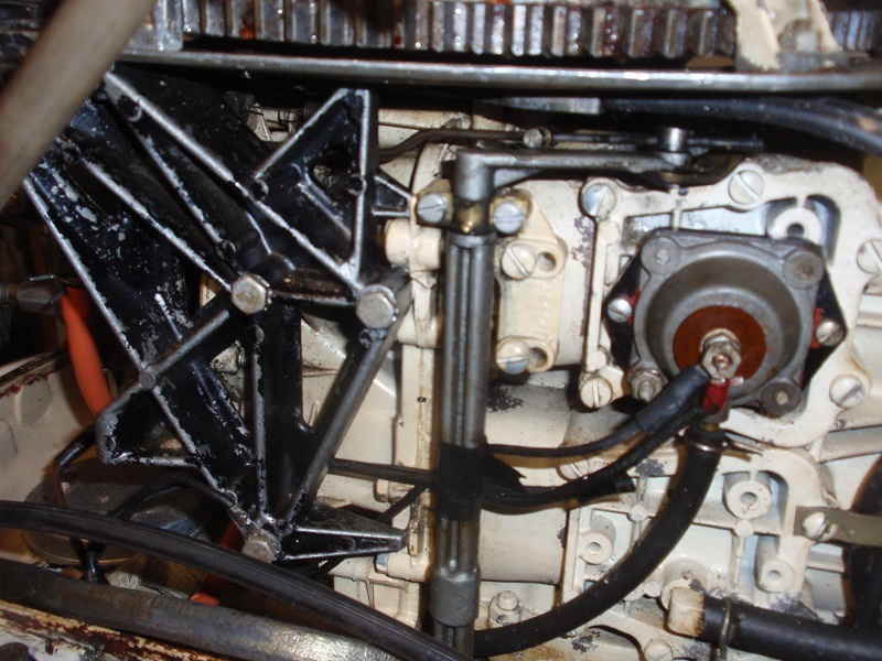

Squirrel. Before spending lots of hard earned cash on replacing everything check your cut out switch. Simple to work on and inspect. It's function is to prevent the motor from over revving when not under load. It does this by cutting spark to one cylinder, works on vacuum. Google/Bing Johnson RDS-20 for info.
Try disconnecting the two wires that short out the magneto, let them hang loose and start you motor again..Just a suggestin.
