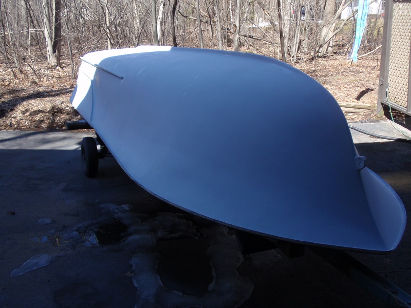

Did manage to keep busy during the shutdown. Got the Tomahawk bottom prepped. Sanded, filled, primed, sanded, primed again and now wet sanded with 600 and washed with clear water. What do you professionals use to wipe down or remove body oil type contamination before a final coat?

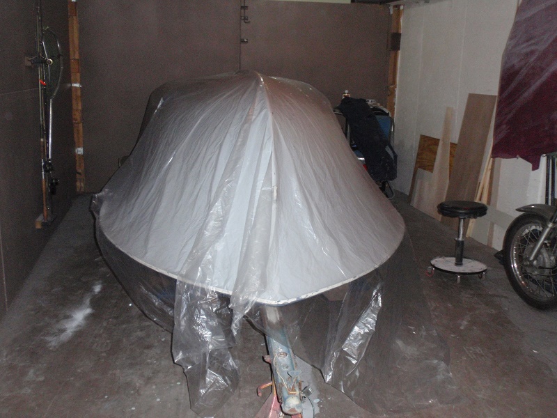

Right now the boat is covered with a very light plastic to keep dirt and stuff from contaminating it.

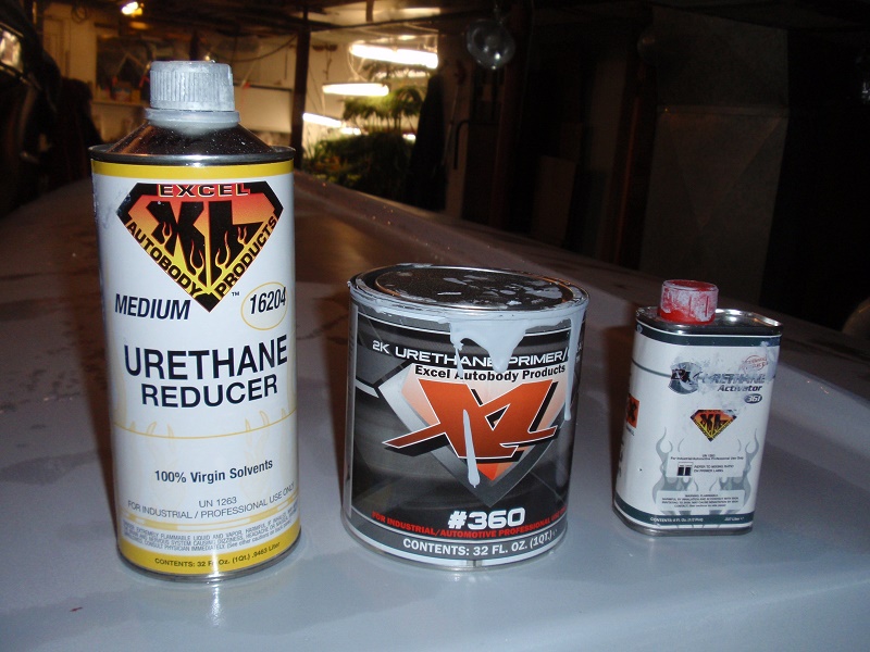

The Primer that is in the picture is from an auto store that specializes in paint. It is what's called a high build primer which means that it's thick but sprayable and fills in those pesky little divots and sanding scratches. It can be reduced for a normal spray gun and multiple coats applied, dries very fast once applied and sands really easy. If you mix like 8:1:1 you can spray with about 30 PSI with a HVLP cheap Harbor Freight gun and has a pot life of about 4 hours after reduced and mixed with the hardener. Once you have it sprayed and dry I take a small artist brush (el-cheapo) and dip it into the leftover mixed primer which by now is getting pretty thick and spot drop into the small imperfections which are always showing up. That sets up within an hour and then you can sand down those spots again probably with a 220 grit. I usually wind up doing this a few times cuz those pesky imperfections keep showing up again and again. My equipment is what you might call cobbed together. I have to run two compressors in series to keep up enough air pressure.
The interior had no seats so I'm making my own. The topside will be white over calypso coral. The inside glass walls will be pure white probably rustoleum rolled on. The seats I am making are white marine vinyl with coral piping, working on bending the 3/4" bracing for the front buckets today. The bilge area I'm thinking might be truck bed liner which is very tough and water proof.
I do everything myself, don't outsource any interior etc. and it shows :laugh:

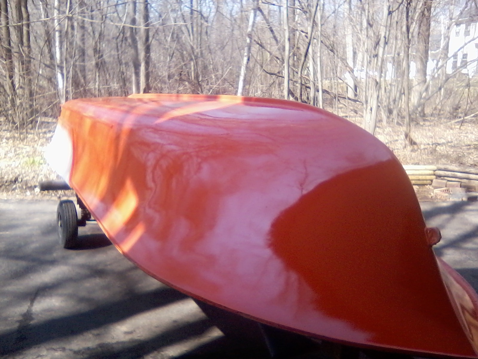

Did go to the paint mixer and got a quart of wax/grease remover and did a complete wipedown. Splashed on three coats of coral. Yesterday got to colorsand the entire bottom and reflipped on to the trailer. Made initial setup install for the front seat bracing.
No wax or polish on the bottom so it's still "raw". That's about the last step.

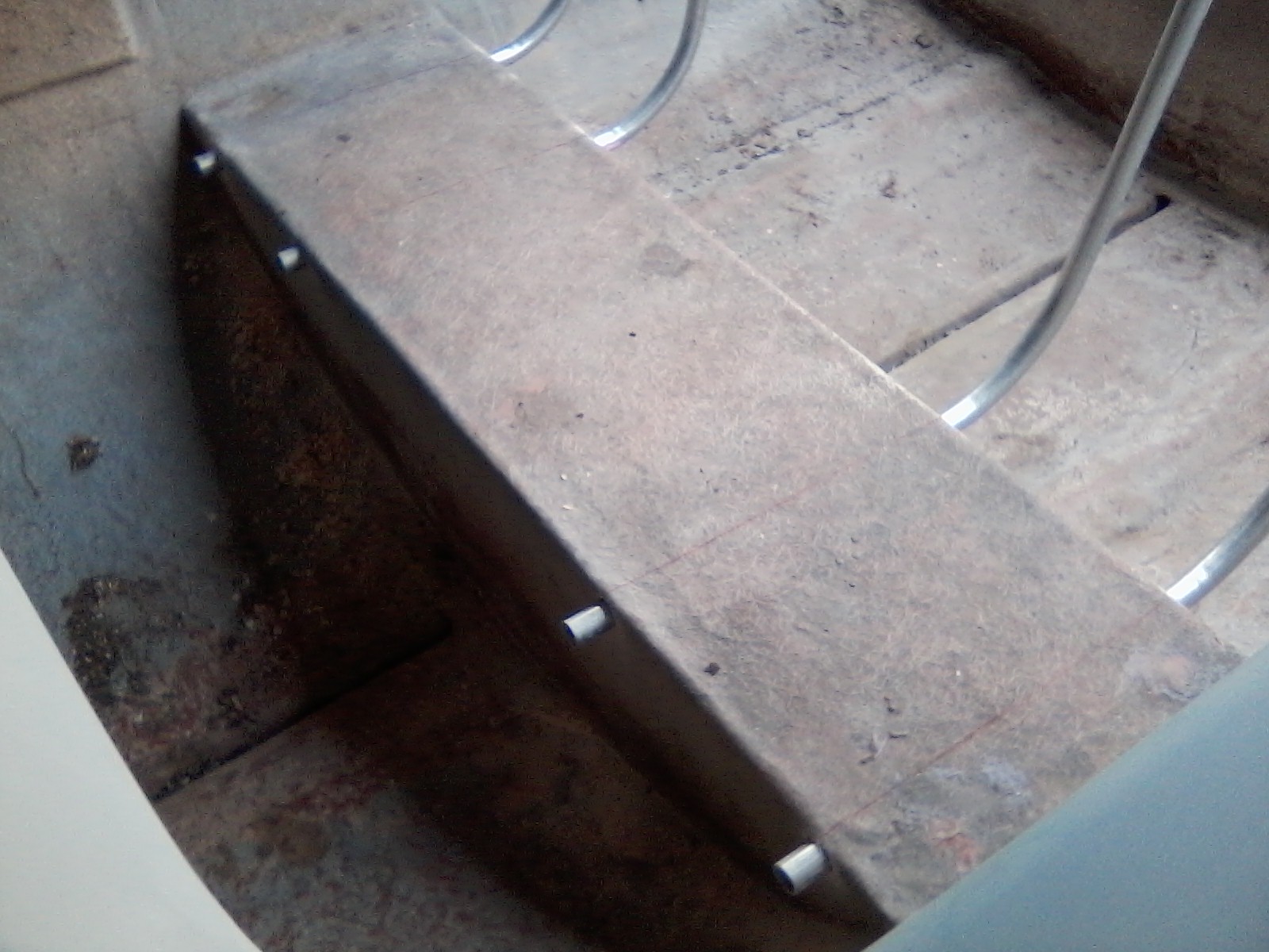

Also installed extra knee bracing on the transom with 5200. Just "tabbed" them in place with glass strips until the glue sets in seven days and then they will be glassed entirely.
