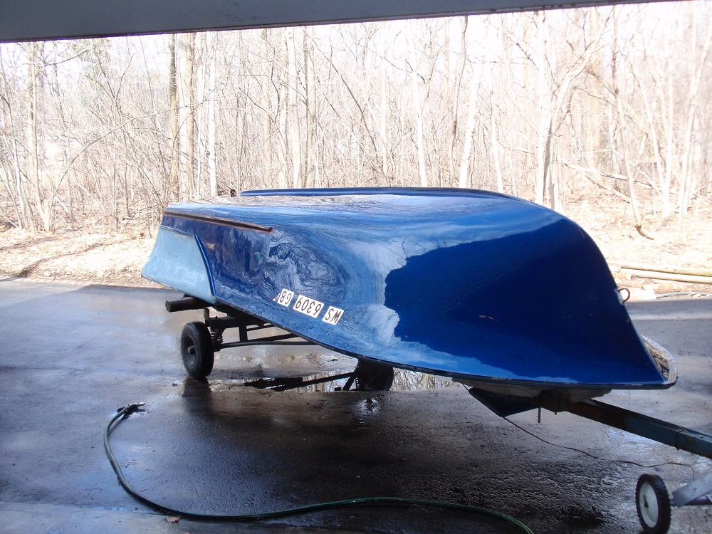

Especially with a finn.

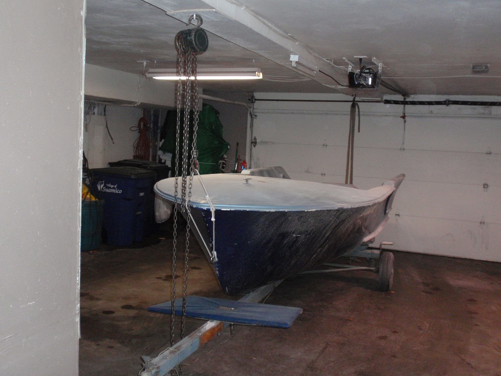

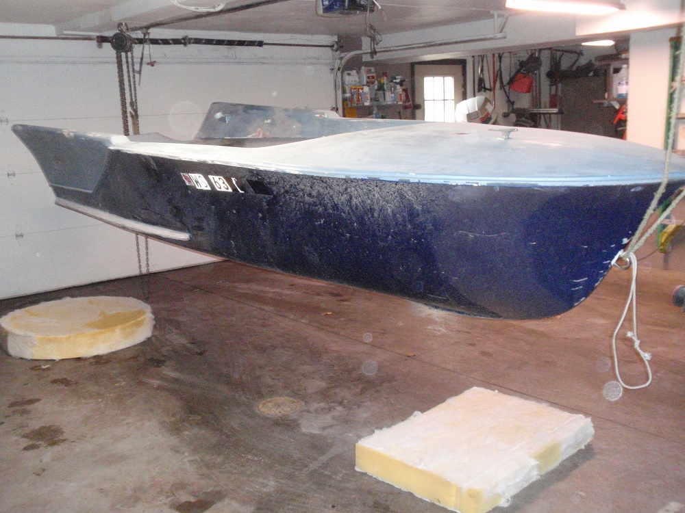

Had to bite the bullet and flip the Tomahawk. Not an easy job for a "senior" doing it alone. Always makes me nervous until it's settled back down on terra firma.
Good news is it didn't drop 4' to the concrete and the center is not hogged. Now for a few days of sanding and scratch repair.

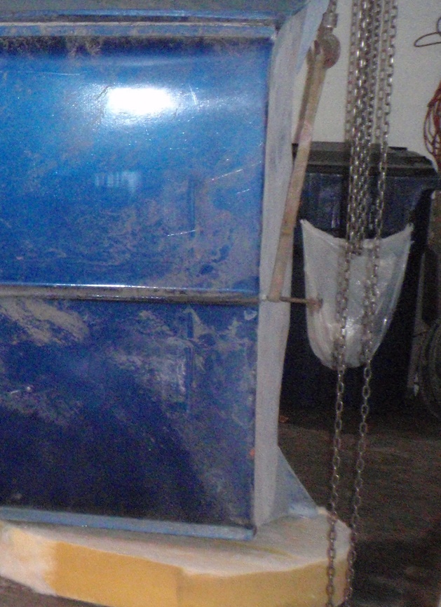

I'm glad you eased your mind with the foam.
Because if that boat fell ? I don't the couch cushions would have saved her ? Ha-Ha-Ha !!!

Actually it was one of my easier flips. Hardest was the Century woodie. Bob (waterwings) can verify that...those suckers are heavy.
This Tomahawk was pretty well balanced. Ran a large bolt through the bilge drain and hooked up to that. Had to replace the cheesy bow eye with a two shank one reinforced from behind.

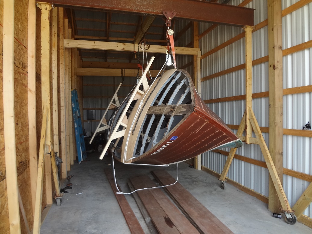

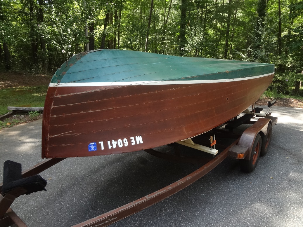

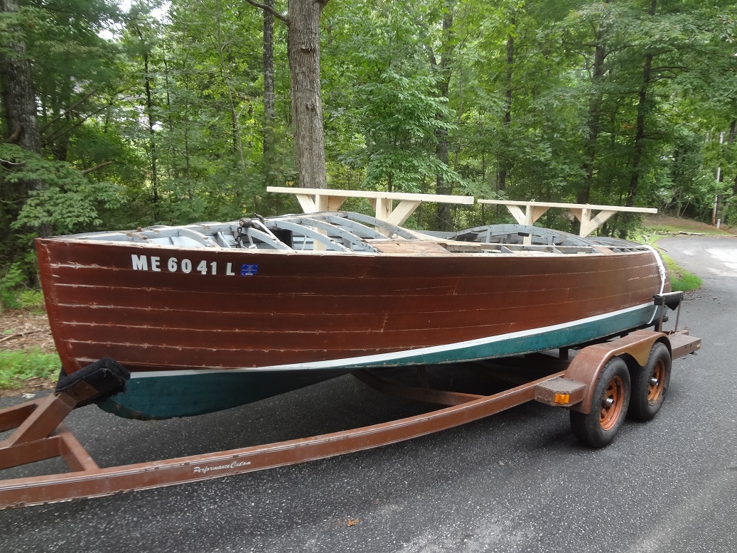

When we flipped the 19' 1929 Dee Wite, it was nerve-wracking. It had to be done with slings since there was no way to use the bow and stern. It was a real problem because most of the framework was bad and the topsides had already been removed. If we had dropped it, it would have turned into a pile of firewood shaped like a boat. I built two well-braced "towers" that rested on the stringers and hooked up a pulley arrangement that allowed the boat to spin. When lifted, it immediately turned 90 degrees but it had to be jacked up on one side to get from 90 degrees to 180 degrees. But the real trick was stopping it from spinning all the way around to 270 degrees where it wanted to go which we did with a "catch rope" pre tied to the right length. After we had it held in place at 180, we backed the trailer in and set her down.
I bought that rolling steel I-beam gantry for $500 from the local welding shop. Smart money.

Jan, I know exactly how that goes. Many pictures of flipping the Century Sabre and inch at a time and trying to keep it from rolling and sh----ing out from the bottom. Looks like you did a good job of bracing.

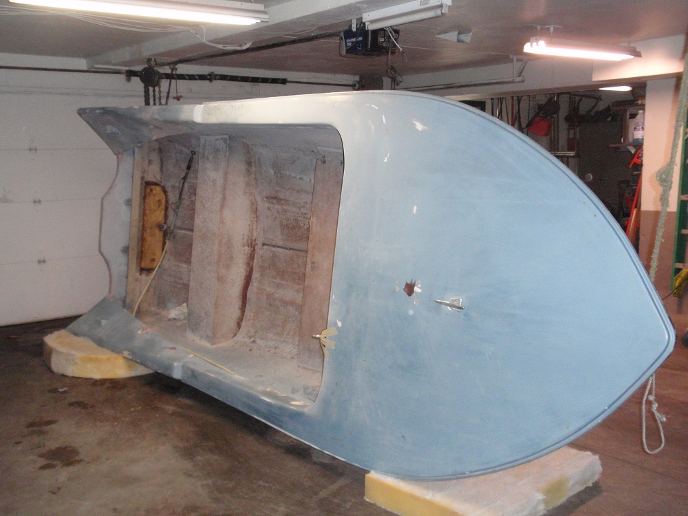

About that paint job...Knowing your sense of humor I want to say I used a roller with a latex paint and then sprayed olive oil over the top to bring out the shine also makes it smell like a fine Italian custom. The flipped picture in the driveway looks shiny 'cuz it was just hosed down and brushed to get the dirt off before sanding and scratch repait. It's the sorta picture people post on EBay to make whatever look good.

Jan, Wesson oil was plan "B". Fortunately The bottom isn't too bad, some deep scratches but no through gelcoat gouges. Honey do list is creeping up since the weather is turning sorta warmer if 40 is warm. I'll gradually start sanding with 180 grit, dig out the deep scratches down to bare glass and dribble them in with pure resin. When I do start sanding the neighborhood will have a nice deep blue haze settling on everything. Will be painting for sure, prolly single stage with hardner ut will be using a high build etching primer first. Can't do any painting probably until mid to late April when we hit a 60 deg day or so. I do see that the original colors were white on the topside and red or a deep coral on the bottom. If I stick to those colors the interior seating would probably be red vinyl with white piping or visa versa.
