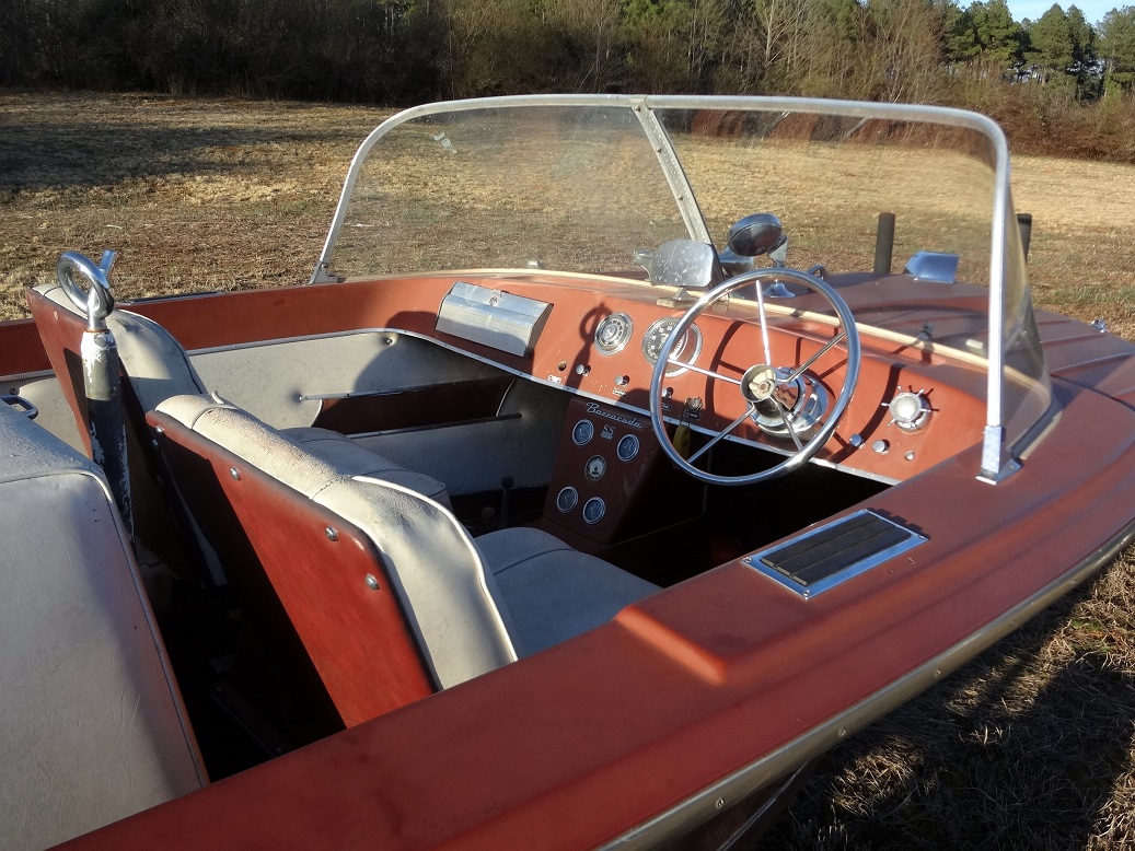

I found this 1968 Correct Craft Barracuda SS in Marietta, GA. Barracudas are a rare find, especially the SS models. It's all original, even the trailer, every single part is there and the glass windshield is flawless. The engine is real iffy but I plan to replace it anyway. The boat needs restoration and the color has got to go but structurally it's rock solid.

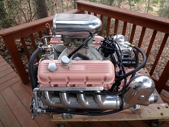

It does have the original Chrysler 318 but it's a disaster. That was my big bargaining chip on the price. Actually, I'm probably going to build-up a big block Chevy and mate it to a PCM 1.23:1 transmission. It might be a little overkill but I have a good 425HP long block that just needs new rod bearings. It's the one the owner supplied which threw a rod bearing on the sea trial of the pink Correct Craft Debonnaire. The owner picked up the phone and bought another long block...gave me the engine with the bad rod bearing. It will most likely be enough horsepower to pass every bass boat on the lake before it enters hyperspace but at my age, I won't dump the throttle too often...honest...don't you believe me? Here's a shot of the engine that threw a rod. From all outward appearances, the boat will look fairly stock but the surprise will be under the doghouse. Back when I was a teenager, something like this would have been called a "Sleeper."

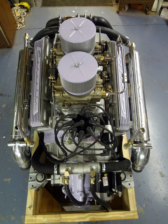

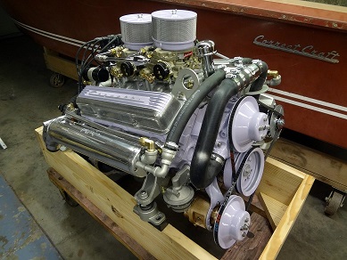

Well...I sold the Barracuda and I'm doing a resto-mod for the new owner. He thinks like me and gave me free reign to build an engine to replace that dead 318 Chrysler. Here's what I built:
I started with a 1985 GM 350/300 HP marine long block and added a performance marine cam, vintage Edelbrock dual carb manifold with twin Edelbrock #1409 carbs (progressive linkage) on 12-degree wedges, vintage Edelbrock M1 marine exhaust logs, 200 amp GM 1-wire alternator (chrome, of course), vintage Corvette valve covers, Mercruiser 7.4 Bravo One raw water pump, Pertronix distributor and coil, etc., etc. The color is 1955 Lincoln wisteria, same as the hull will be. I figure I've run it up to about 330 HP+...and that's the same as a stock 454 Mercruiser. That ought to get the old girl moving down the lake!

Re:Picked-up another Inboard Gem 9 years 9 months ago #128183
Beautiful lookin' mill. Like the twin 4's on the 12 deg wedge(s) should keep the floats working right. Progressive linkage just might save enough fuel to get back to the dock at idle.
