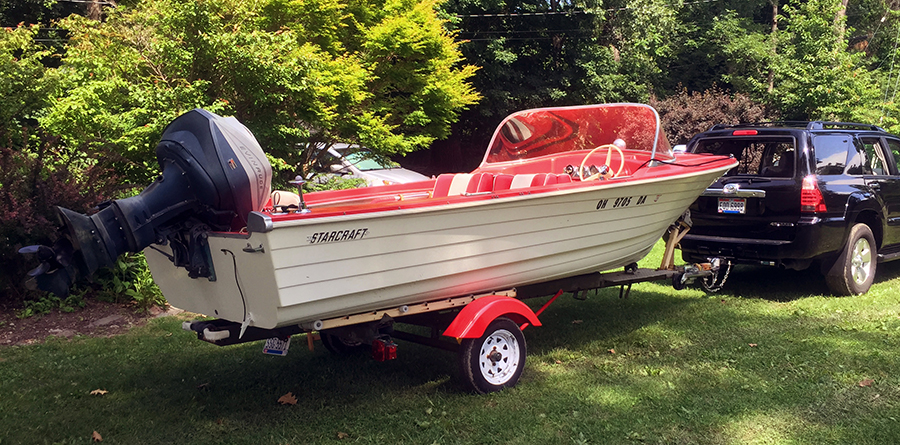

I have a question about my 1963 Starcraft Comet boat. The outboard is a 60 hp Evinrude that runs pretty well but has trouble planing with 3 or more people. I'm considering on buying a newer motor. Of course the Evinrude is a large and heavy motor. What would be the best choice for brand and horsepower? The boat is very light in weight. 750lbs. Thank you for your time.

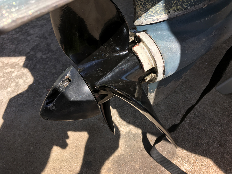

OK, I purchased a new prop. 10x9 1/4, #012042. My question is, is it correct? It fits but is smaller for the outside diameter. Please see photo. I assume it is correct and need to buy a smaller prop nose.
Thanks for your help. I just don't know much in this area about props.
David
