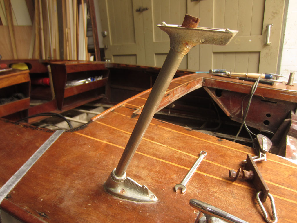

Hi Andrew,
I've been looking for that exact sternlight for ages! We lost the top part of ours in an accident and I've been looking for a replacement since. (see pic)
I would really love to buy this one from you, or if you already have it in use could you give me any information that might help me find a replacement? Only through your comment at least I'm sure it's a Perko so that already helps a lot :)
Please let me know!
Thanks,
Alex
