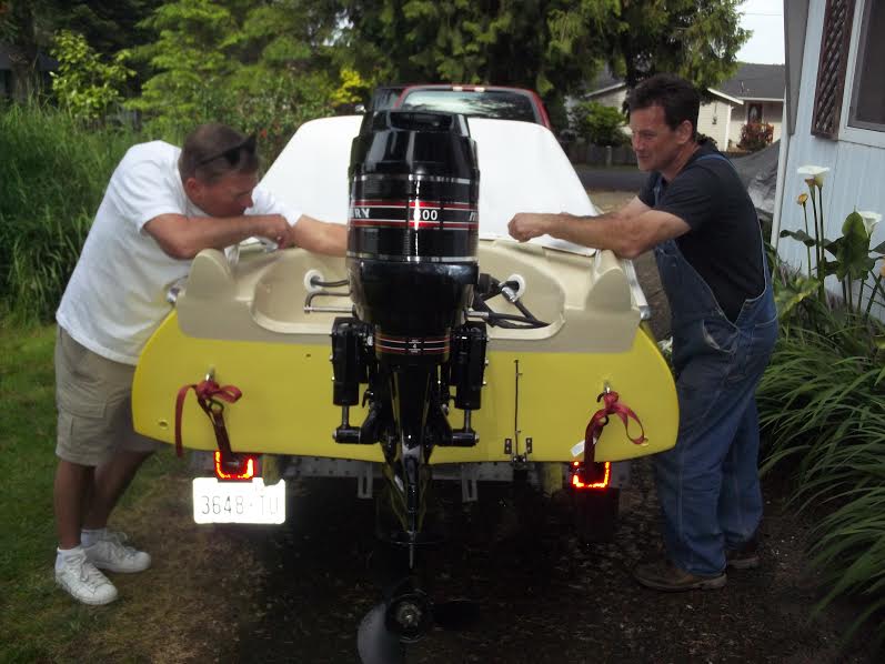

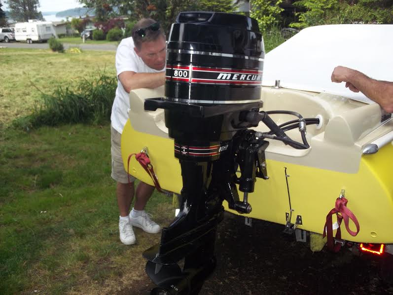

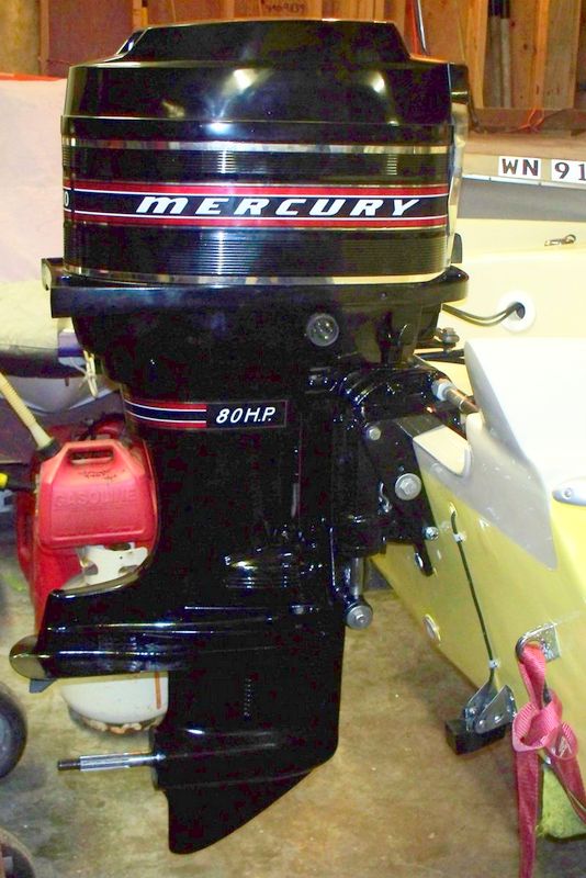

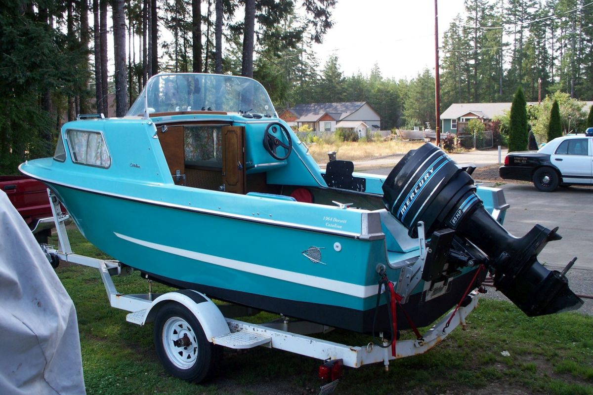

I have attached some pictures of a sweet rebuilt 85HP 4 cyl Merc with PT that I did, and installed for a pal.
IMHO,...The 85HP 4 cyl Mercs are the perfect horse power for the Catalina.
I'm not sure, but I believe that when Mercury started installing low dome pistons, and also started rating the HP at the prop rather than the flywheel,...The 85 became a 75HP.
doc F

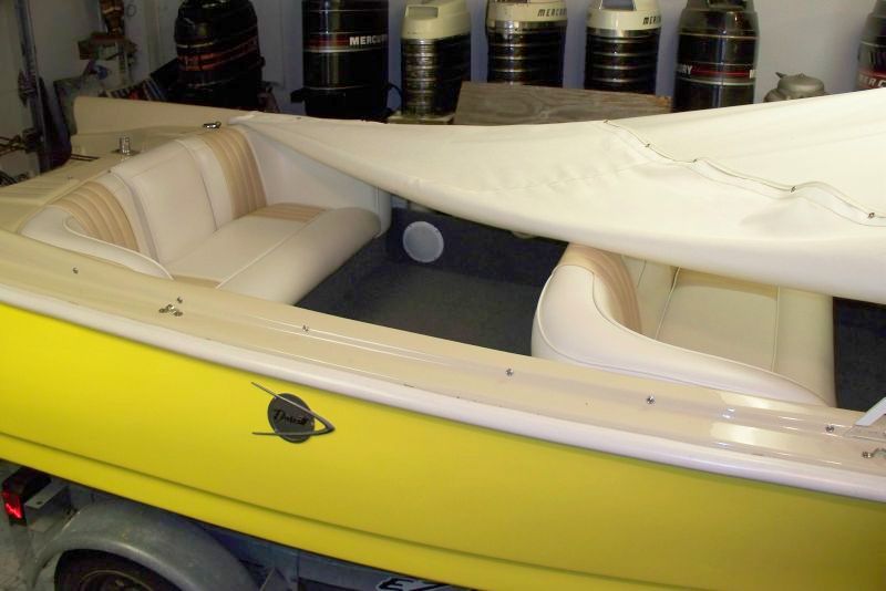

I'd go with what doc said. He did a 80 for my friend with a Dorsett El Dorado and looks perfect! Pix...
