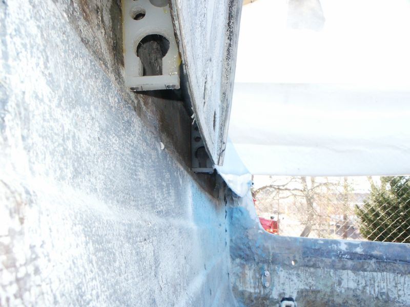

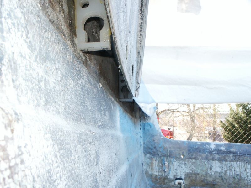

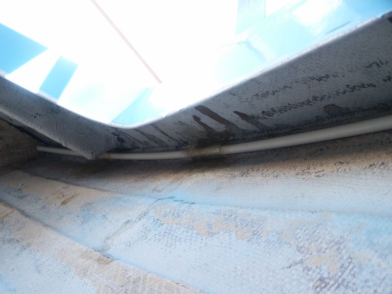

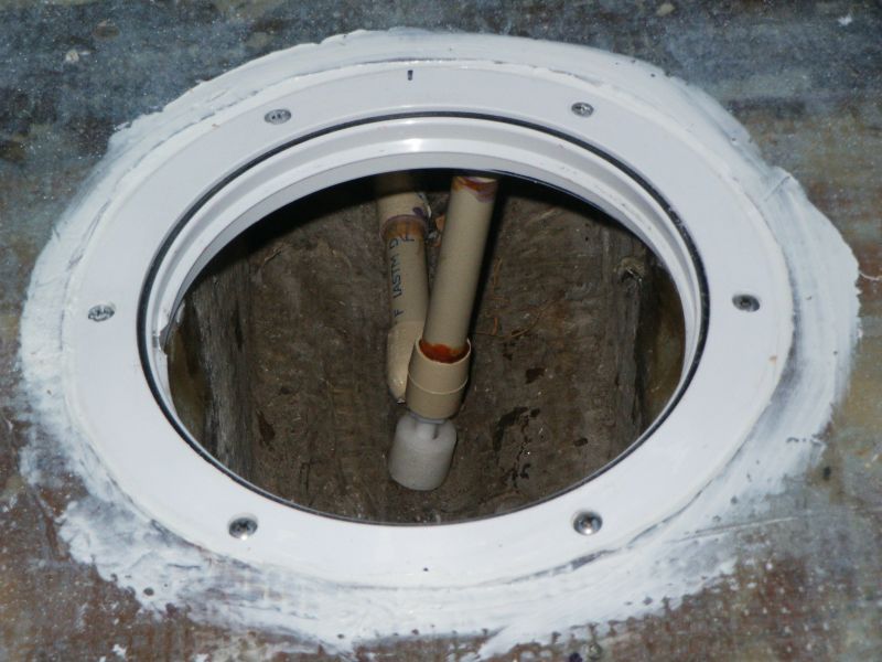

ok i had 3/8" plywood for some hangers for my electrical that didnt work so i got some 1" thick polypropylene i think thats it and used my pattern to redo the hanger that worked great i had room to put my inserts in so i can screw the bottom on and off at will. epoxied them in and now i can run steering , controls, and all my electrical and i have a small tube for my water pressure gauge. by itself ad i ran 1/2' water pipe front to back for the bow light ad glassed that in too on both sides i hate dangling wires ok pictures now oh and i got my float switch in the bilge works great
