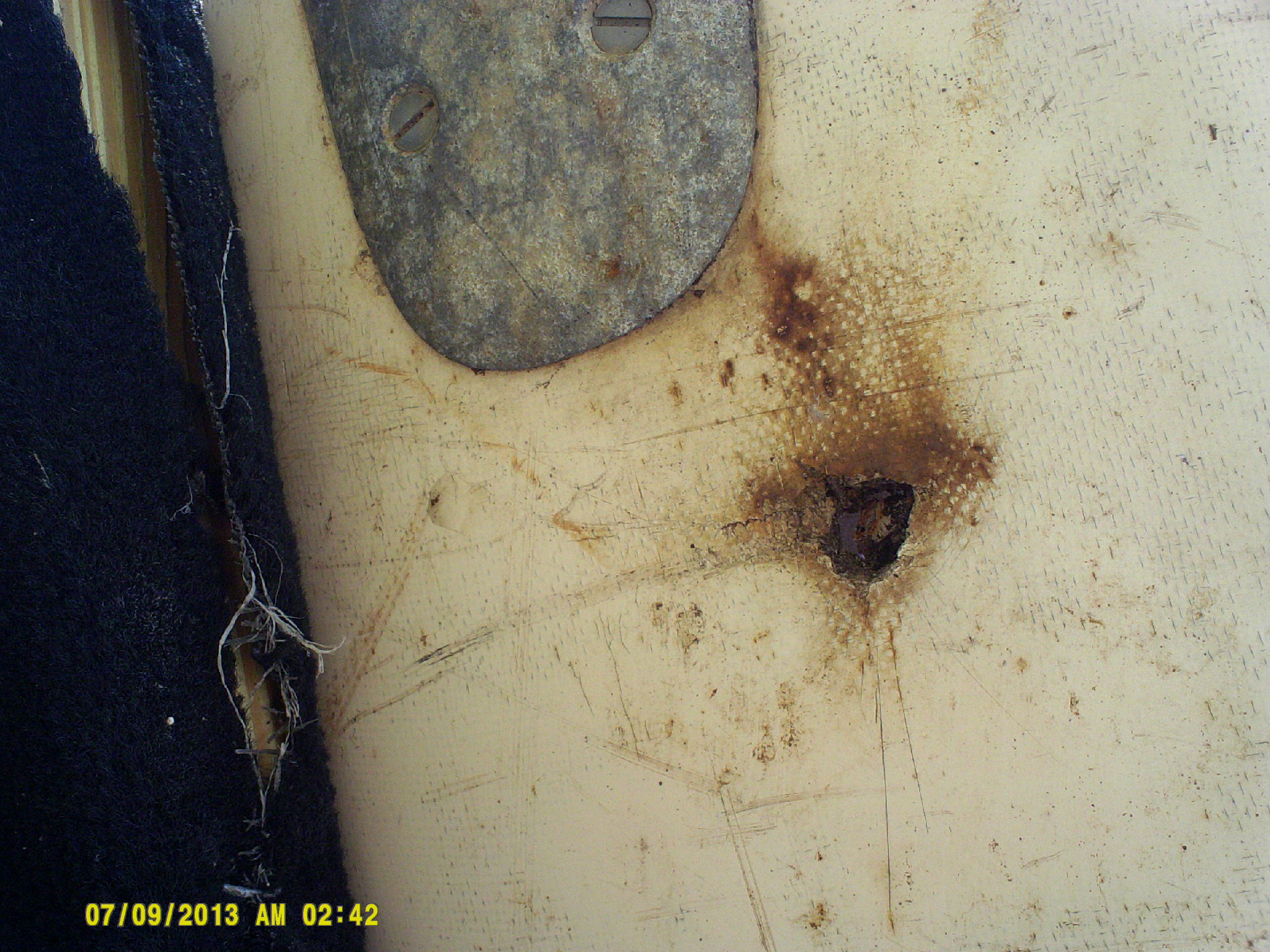

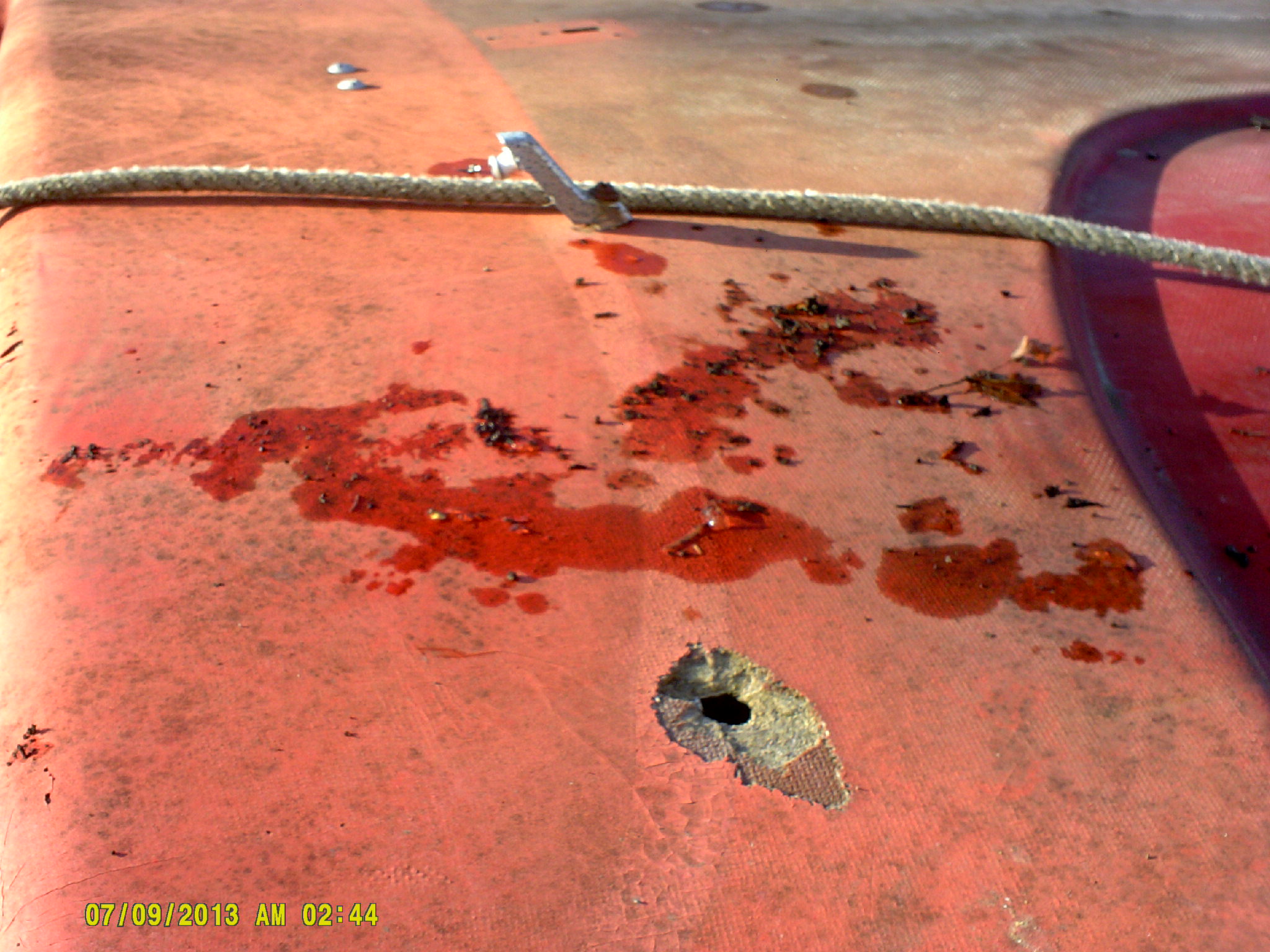

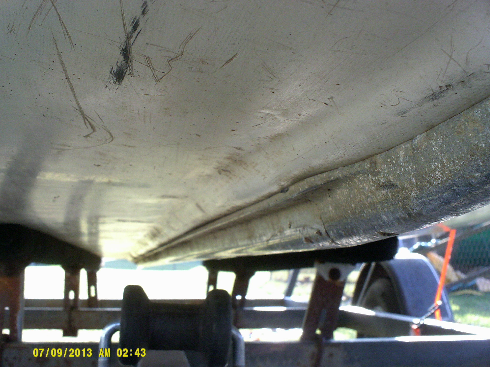

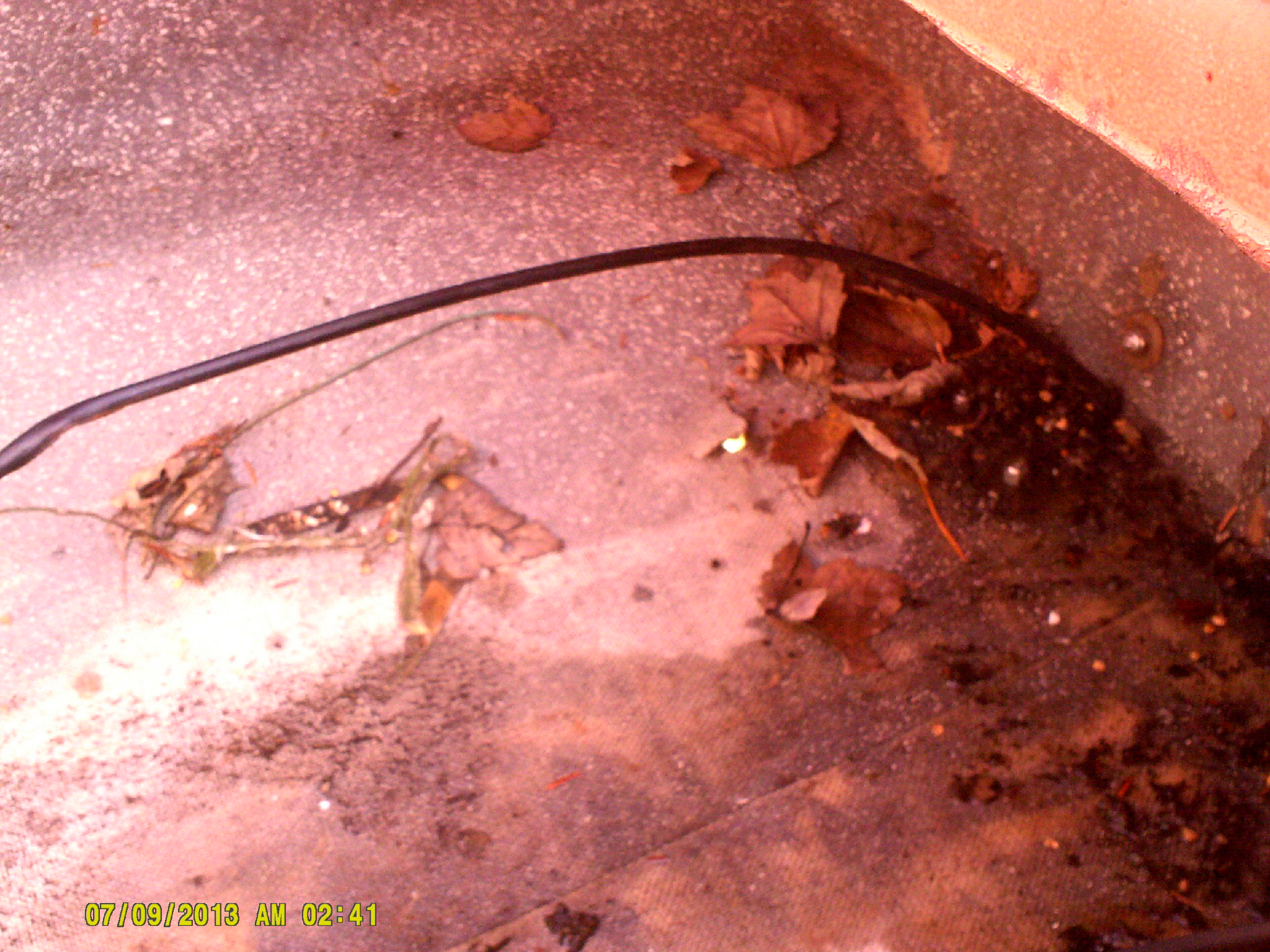

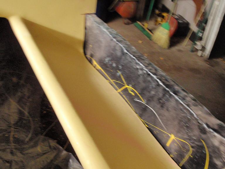

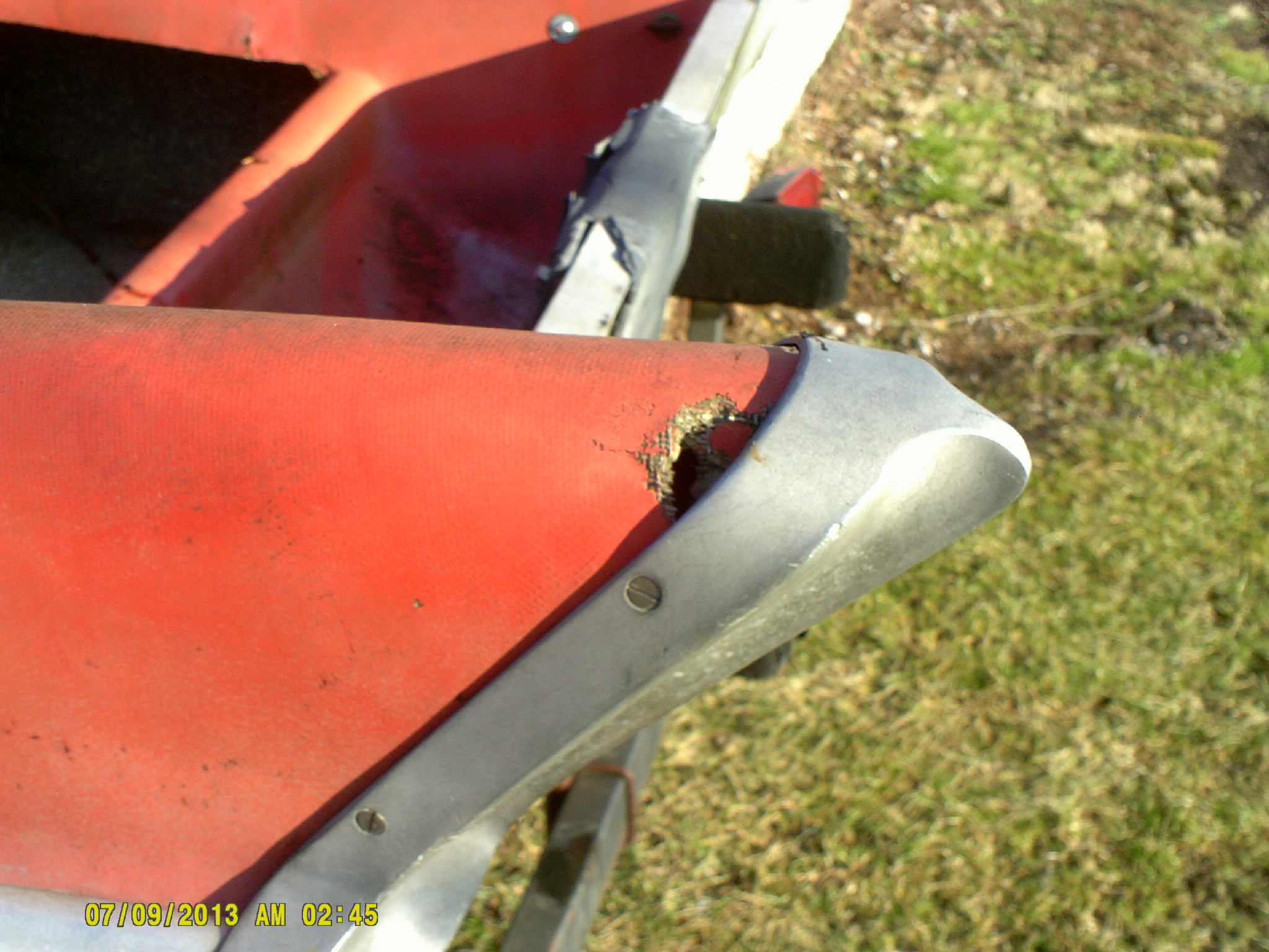

Hi Mark,
Here are some pics

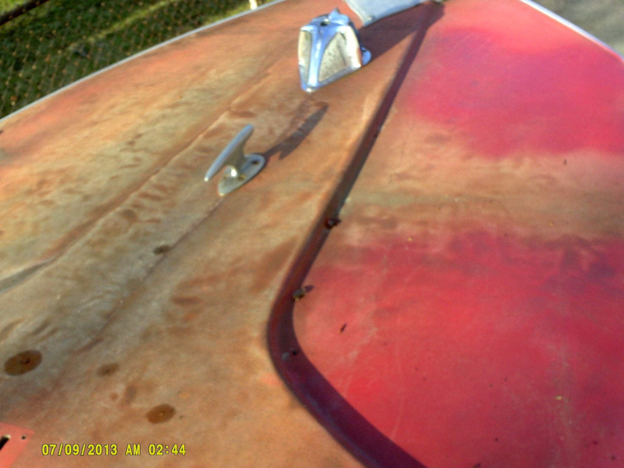

hole next to the leaves
hole from the bottom

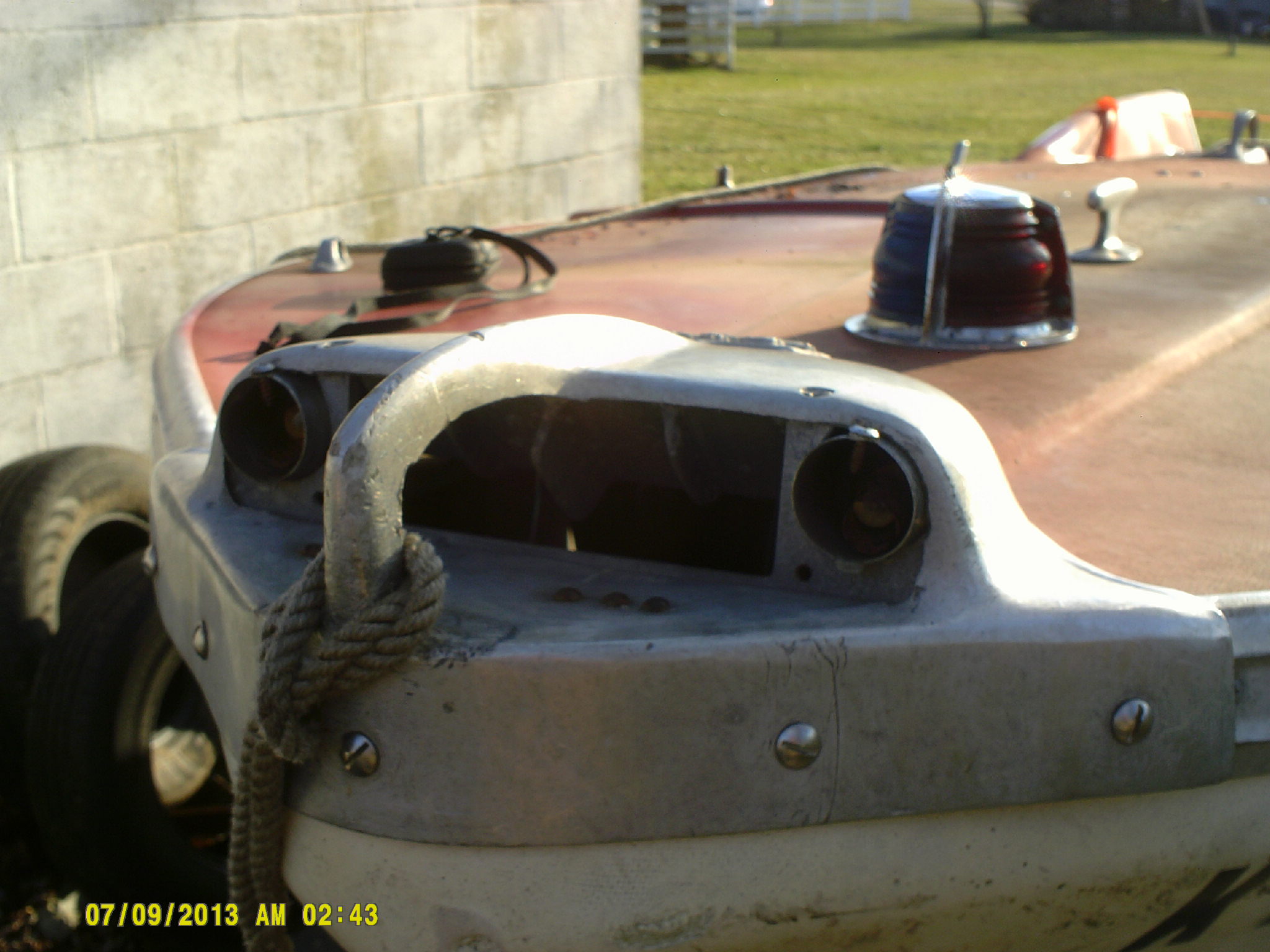

light sockets and looks like a flip vent ?
a spot under cracked under the fin cap

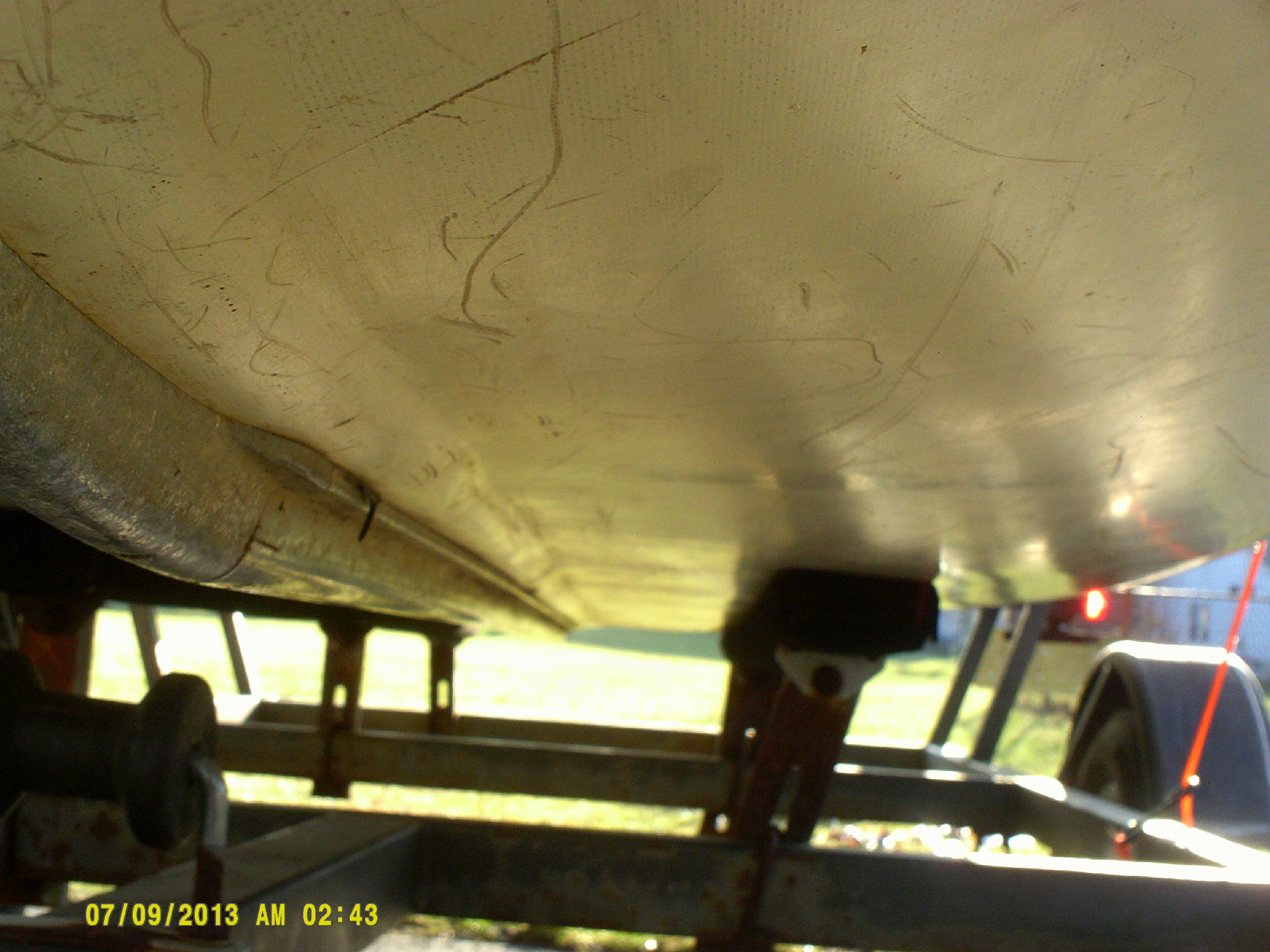

there are some foot long gouges in a few spots, but nothing thru.

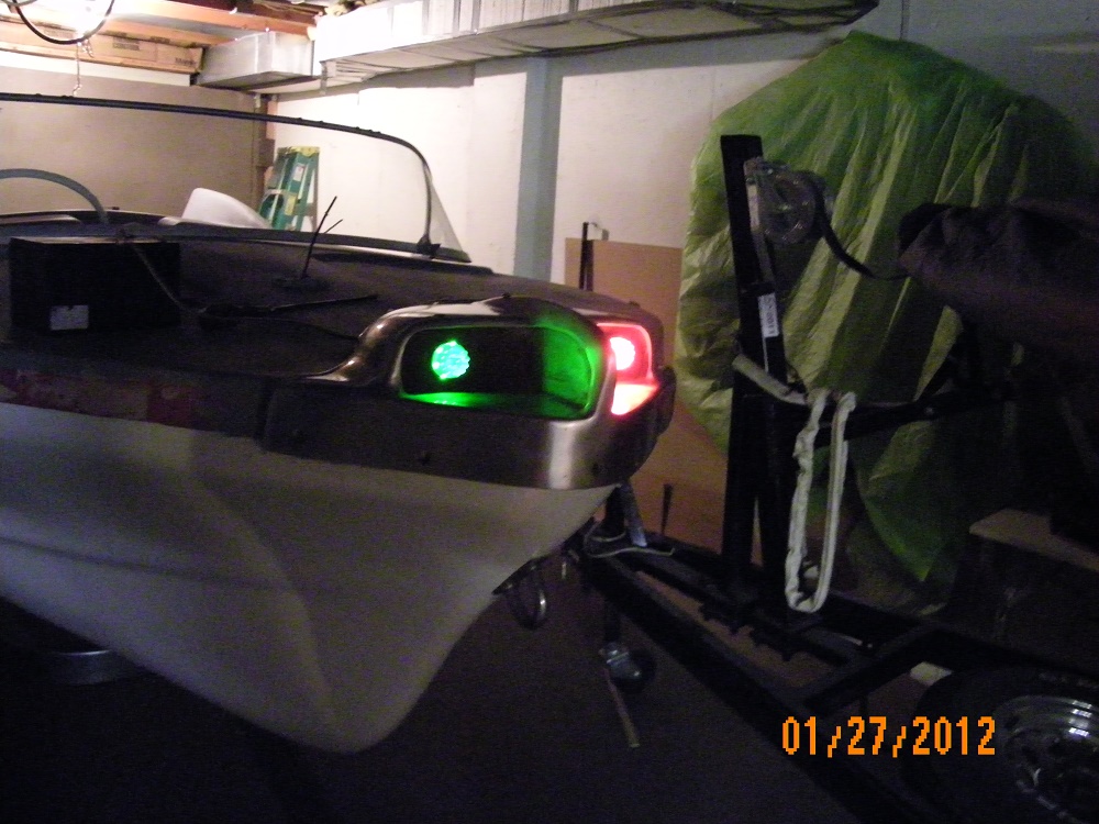

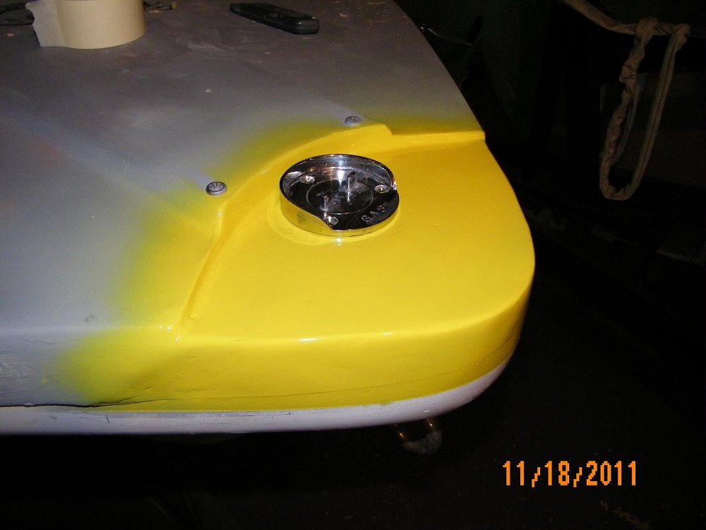

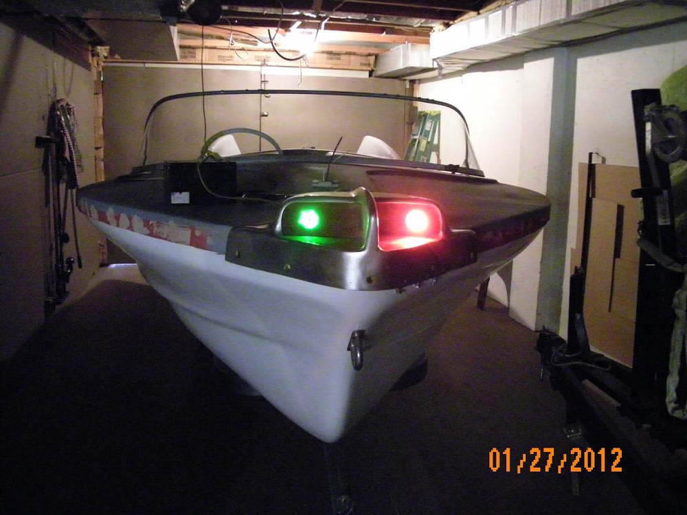

Here is what I did to the bow light(s)
First I added an onboard 12 gallon fuel tank under the bow and put the filler under the bow light, hinged it.
Picked up some LED nav lights from ebay, made up a mahogany fill piece where the vent was and installed the lights.
Re:Cosmic12 Flying fish 10 years 3 months ago #119232
I bought LED lights to put into my old lights. Worked great.

The pictures above are the highlights of any fiberglass damage. The deck will probably need some Chopped mat in spots to cover the cloth print that the weather exposed from year sitting in a field.

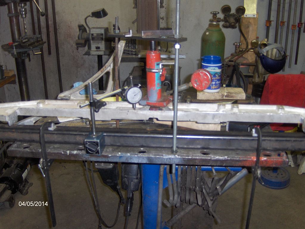

Cosmic 12,

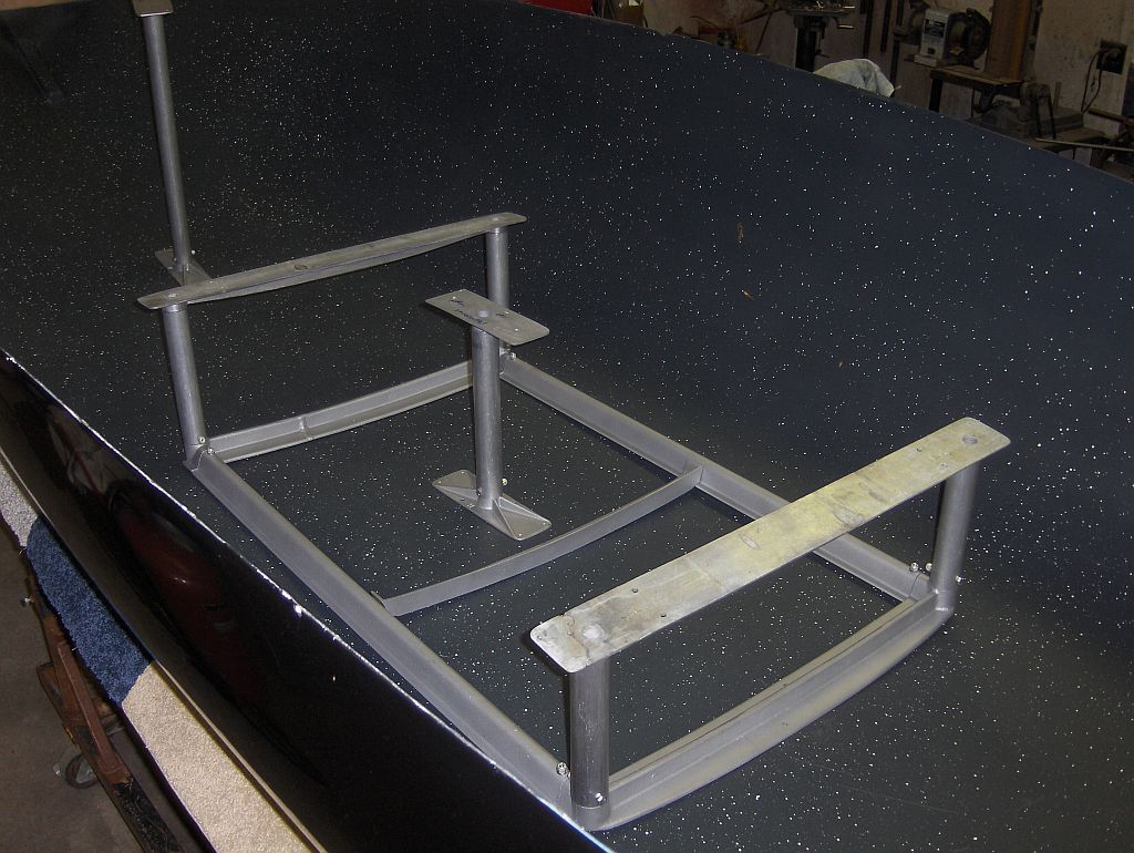

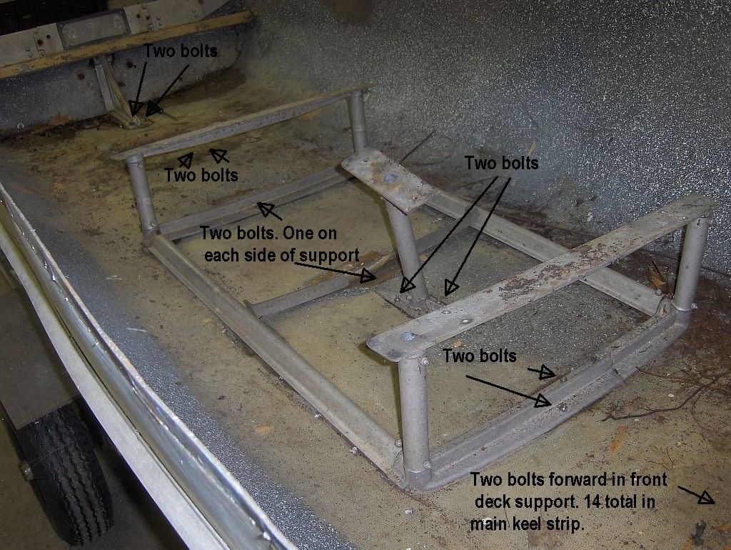

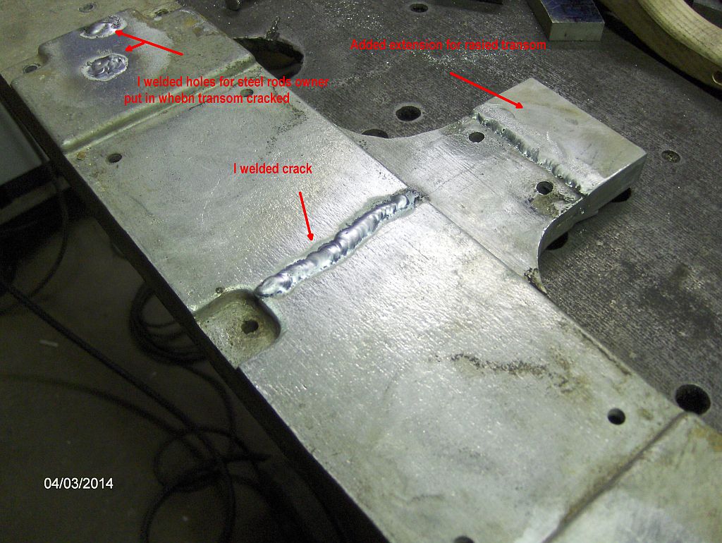

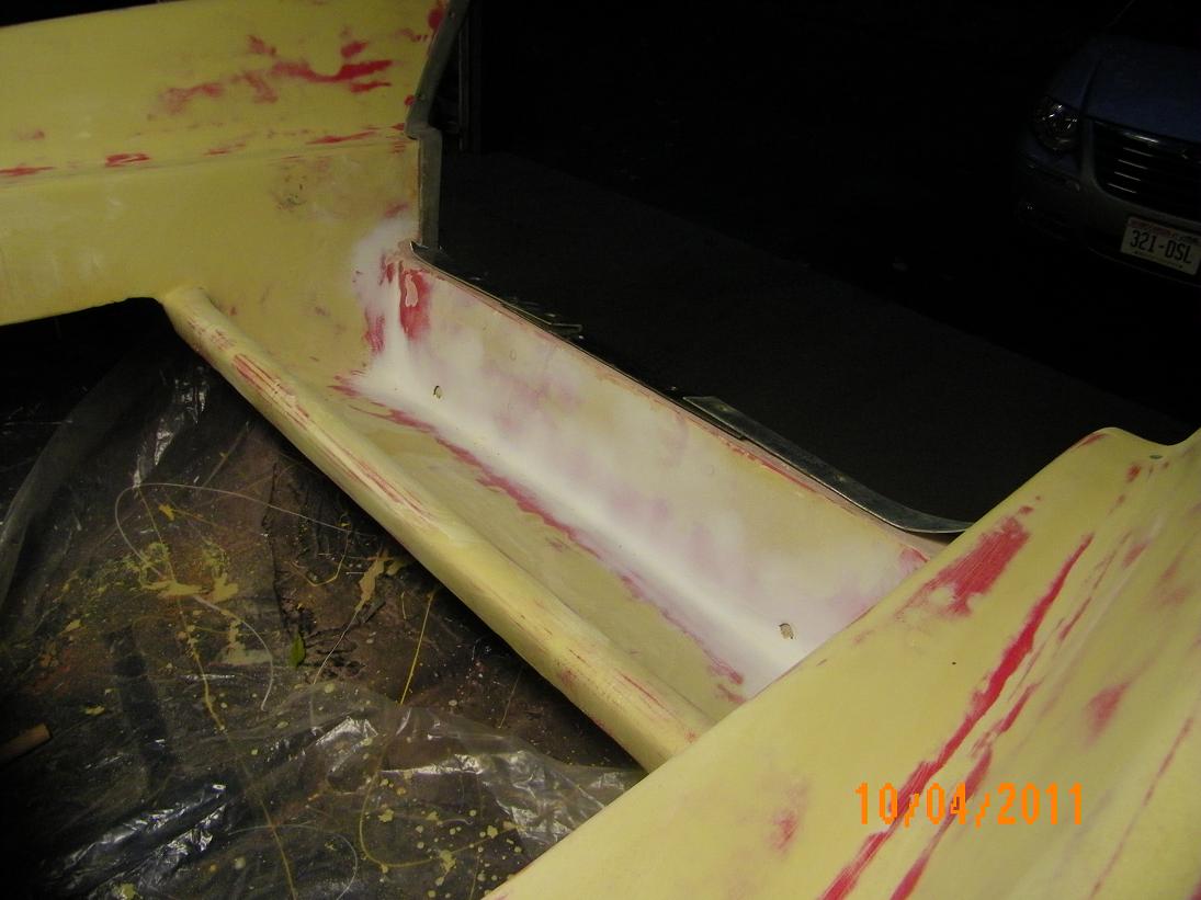

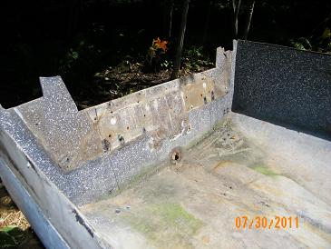

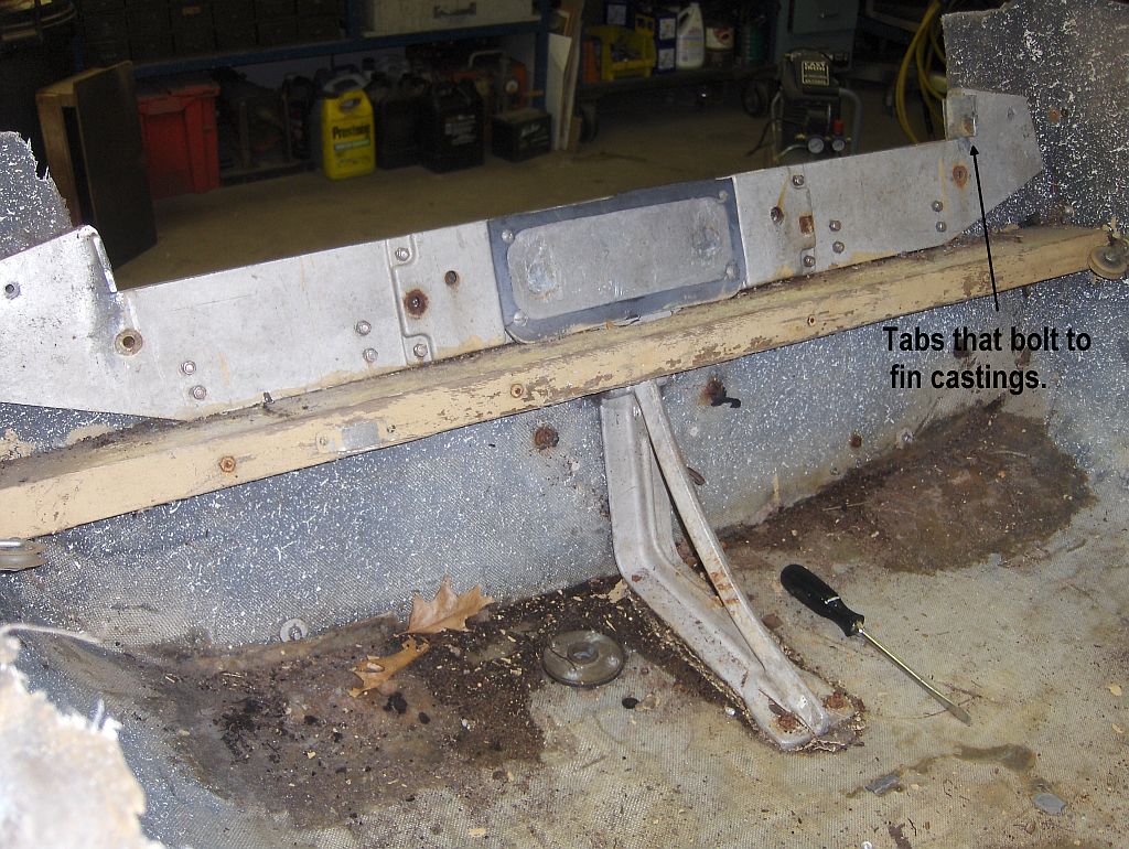

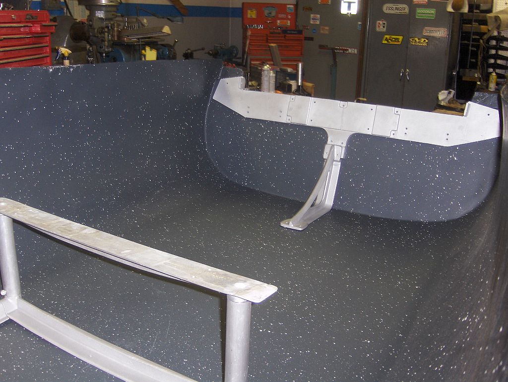

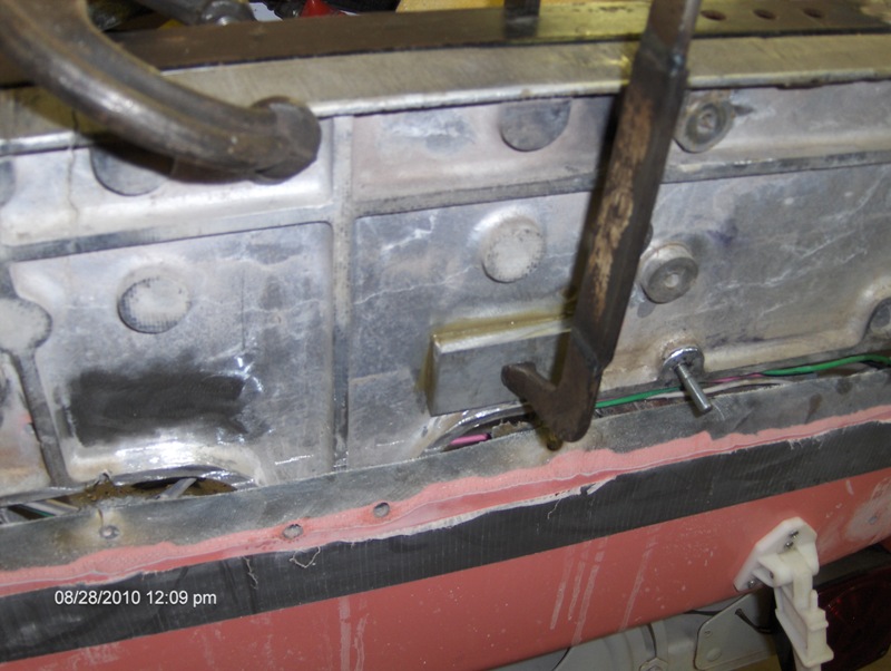

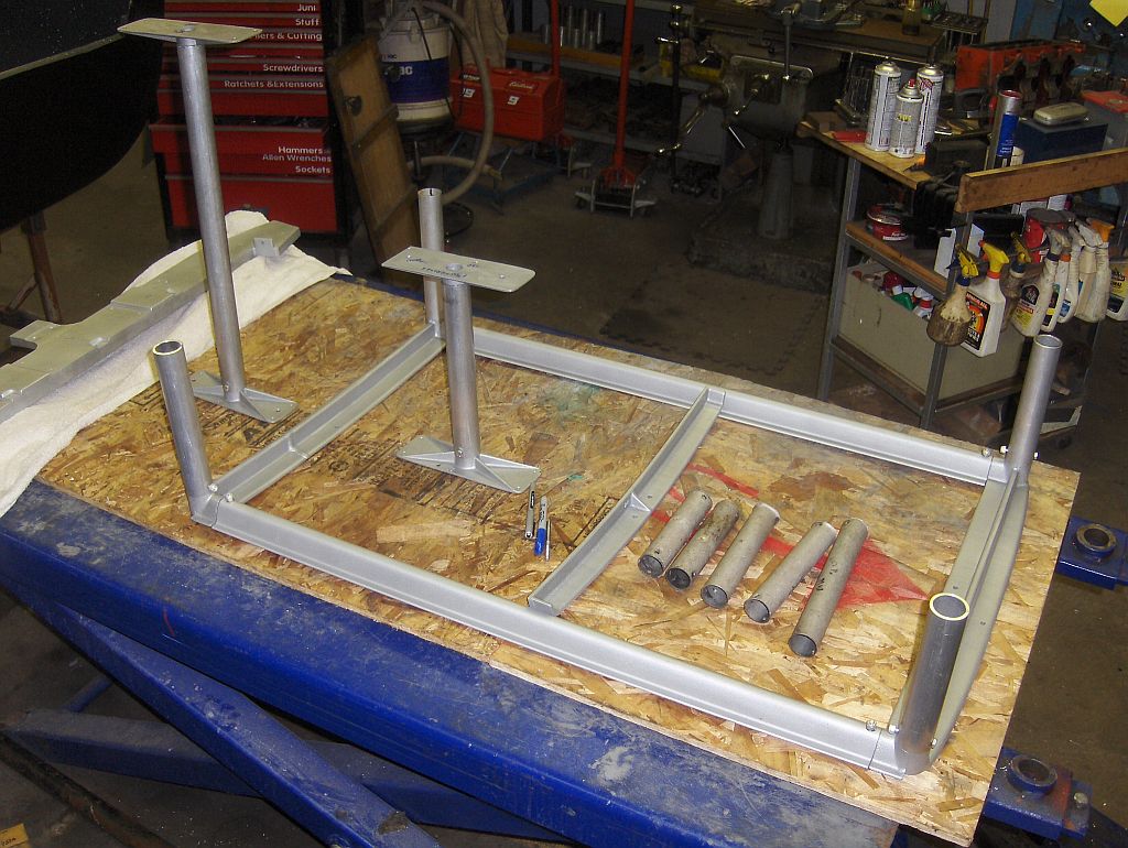

I’ve attached five photos that should help you to see how a Herters Flying Fish attaches the aluminum transom and support structure to fiberglass hull.
To make the boat rigid without any cored floor or stringers they used a heavy extruded aluminum external keel strip from the front to the back of the boat, together with an internal aluminum support structure. The support structure was on the inside and 14 stainless bolts made an aluminum sandwich with the two aluminum pieces and the fiberglass floor in between. Thin rubber washers sealed the bolts.
The aluminum avoided the rotting wood problem, but introduced a few new ones.
As the boats aged, and especially if they had heavy outboards and were used and abused for water skiing, wake jumping etc., they started to leak through the bolts used in the floor.
14 bolts to hold the keel and support structure, six more bolts held the aluminum transom protectors on, and four more in the floor drain flange. Add six more bolts for the keel fore-piece and you ended up with 40 holes through the floor. Leakage was inevitable.
Reassembling the boat using 5200 or 4200 and some care can usually keep them dry for moderate use after a rebuild.
Breakage of the aluminum castings has also occurred on many surviving Herters and many of them have deep gouges in the floor as the support structure loosened and started rubbing the fiberglass.
To keep a restored Herters dry requires a good job sealing the bolts and occasionally checking the tightness, or just say the hell with it and use a Scott Atwater outboard with Bail-amatic to keep it dry.
Photo 1 This is a typical 57 Herters transom before restoration and shows the PO modifications. Half-inch steel rods were run from the transom to the rear panel of the back seat through a 2 X 4 the PO glassed in. A 2 X 4 was also added below the transom and bolted through the fiberglass to add stiffness, and a number of through bolts were added to the transom. The crack is not visible in this photo because it’s under the motor vibration pad.
Note the knee brace. 56 and 57 Herters have this, but Herters removed it on 58 models, never to reappear again.
At the same time, they increased the width of the transom by about two inches. All transoms kept the extension for the knee brace even though it wasn’t used and you can fabricate a knee brace for yours or get lucky and find one.
The transom was simply bolted to the fiberglass forming the boat transom and had a number of 1/4 inch bolts going through it as well as being bolted to each fin casting.
Photo 2 This is an unrestored support structure. You can see the position of the 14 bolts and the fiberglass patches the Po used to stop leaks. This structure supports the front and rear seats and the floor of the pass-through, or looking at it from a different perspective; you could say the decks support the floor. Another pipe forward supports the front deck. You can see the cracked forward floor casting, and one end of the seat supports is broken off.
Photo 3 This shows the support system after restoration. You can now see the front deck/floor support post.
The original thin wall pipes are mushroomed over and I have replaced them with double wall pipes to prevent that in the future. The new ones aren’t cut to length yet, that will get done when the deck is refitted.
Photo 4 The restored support is being mocked up in the finished hull.
Photo 5 Restored transom is mocked up.
