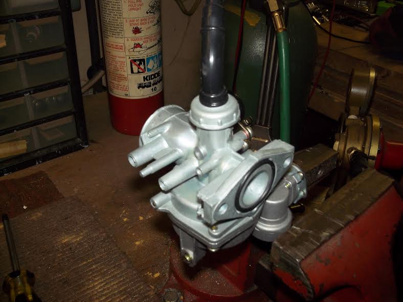

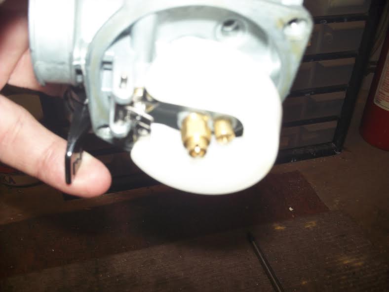

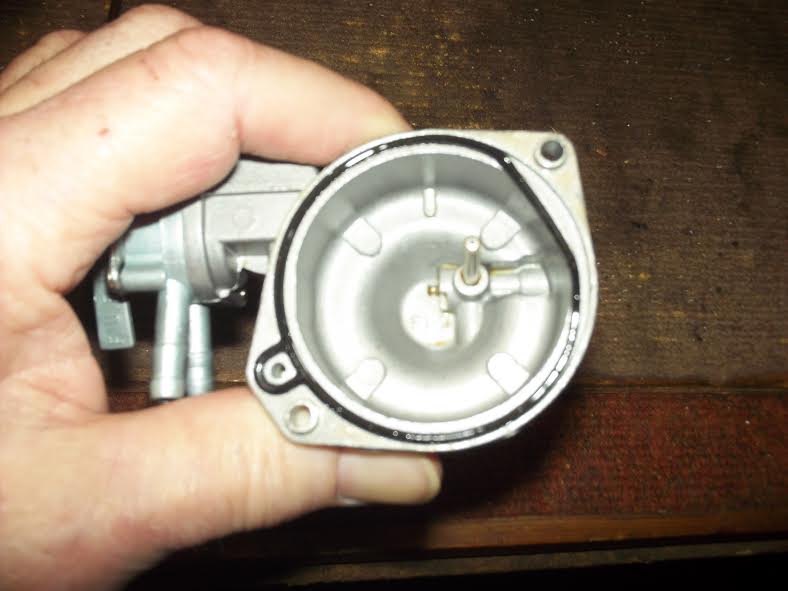

This was a new carb I bought for a CT70 Minitrail mine, and wrong intake bolt pattern. But I had to do a "test" "leaving gas in a carb 2 months turns to crap". Calling BS, and always did. I've never ran anything "gas out carbs" since the Minibike days 6 decades ago. Only if a good pickle and going into storage for years motors mine.
This gas was 10% ETH 40-1 2 stroke mix, with Stabil (red) and sat 3 months in the shed as used chain saws/blowers. Filled the bowl the new carb it and let it sit on the bench 9 more months. I'm still hearing stories about "ETH yellow snot" as tried that too and never showed. Now clue me that and if a story?.. bring it on.
Anyway M/T thought gas, but gone. Little lingering fresh gas smell,zero film the float as the bowl. I could sell it tomorrow as "new" Pix say it all........
Re:Gas left in carb a year test done.. 10 years 9 months ago #119001
Your carburetor doesn't reflect the actual usage conditions that would impact most power equipment.
The part was brand new. It never had to process fuel that could have had some water or crud in it.
The new carb probably was manufactured with rubber designed for modern alcohol laden fuels
The alloy used for the body may even be corrosion resistant
Most equipment gets stored outdoors (covered or uncovered) where it is exposed to humidity and wide temperature swings
Your carb had the openings exposed to the air - so the fuel in it could readily evaporate out of it - before souring
The oil and StaBil in the fuel don't reflect the stuff that runs straight gas and stored without a fuel preservative.

"The part was brand new. It never had to process fuel that could have had some water or crud in it."
THAT WAS THE POINT TEST! AND it WAS YEAR OLD GAS!
I under stand that. But thats those using bad gas and no filter much less maintenance as careless. I'm simple talking good gas will not harm a carb bowl and turn to crud in 2 months...

BTW I expect the results on the carb wouldn't have been quite so good if ethanol-laced fuel was used. But it'd be a shame to mess up that purty new carb! :P

That looks like a carb that would fit my 1980 Yamahatchi 250cc Exciter cycle. Haven't run it since '10 but never had a problem lettin' it sit for years with a full tank (non ethanol reg gas)

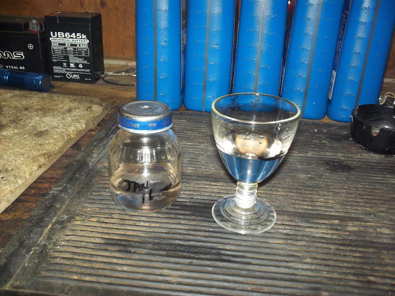

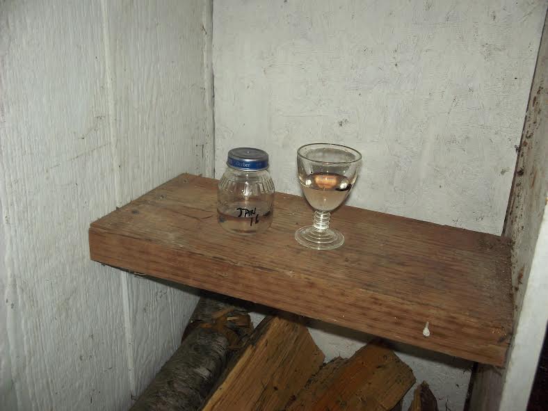

Anyway, doing a new "mad science off season now test" Baby food jar with that same old stabbed gas a year ago, ETH mix, 40-1 oil in it. Stabbed a hole/vent in the top and set out outside, ALONG with a open glass same. Let ya all know when I find something.

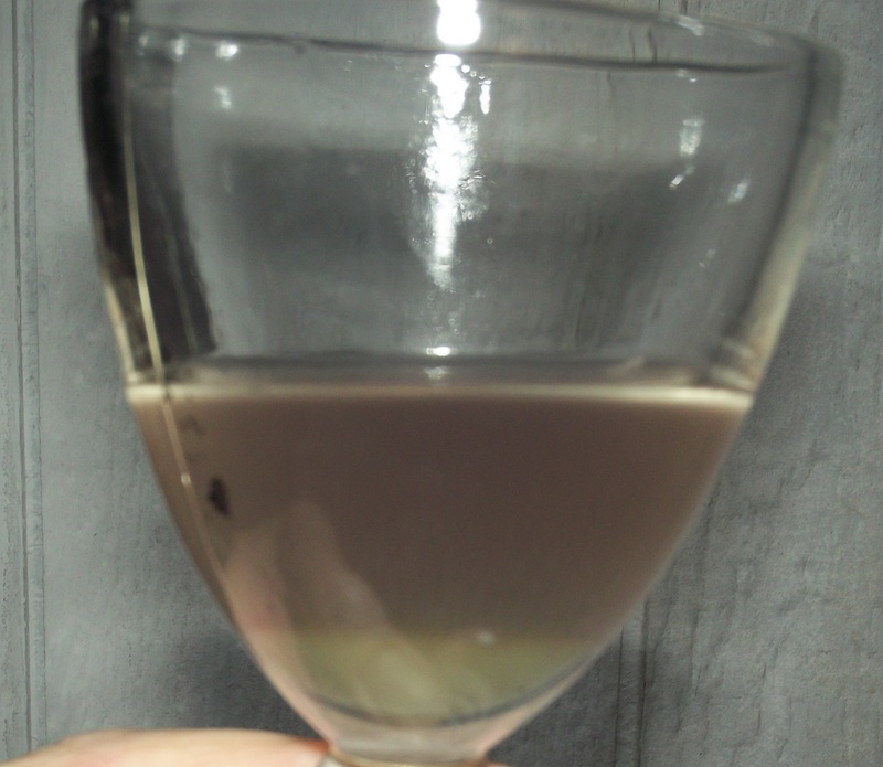

Gas in the glass is half gone, and looks like some separation on the bottom. Been drizzling all night and maybe picking up moisture. I'll know more tomorrow...

OK...results. Nothing yet the vented baby food jar, but the open glass? Sucking water up fast! I just refilled it now third time and going to let that evap and see what ends up there. Heres a pic...
Re:Gas left in carb a year test done.. 10 years 9 months ago #119074
That's ugly....
