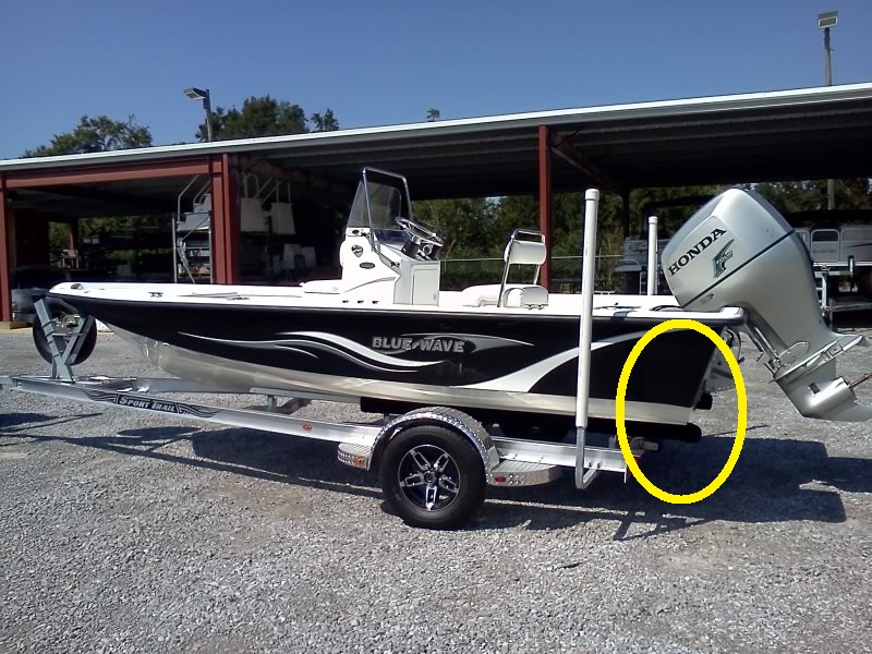

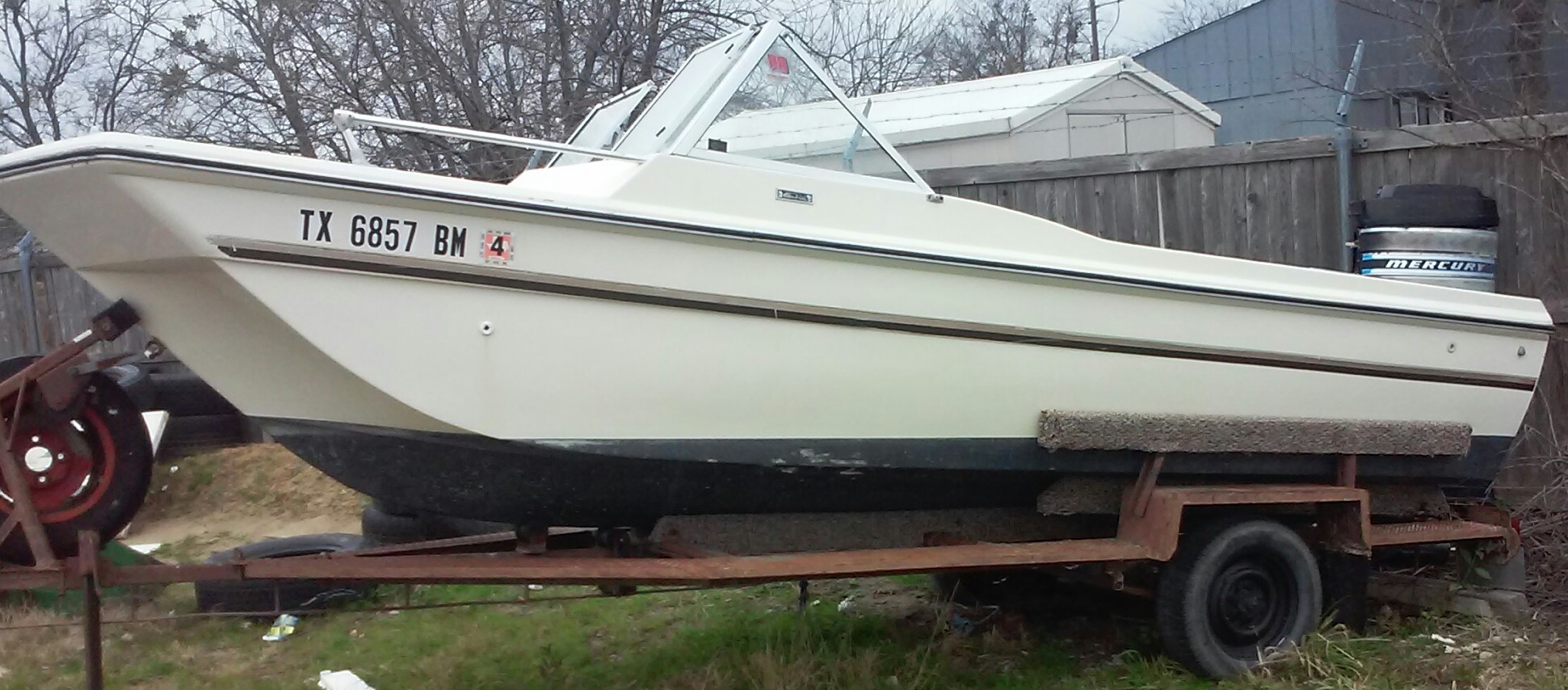

Is there any way you could post a picture of the boat/trailer?
You have to be careful not to move the boat back too far on the trailer, you don't want the transom hanging over the bunks or rollers. Ideally the bunks should be several inches past the transom for support.

Joe

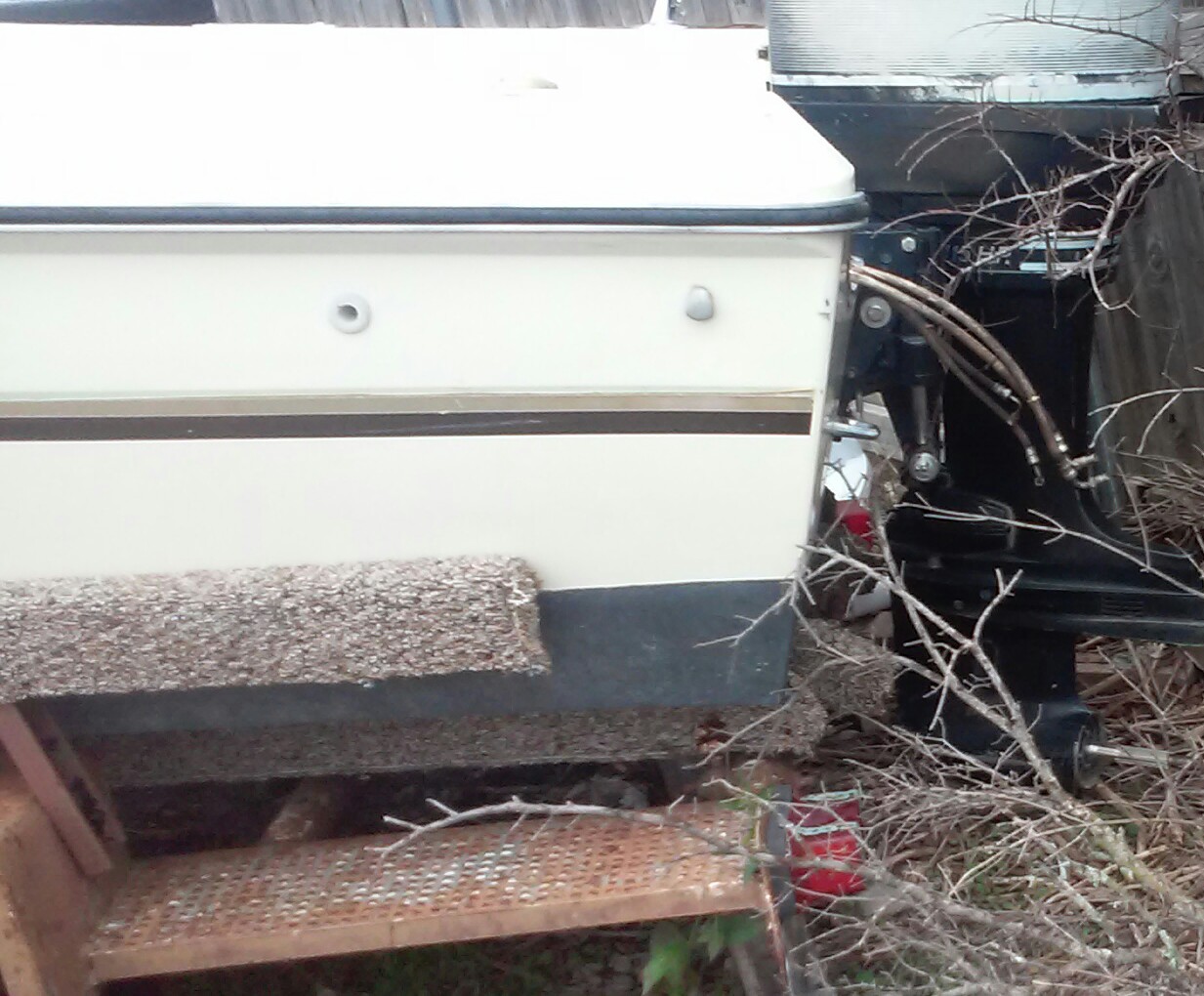

Here is the boat on the trailer, doesn't look like I can move the boat back any, as any further the transom would be hanging off the bunks.

...so install longer bunks.

I installed the longer bunks as suggested. Worked great. I always want bunks to extend beyond transom for better support. I have towed with my uni-body 1981 318 smog Mopar for 35 years and over 20,000 miles...car has 127,000 on it. My trips used to be 400 miles one way often 3-5 times per year. I presently tow a 20' Hydrostream Voyager (about 950 pounds) with a 2.4 liter 200 V6 merc (likely mid 300's) and trailer weight...so maybe about 1500-1600 pounds? I have a factory class 2 hitch with 2" ball...been on since car was one week old. This is the 4th family boat to tow (been towing this one for 19 years). I win NO drag races, but the mid-size (now as big as full size) tows steady, stops good...just NO pulling out and passing like my Dad could do with the 440 Super Commando Big Block Torque Monster. I always keep quality tread safe tires and keep breaks in good check. A slime covered concrete launch could be tricky...but if you have a well built boat stop, you could always "motor assist" on the way out (but I didn't say that...Dirty Harry always said "a good man knows his limitations" lol). Your '65 should easily out-pull mine!

Not really. You can jack the boat up on one side and replace the bunks one at a time. When done, tie or chain the rear of the boat to a tree and have someone pull the trailer forward slowly in order to re-position the boat further back on the trailer. Have one foot on the gas and one ready to mash the brake. Sometimes the boat can be stubborn getting started so you don't want to suddenly pull the trailer out from under it...which is why you should set the length of the winch hook to the bow eye to stop at where you think you want it, just in case. I've actually done this several times. No problems.
