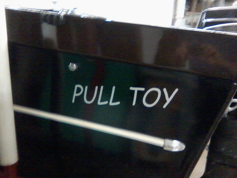

Nice!! Good bargain too. I see the 50 has a generator also, sweet find. You might want to change those two drive belts though. I got stuck/stranded out in deep water when the belt on my distributor parted ways, had to be towed in....hence the name on my boat "pull toy"
