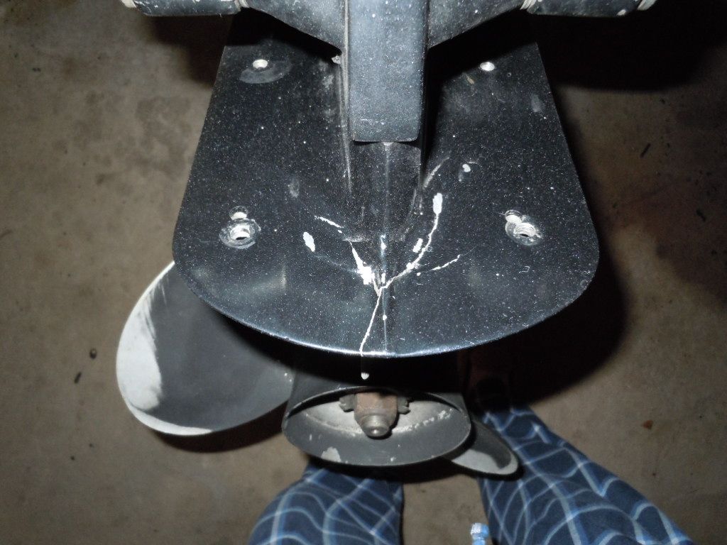

I HAVE used JB weld to repair the holes in the outboard AV(or cavitation) plate from one of those "whale tails", worked pretty good for that. :)

I have used JB Weld to glue things together, cowls etc and like you Mark I've filled those cavitation plate holes, works good for that but I've never seen it slatherd on like this. Maybe I can find a picture of it. That stuff is as hard as nails.

Cal,I know from experience, it's no fun fixing someone else's goof ups. Mark, Been thinking about getting some of those holes welded up someone drilled in the cavi plate on my I/O for a stingray fin I removed. Sounds like the JB might be the ticket. Thanks

Yeah I have some holes in the 80hp from a fin also. forgot about the JB weld to fill them, thanks.
