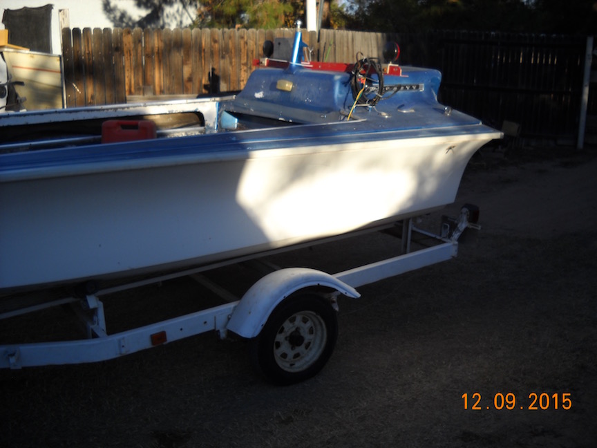

Hello,
I came across a Flying Scott in used condition at least. Seems solid and has a 90 HP MeteorII Johnson. The motor checks out as a 1965 and the boat was presented as such. My ? for now is where did these beauties hide the data plate, or HIN?
Thanks , Malcat

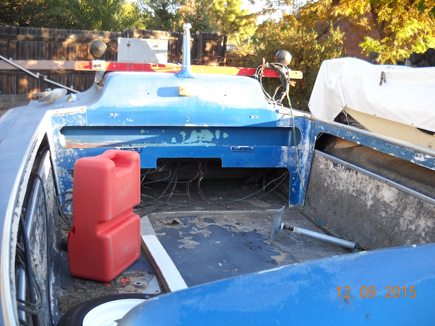

Re: Flying Scott 10 years 8 months ago #117982

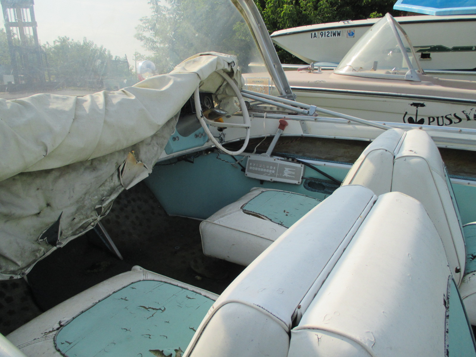

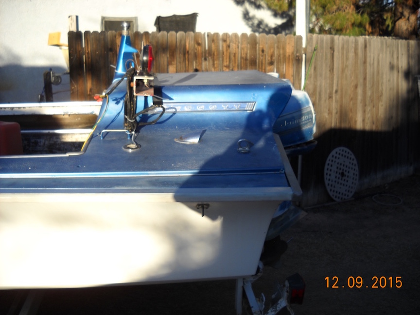

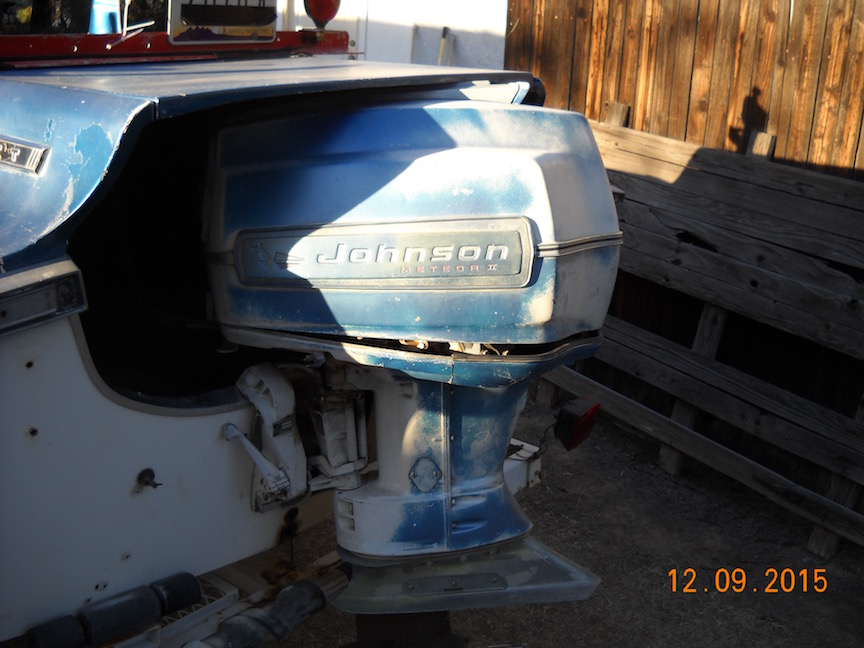

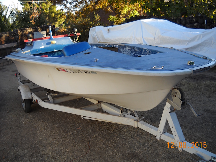

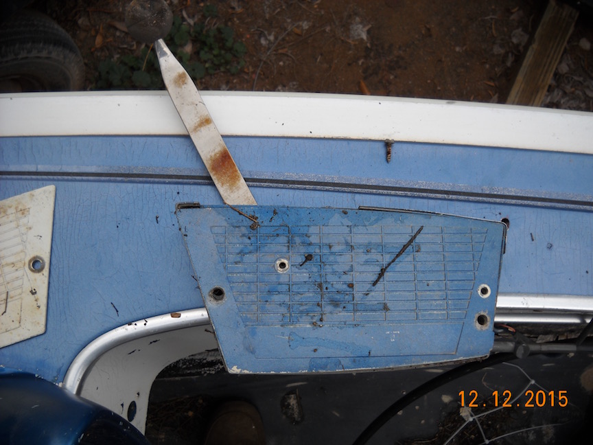

I'll post some pix. It is different,seems pretty solid though neglected. The gent who had it protected it by storing alot of ,,,,,,treasure in it. He claimed he drained every time it rained , and the deck seems solid.
Ignore the red "light bar" across the motor hood. That is my fail safe for trailer lights as those rarely work.
I rolled home in a state of meditation as the tires were very questionable. I did buy a spare at HF , so I beat the odds on the interstate, slid into home "safe"!

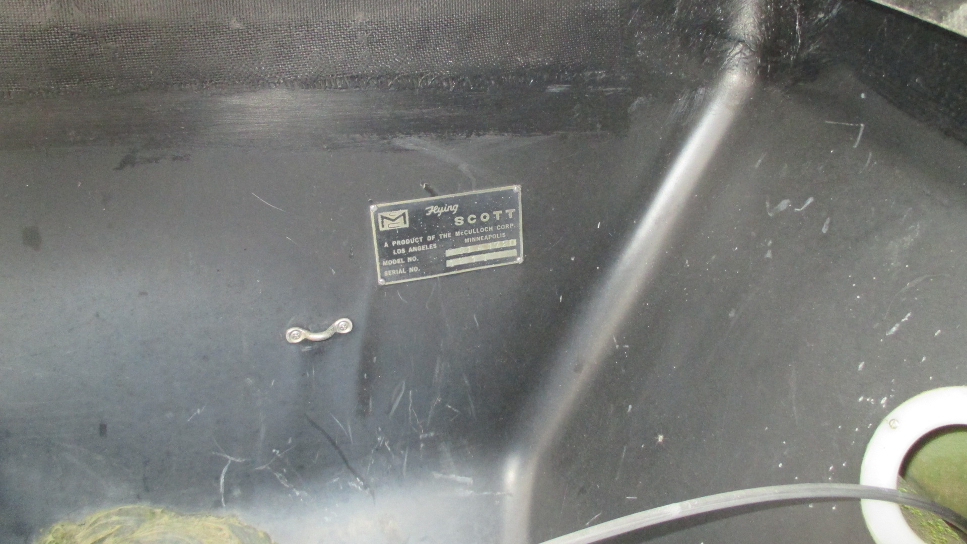

Also as jbcurt00 said , the data plate is in the motor well. I didn't get my head squeezed in there yet, but FWIW, it's in there.
The 90 HP MeteorII seems "free" to spin at the flywheel, but the control package is in many pieces so I have little hope of that assembly coming back to life.
oh, well. Tomorrow is another day.

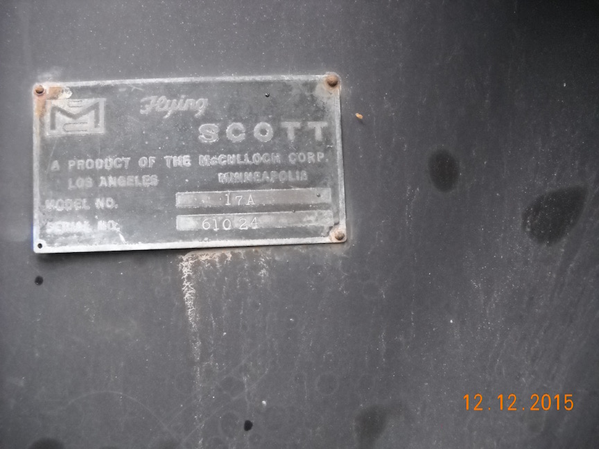

Re:Flying Scott 10 years 8 months ago #117994

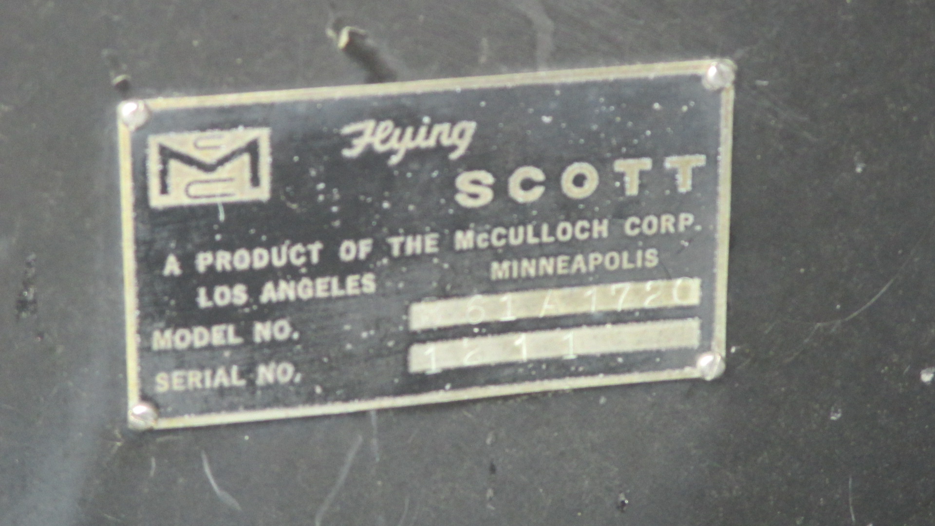

Your boat is a 1962 for sure. Its the only year they had the hard fiberglass motor well cover. The ID tag is located in the motor well on the left side and looks like this. These are pictures of my 17D Scott Boat. I do have this up for sale and its a solid boat but no one seems to be interested in scott boats anymore. I thought $800 was a fair price because the boat is water worthy and the trailer is nice too. I figured $500 for the boat and $300 for the trailer. If it don't go soon its fate is getting scrapped and sell off the parts off the boat and sell the trailer. Not how I wanted to see this go. My goal was to keep these old girls out of the land fill. But I need to down size bad.
Malcat, I am sure I have a control for that motor so contact me if thats what your going to run. I have one short shaft scott left too if you interested in that. Hard to find the wire harness for those is all.

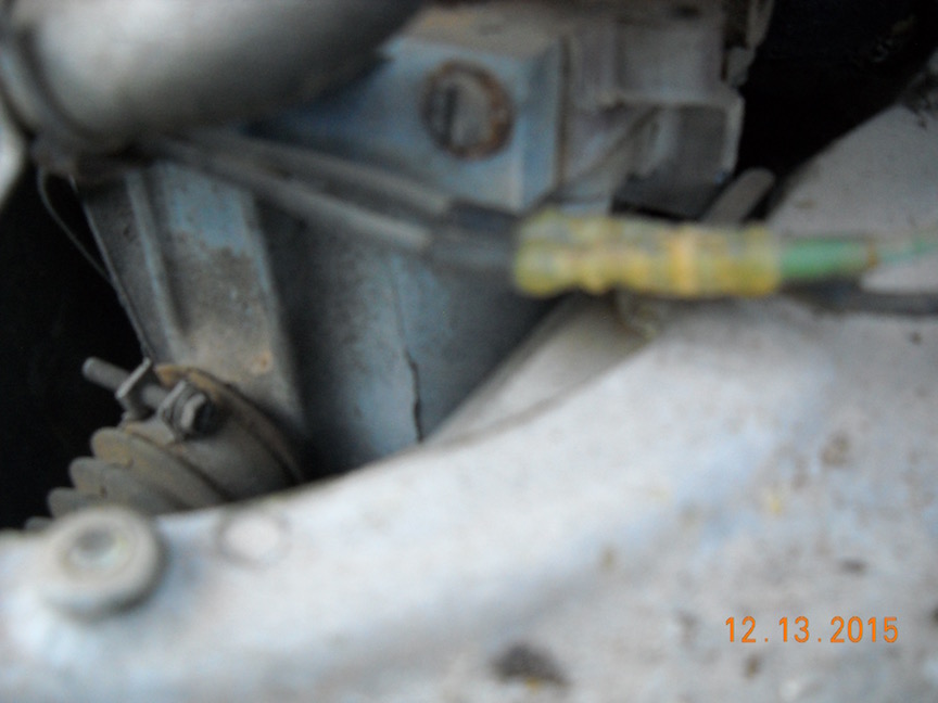

Thanks Minnesota. If you have a usable controller that would be a giant step in the right direction. I would like to use the Meteor II mostly just because it is there. It has sat for some time, but it's had a hood over it!
I worked my head in there and also got a pic.
MN 17 A
SN 61024
Not sure how that reads compared to yours, but that's what I have .
Re:Flying Scott 10 years 8 months ago #118000
Malcat,
Well it was made in 61 so its a 62 and yours is the standard model and mine is the deluxe. Not much difference in them really. More creature comforts. Post a Pic of your controls please. There are 2 it could be. One is push button and the other a single lever control.

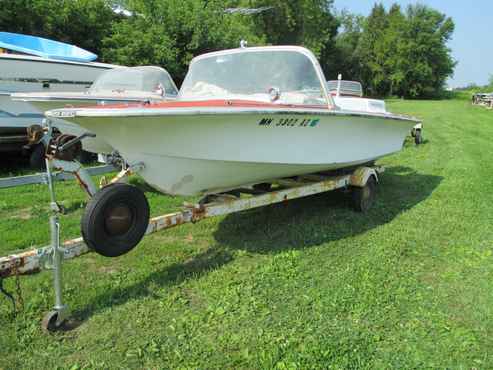

Redneck so ya want to see boats huh. Well here is the stats for ya. at our peak we had 120+ 50 in the museum and 70 projects. Sold off over 50 in 3 years after closing the museum and want to off another 20 or more. Engines well there was over 200 here and that is down to about 100 give or take. Lots of parts motors so they are all going to ebay. Well here is some of the most resent pics I took of the back row. Not counting my collection of boats that I will never sell. I have about 30ish that will stay with me. At any given time we have 50+ boats here either owned by us or customers stuff.

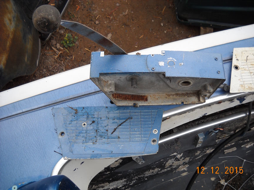

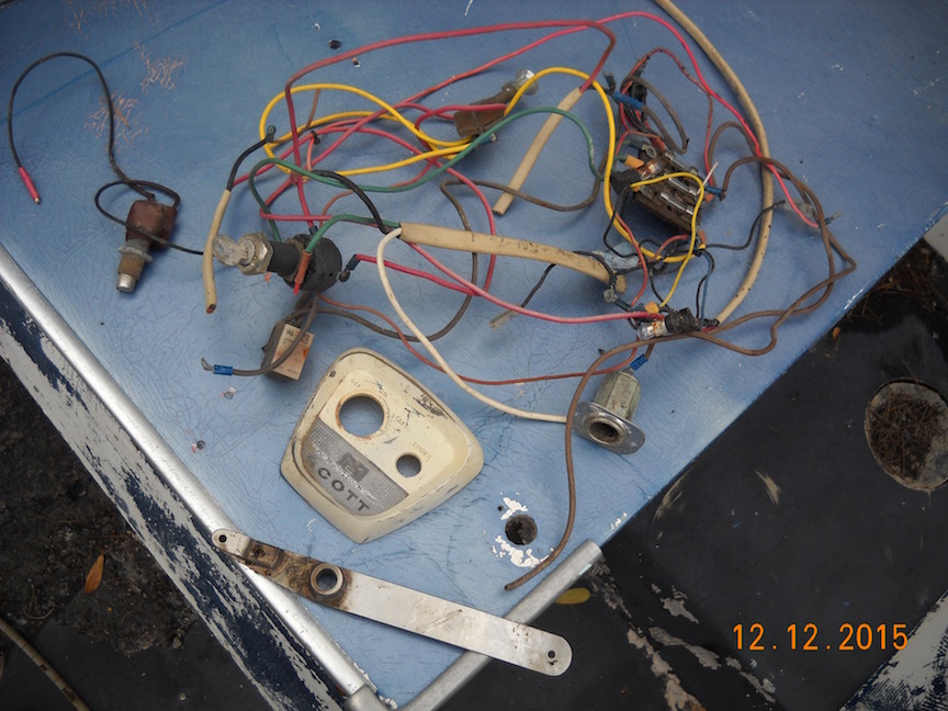

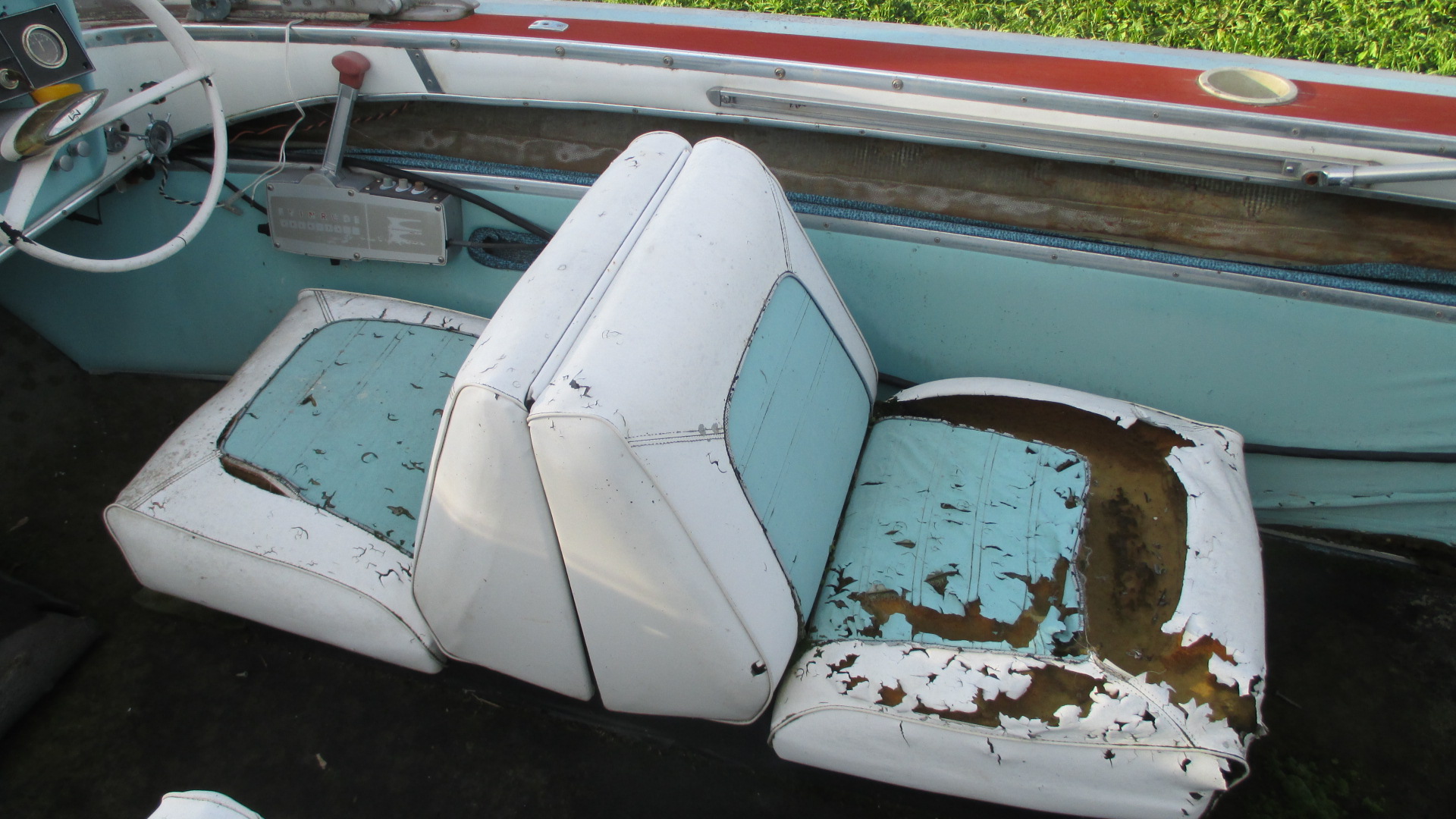

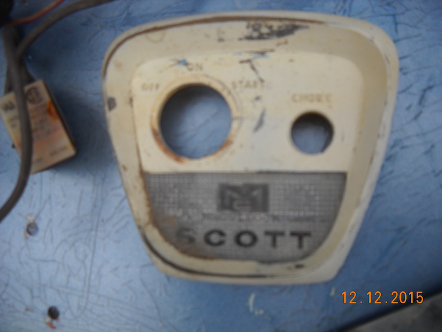

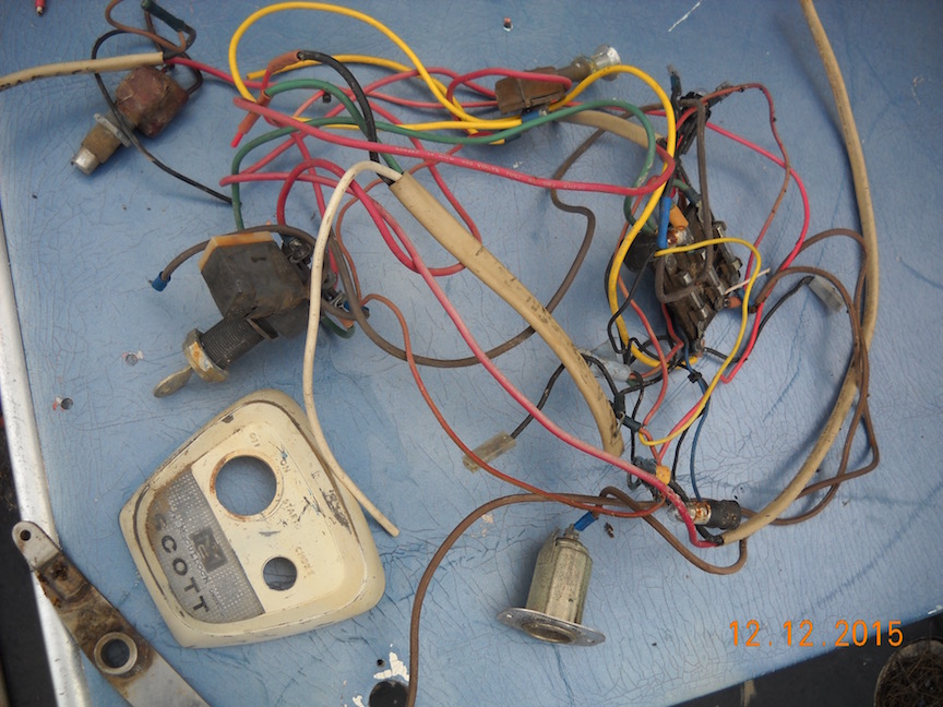

Minnesota,I'll post some pix of the control, although it is in many pieces, but you will likely know what to look for. It seems not to have the 3 buttons like is on my "72" 85HP Starflite, but hard to say what might be missing.
Thanks for the help!

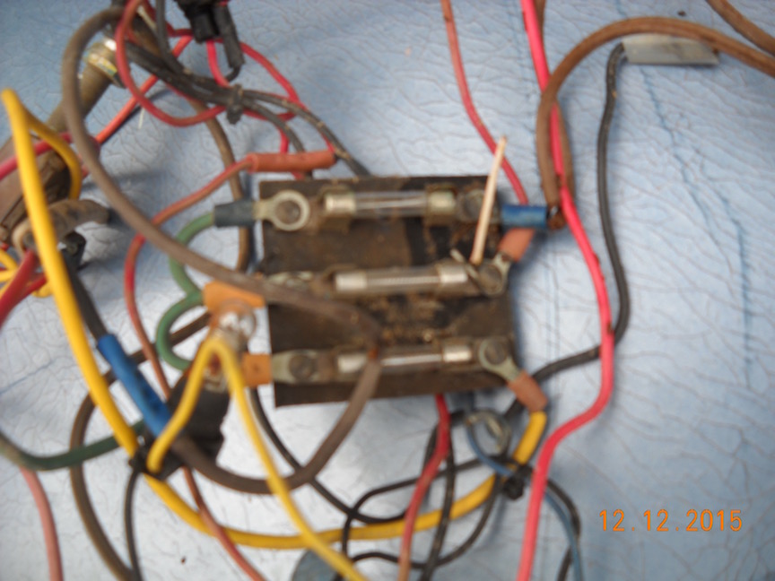

So it looks like there was a key switch, a choke, and a horn , and cigar lighter.
That fuse block with the 3 fuses makes me think there may be a 3 button "selectric" type shifter that has been trashed or may be back in the stern yet. I haven't done the phase one "dung out" yet on the Flying Scott.

First off the control you have is a scott control and somewhat rare so put that aside and the ignition dash plate is rare too so stash that too. Your missing about all the shift side to that scott control so again just put it aside. The ignition switch is early chrysler so that aint gonna work either. Ruffly what some one did was try to cobble the scott control to work with the johnson. NOT gonna happen. Here are pics of what you need to get. Provided the wireharness for the johnson is not butchered. See picture. Now you need to look at the harness that comes from the motor switch box. You should have a harness that goes from the motor to the box and another that goes to the front of the boat. IF you have neither then you got issues up the wazoo lol. IF you post pictures of what is coming out of the motor and what harness is in the boat back by the motor I can figure out what you need. I am guessing everything. Here is one of the correct controls for that motor. Remember there are 2 styles that will work with it. This is the push button type.

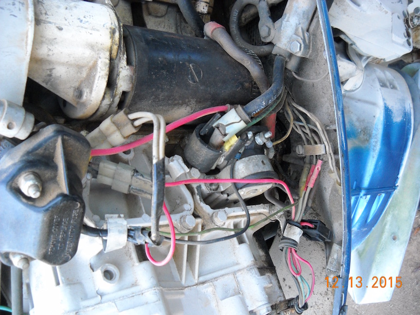

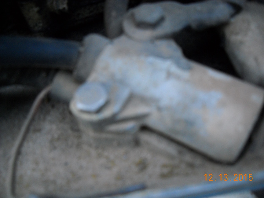

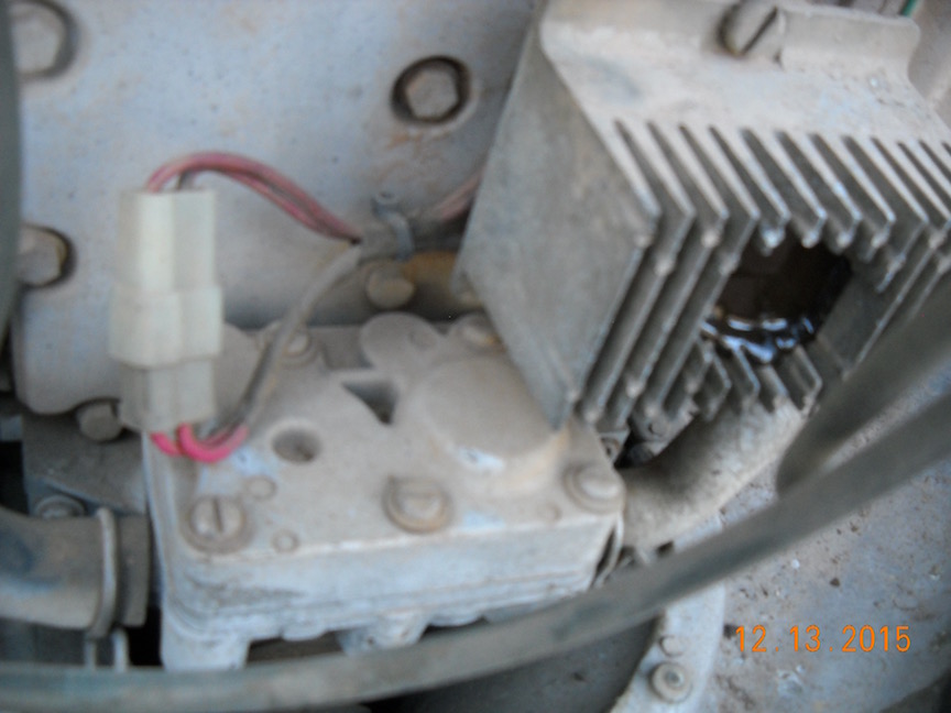

Re:Flying Scott 10 years 8 months ago #118012

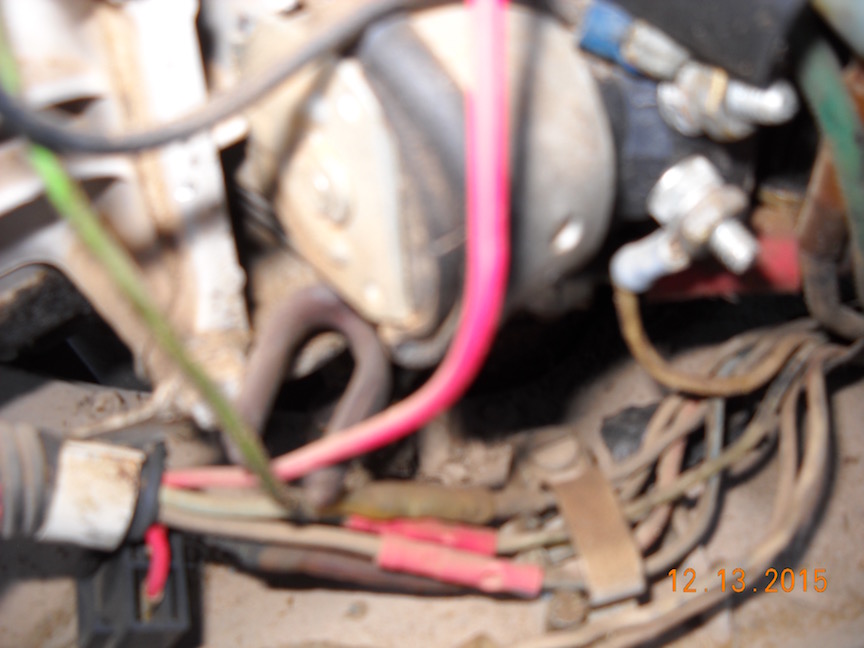

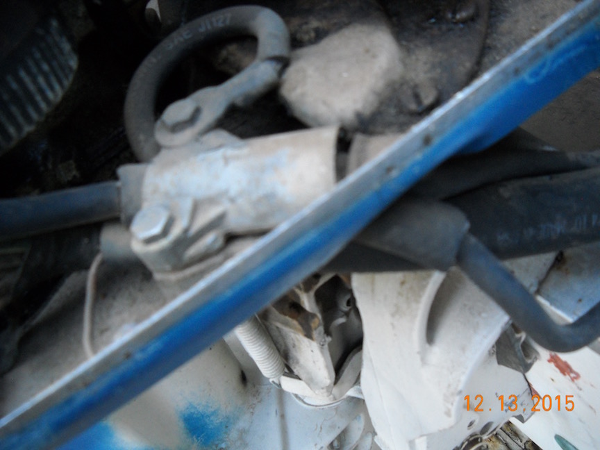

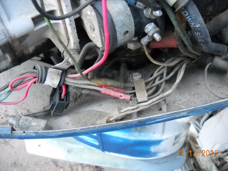

I'll have to get out and shoot some pix in the AM and see what it's like , harness to motor.
I almost bet it's OEM and some one tried rig as you suggest.
The Johnson Meteor II is # V4 ML-11c, which I believe is a 1965 unit, so the OEM engine must have gotten trashed early on and the Johnson put on. ? All guess work now, but thanks for your help and knowledge and I will try to fill in some blanks with pix and see what makes sense.
Thanks again,
malcat
Re:Flying Scott 10 years 8 months ago #118025

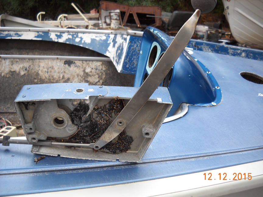

Minnesota, I added a number of pix, some better than others, but it all more or less makes sense.
The right controller would be so nice.
Thanks,
Malcat

Re:Flying Scott 10 years 8 months ago #118054
Ok Malcat I see some of the wires have been spliced and for the most part that is ok. Next is to follow the motor harness into the boat and this should go to a large box. Open up the box and get a picture of that so I can see what they did if anything. Next the wires leaving going forward is next. I am looking for where they chopped up the wire harness. There are 3 wires that control forward, neutral and reverse that should have a connector as well but this will be at the front of the boat. My fear is that they butchered the harness at the box. I hope not. IF they did it up front thats ok well its not ok but the forward harness can be replaced and the correct control installed. Before we go any further does the motor turn over and if so get a compression test done. No point fixing this if the motor is a turd. But the good news is I have a 85hp on my scott that is for sale for $500 and comes with everything. Lets see how the comp test comes back first.

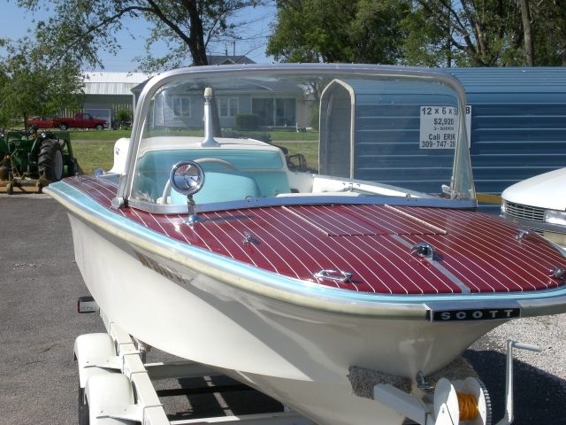

The SCOTT boats and display belongs to Todd Smetts,the runabout was mine ,I sold it to him last year,,great boat but not weird enough and I needed room.that boat is completely original and I was told it was only used 10 times or less, the trailer was repainted,but it is better than pics,it is a great scott display,Bill

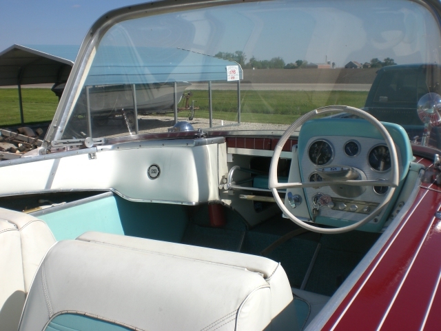

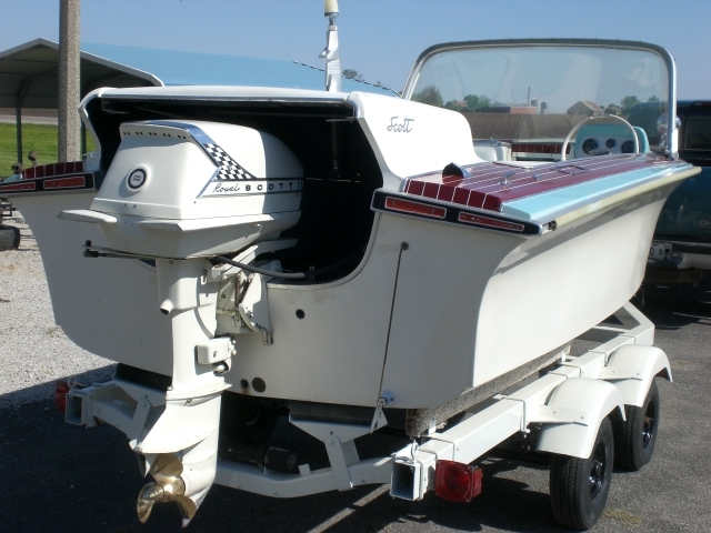

Here is a pic of my 15ft Scott, totally original except we did the vinyl deck,Bill

Bill - regarding the pictures you added...WOW, WOW! love this scott cowl feature, walkthrough/tip windshield, tandem trailer...I could look at that all day!

Re:Flying Scott 10 years 8 months ago #118080
Minnesota,
Just for the record, I find NO box, such as a relay box or whatever you suggested might be there. Just cut and hacked wiring. The motor does turn by hand by flywheel, but I didn't dig deeper, as the weather is wet and cold ( for us ) but I should have a chance to get some compression # this week.
As always, thanks to all for the help and pretty pictures. I appreciate and enjoy it all.
later, malcat

Re:Flying Scott 10 years 8 months ago #118088
  • Jim L
  • Jim L's Avatar
  • Posts: 1426
  • Karma: 60
malcat wrote:
Minnesota,
later, malcat
65 moddels didn't have the box. The voltage regulator and diodes for the alternator are mounted on the powerhead. I have some parts off a 65 75 rude. If you need them.

malcat, the push button shifter is actually for an Evinrude. Johnsons like yours came with the single lever electric shifter. But of course they will interchange. I have a push button shifter too if your motor pans out and others can't help you with that. In fact I have a wiring harness for a '65 evinrude 75 hp also. I'd need to check it out as I don't remember it's condition.
