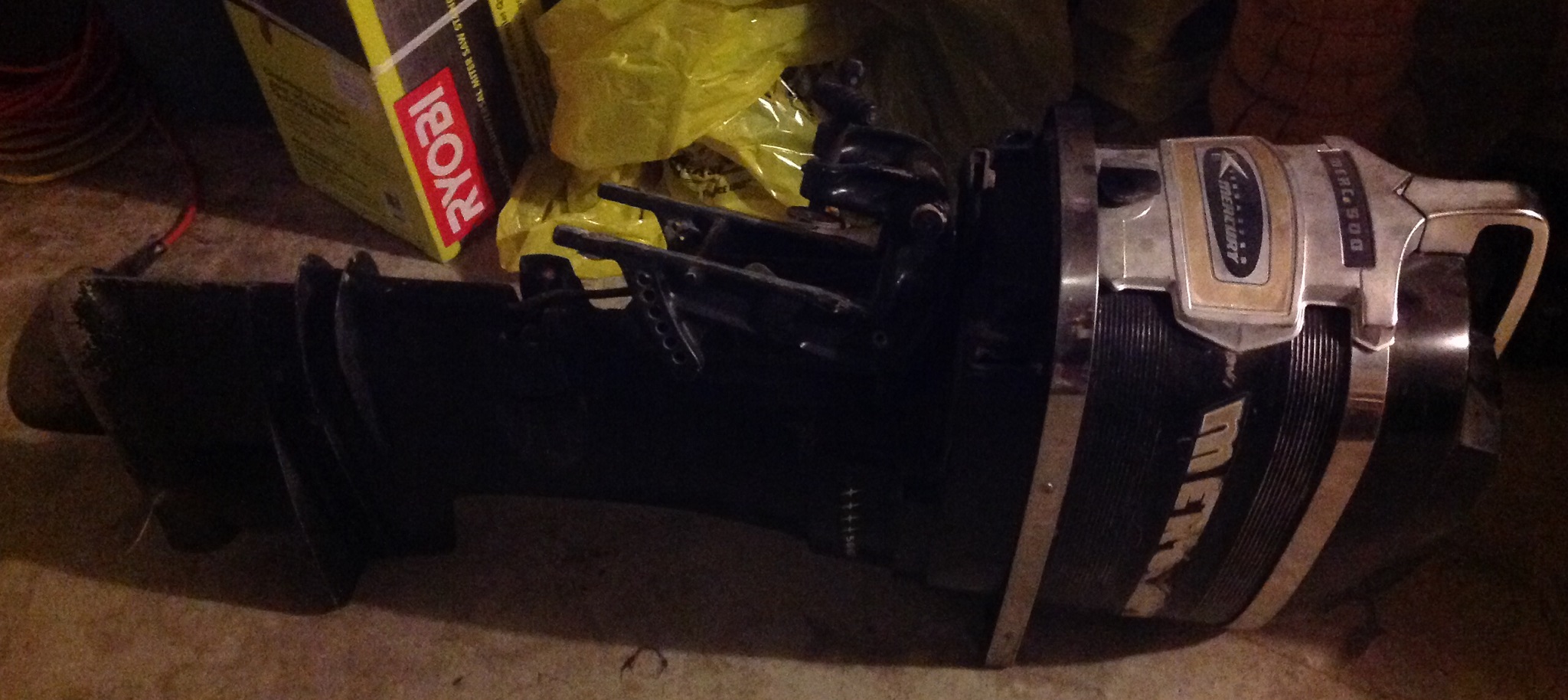

I'm including below an image of the engine in case there are different variants of the Merc' 500 I am not aware of.

Rob,
Others should chime in here, but this is what I see: the motor appears to be the long shaft (for a 20" transom) measured from where the clamp sits on the transom to the wide/flat ventaltion plate which sits above the water pick-ups (some call this the cavitation plate). Should be easy to see if it is the short 15", or the longer 20". Nice looking motor though :) Good luck. others - please clarify if I am saying this incorrectly or confusingly.

Thanks for the very quick reply. I've measured the motor and believe that you are exactly correct. I've marked up the photo shown below, which measures 20" to the lowest of the plates on the prop facing side of the motor. There is a wider plate that sits another 2" lower that extends opposite the prop side. Depending on which measurement is correct, the shaft length is either 20" or 22" I assume?
I also measured the transom on the boat. Measuring from the top of the transom to the bottom of the hull, at the midpoint of the transom (widest point) it measures 20".
I had thought I had read that the Marathon was supposed to measure 15". So... did I measure the transom correctly? Is it wrong to assume if the transom measures 20", and the motor shaft measures 20", that I have a match? Or is the motor supposed to be 5" shorter than the transom depth?

WELCOME ABOARD. - IF the Marathon was mine, I would sell (Your OB looks like a 20" shaft to me.) the long-shaft Mercury 50 & replace it with a matched pair of pre-1970 short-foot Evinrude, Gale, Johnson or Sea King BigTwins.
(A visit to any number of large AOMCI or other outboard/boat swap-meets will likely find a suitable pair of suitable outboards & that won't require you to "raise the transom". - I wouldn't be shocked to find that you can sell your nice-looking Mercury 50 for enough $$$ to buy the BigTwins.)

If they both measure 20", you have the correct match. You do not want to put a short 15" motor on a boat with a 20" transom for a few reasons: 1. the water pickup may not take in cooling water properly. 2. when trying to get the boat up on-plane, the propeller will likely catch air and ventilate (revving up too high and loosing bite). This in generally for most recreational boating. Boaters "in the know" sometimes raise motors up a few inches, but not 5", for small recreational use, it is best to match 15" short shaft motors with the older/shorter 15" transoms and also use the 20" long shaft motors on 20" transom boats. There are performance people out there that know how to raise motors to go fast and still get cooling. Your situation should just go with stock intentions. You measure your motor correctly. It is also not best to put a 20" motor on a 15" transom: sits very deep for shallow water...or raising the center of gravity 5" is not a good idea either.

I believe you have the right motor for your boat. You measured a 20 inch transom on your boat and the Glasspar specs in the FG library say it has a "long" transom.
The 20 inch versus 22 inch measurement on the motor may be a small measurement error in that the transom clamp can swing up and and down and your pic is a little to dark to see exactly where it's positioned. It looks to me like it's too far towards the raised position (out of the water) and if you pin it in the running position it will measure much closer to 20 inches.
You might want to make sure that it is pinned a hole or two from the bottom and then measure it.
As Dr. Go pointed out, a little too deep isn't a real problem, but running a motor to high can cause serious problems.

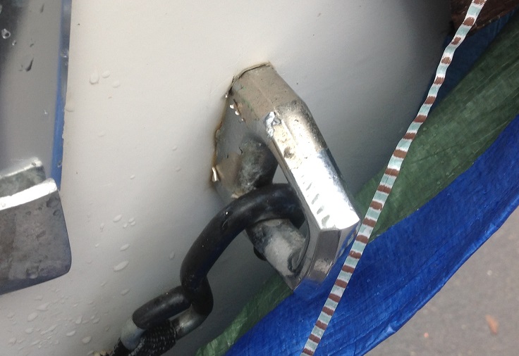

I also have another question about the boat. I don't know enough about it to know if I should be concerned about the transom or not. On the left hand side of the transom, the tie down point is pulled away and the exposed threads of the bolt show significant corrosion (picture attached). The tie down strap on that side is being attached to a cleat up top , as it would not be safe to use the intended point. The right hand side is solid (also pictured).
When I rap the transom with my knuckle, the middle third to 3/5 of the transom sounds solid. Out toward the sides on both sides it sounds hollow. Is this normal? Do I need to replace the transom?
Rob

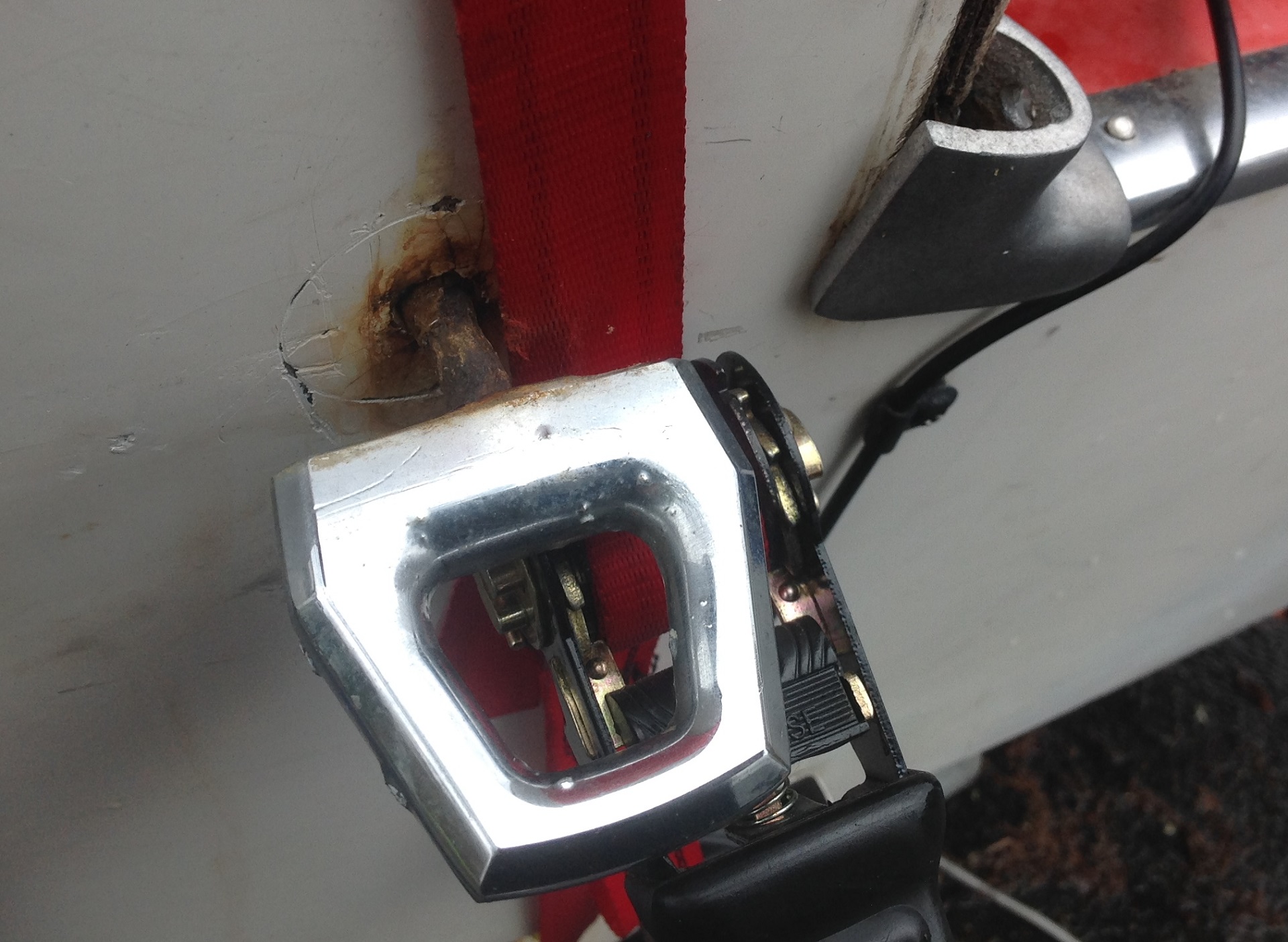

Re: 1965 Glasspar Marathon - Outboard sizing question 10 years 9 months ago #117723
Second pic
