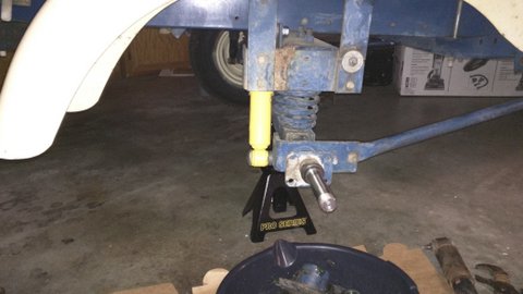

I received my Funliner about a week ago from Idaho. Having bought it sight unseen, I did find the hazards of that decision, like a missing skeg. But, after my initial shock and some great one on one support from Eduardo and James, I put a project list together and am just starting to tackle them one by one.
This week is all about roadworthy and registration.

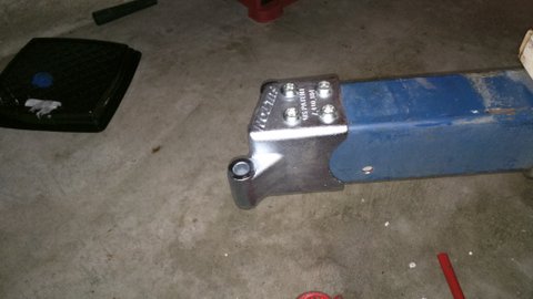

1. Added lights by making a couple of brackets which allow the lights to be visible when driving.
2. Replaced the shock absorbers and will be replacing tires and hubs before weeks end.
3. Cut off about 40" of tongue and installed Fulton Fold-Away Hinge. I haven't done anything like this before, but it is coming out pretty well. I have half of it done which is the hardest half. I should be able to finish it tomorrow night.
The rest of the week will consist of wiring the lights, changing the hubs and putting on new tires and then the dreaded visit to DMVs.
Thanks for everyone's continued suport both here and in the weekly chat.

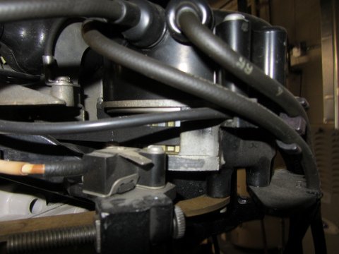

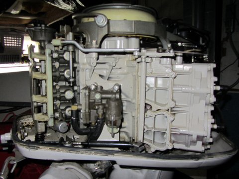

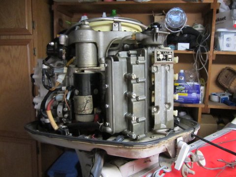

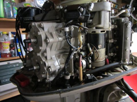

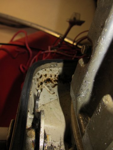

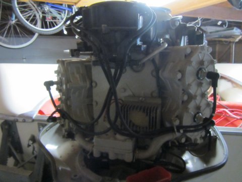

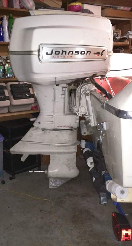

Here are close-up images of the motor. It is a 1966 Johnson 100 Hp golden Meteor.

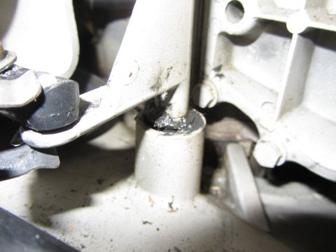

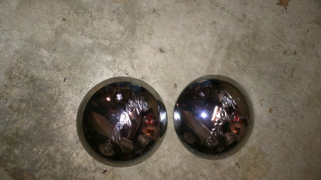

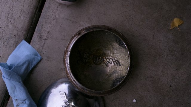

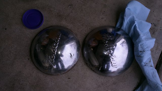

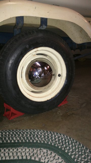

Well it was a two steps forward 1 step back kind of weekend. We figured out how to fix the tilt lock and also figured out how it originally broke because we broke the replacement piece. Thank God for Ebay. Also, got the lights and horn working. That is going to need some rewiring later and a replacement socket on the bow light. BUT a small win is the hubcaps. They were really grimy, but I got them clean and shiny! And no rust or pitting on them.
Re:1963 Aristocraft Funliner 10 years 5 months ago #117886
  • Jim L
  • Jim L's Avatar
  • Posts: 1426
  • Karma: 60
Lookin good ,David. Those caps look new. I think the wheels look better with the smaller tires. My tilt release was broke like that when I got my boat from my Dad. Did your top turn out to be the original or a bimini?

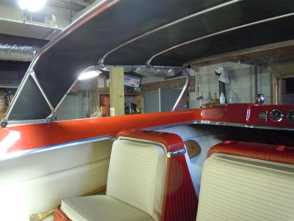

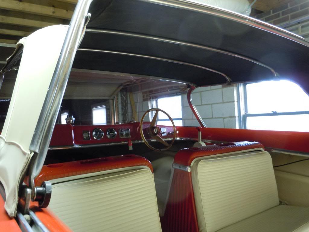

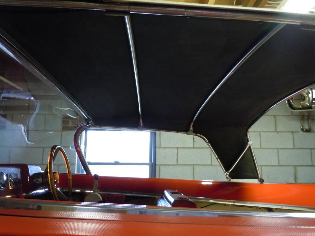

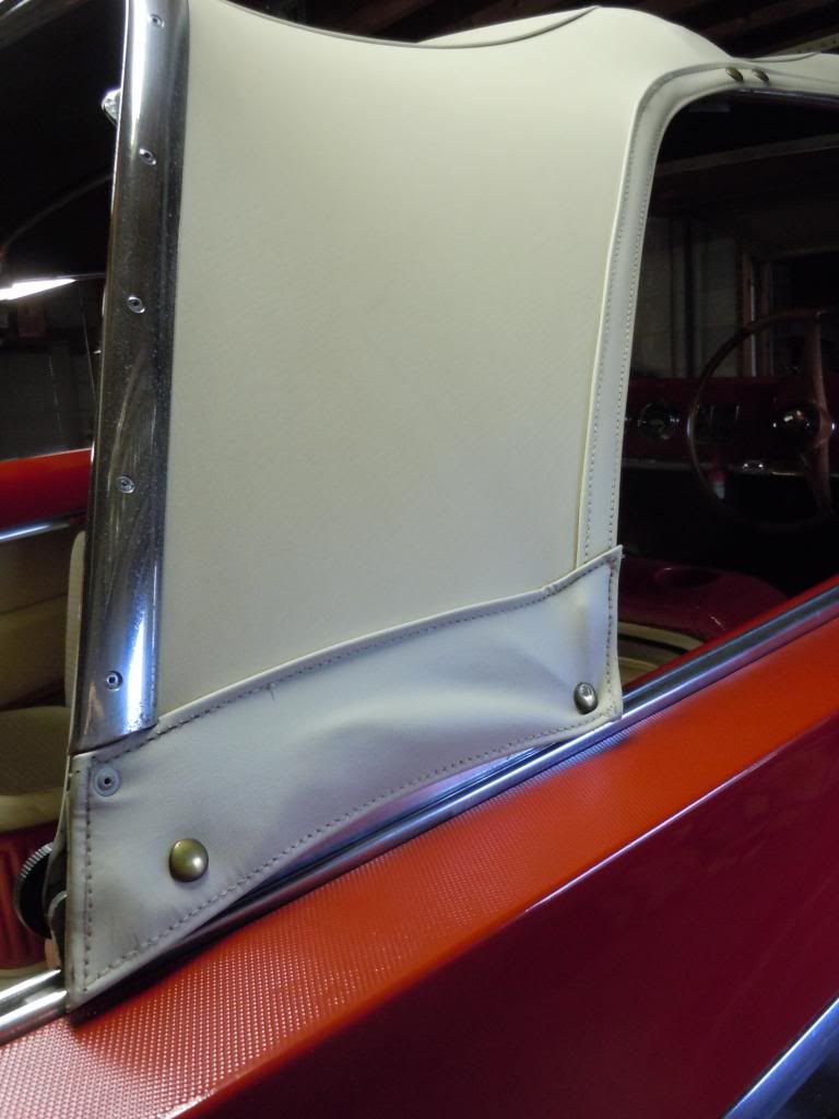

Here's some softtop pics to give you some insight as to how it's supposed to go.

That top looks pretty straightforward. . anyone ever made one from scratch? Might look good on my open top boat.
Re:1963 Aristocraft Funliner 10 years 5 months ago #117979
  • Jim L
  • Jim L's Avatar
  • Posts: 1426
  • Karma: 60
The top was designed to slide forward on the tracks,fold up and lay on the dash. I've never did my top like that and now it's so old and has shrank some over the years, I think it would tear it up if I tried.
Re:1963 Aristocraft Funliner 10 years 5 months ago #117988
Very nice. . I didn't realize that. I was just thinking removable hardtop like a old t-bird, just w vinyl and a frame instead
Re:1963 Aristocraft Funliner 10 years 5 months ago #117989
With really good pics and some measurements a Bimini top shop should be able to duplicate that top without a problem. It really does look cool and would be a very unique addition to your already neat ride. Your progressing nicely do you think it will be on the water for the New Years Run to the Yacht Club?

Thanks Bob and Jim. I will try that again tomorrow. The knob is still on there, but when I adjusted it today, it didn't make a difference.

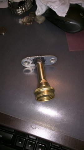

In other news, because I am over 100 miles away from 2 stroke friendly fresh water, I had to come up with an option for flushing. And having a 55 gallon bucket isn't really going to cut it in our severe drought conditions. So, I Magyver'd a solution today.
I think this should actually work better than the original tempo because the water will be going into where the water pump is as opposed to shooting up into it.
Tomorrow I may attempt to change the impeller and gear oil. I would think between 1 of the 4 factory and aftermarket manuals I have for this engine, I should be able to figure it out.
The only thing that really concerns me is the shift wires. I don't know if they are truly special, but online they are $200 to replace. So, breaking them would be badddddd.

Yeah Dave the shift wires aren't cheap. If you go back to my 80hp thread you'll see what I used to replace mine without having to pay that crazy price.

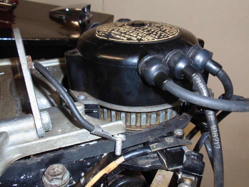

Re:1963 Aristocraft Funliner 10 years 3 months ago #119126

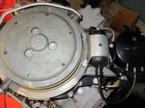

Dave, great catch-up post. Make sure that pesky distributor drive belt is in good condition. You don't want it to fail on the water like mine did.

Is there an obvious way to tell if the drive belt is good or not? Mine seems to be in good shape, I don't see cracking.
Thanks,
David
Re:1963 Aristocraft Funliner 10 years 3 months ago #119138
The ebay item id given is invalid, no result has been sentDavid, Mine had a few nicks in it and I thought it was ok till the motor shut down on the bay and the belt came apart. Age takes it's toll I guess. IMHO as long as you're beached for awhile I would change it out just to be on the safe side. I found one on ebay cheaper than marineengine.com but they are available. The part number is stamped right on the belt itself, probably white lettering. This should be it.
This is a used one but search the bay and there is NOS available.
www.marineengine.com/newparts/part_details.php?pnum=OMC0305446
Re:1963 Aristocraft Funliner 10 years 3 months ago #119140
"damartinca",
Be very careful marking both the magneto pulley position as well as the flywheel position when removing the drive belt so you won't have a belt timing issue when reassembling.
If you take the belt off, be sure and rotate the magneto pulley manually to feel whether or not the bearings in the magneto drive and magneto itself are okay, or if they need replacing.
Bad bearings cause a lot of the belt failures.
doc Frankenmerc
Re:1963 Aristocraft Funliner 10 years 3 months ago #119142
David, this is just my 2 cents, but I would not fool with the "timing belt" until you get the motor running. That way you do not have to worry about the timing as one of the issues if it does not run. If it fires no problem, then tackle the belt replacement as a maintenance job

Re:1963 Aristocraft Funliner 10 years 3 months ago #119148
  • Jim L
  • Jim L's Avatar
  • Posts: 1426
  • Karma: 60
Dave, I'd bet the belt is just fine on it. Since they stay covered up they generally don't go bad unless they get damaged. That's my experience anyway. Jim

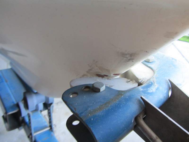

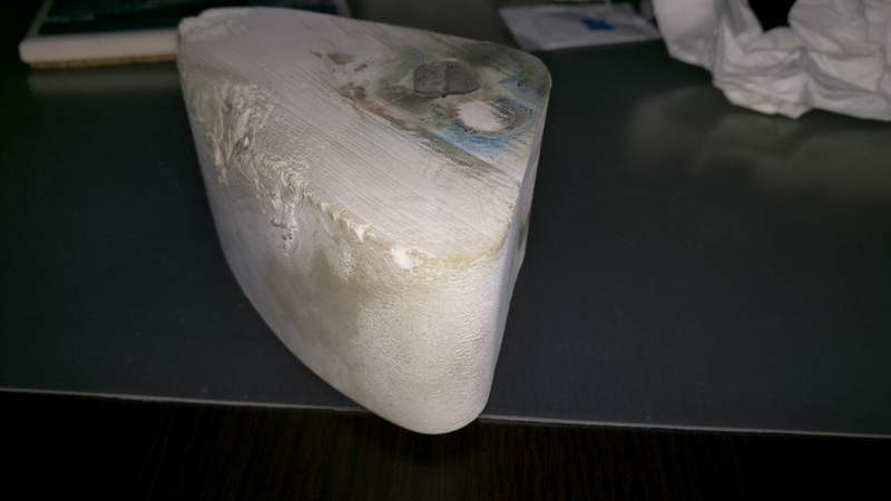

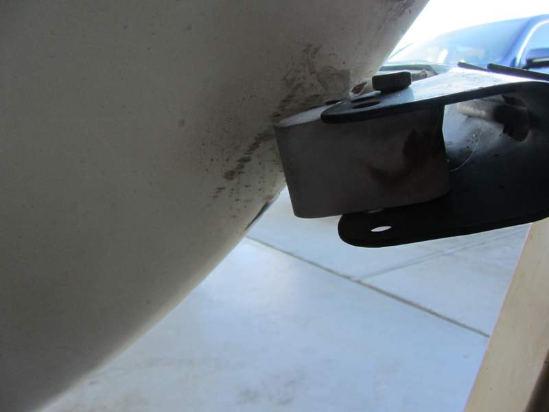

Suggestions??? I am trying to use the bow stop that is original to the trailer. Unfortunately, I am not finding the rubber anywhere. Can anyone think of a good alternative? I was thinking I could shape out of wood and then put a rubber edging on it....Open to all ideas. Also, does anyone know where you can get rollers in bulk?

Re:1963 Aristocraft Funliner 10 years 3 months ago #119475
Sounds great Dave. Never seen those kind of bow pads before. Have you done a thorough google search yet? Someone on here has to have seen them before.
