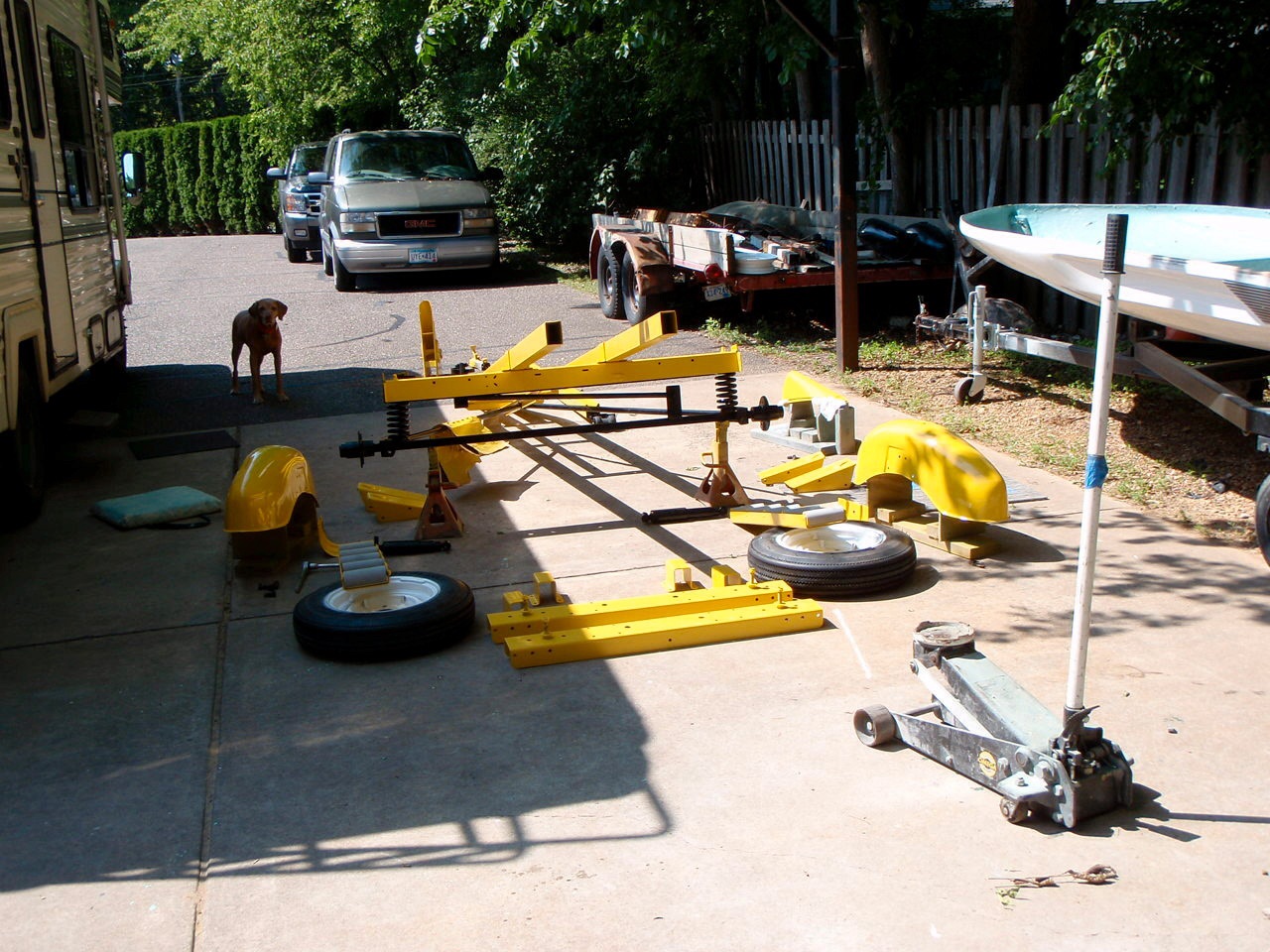

Re:Tee Nee trailer painting 10 years 5 months ago #117595
I have taken a few Tee's apart. I am quite sure the manufacture completely painted the whole trailer befor they assembled it so no matter how you adjusted it there would always be painted under the part you moved.. As to fasteners I paint them then once the trailers is assembled if I buggerd any thing I touch it up with an artist brush.
Not sure what they used for paint but it must have been baked on as it is pretty darn hard and durable.
