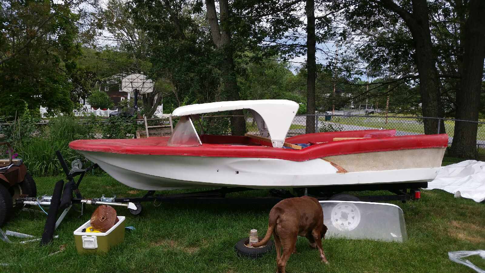

Hello all I am reatoring a Fireflite.Now that cold weather has set in not having a garage as halted the project some what.I continue to do what I can inside but the major work is on stand bye till its warm enough to glass again.I hope to hear from those of you with previouse experance once you read this and hear your opions and sugestions.Here are just a few pics of many then Ill ask question and hope for answers enjoy and thank you

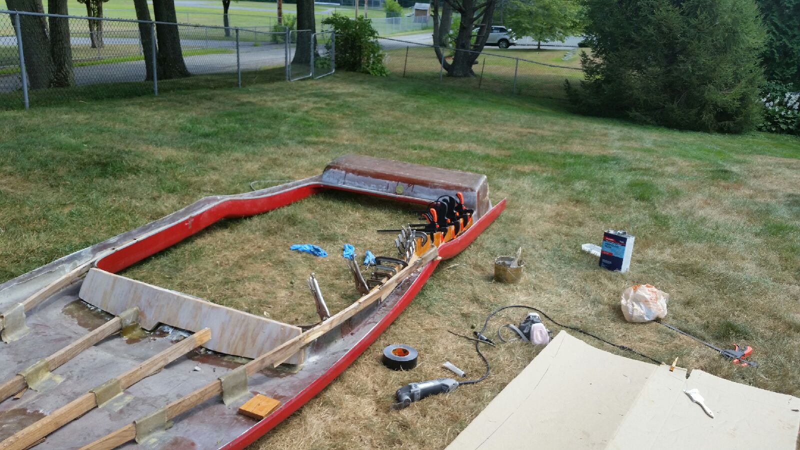

Re:Fireflite resto 10 years 6 months ago #117049
Gunnel wood

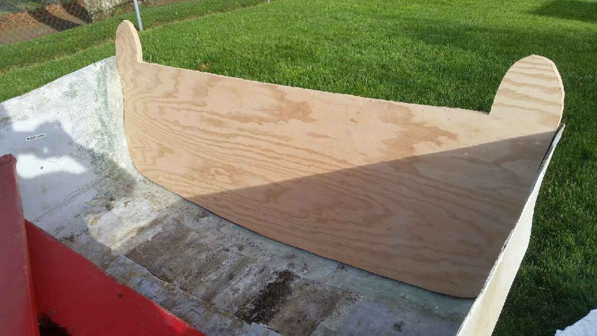

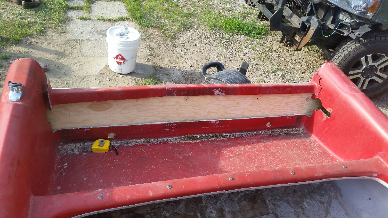

Re:Fireflite resto 10 years 6 months ago #117050
Transome fairing

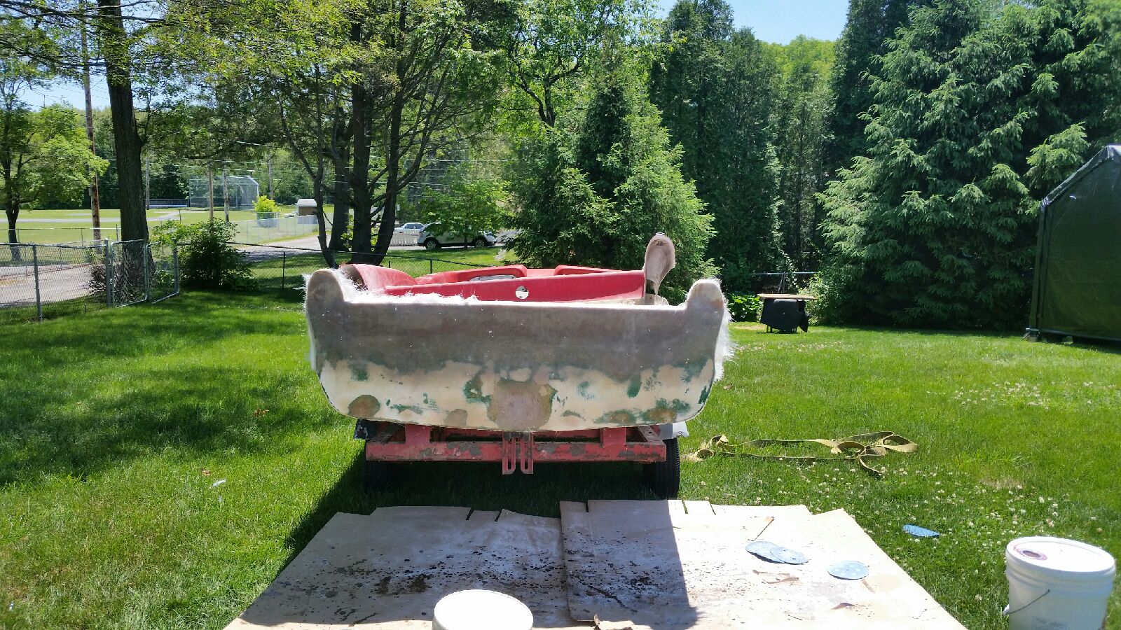

Re:Fireflite resto 10 years 6 months ago #117051
Transome install

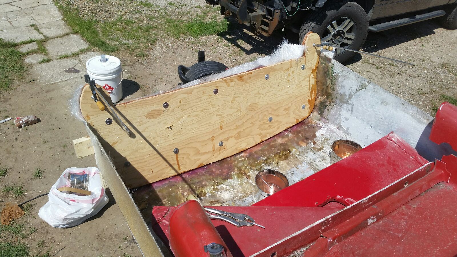

Re:Fireflite resto 10 years 6 months ago #117052
New transome height

looks like shes coming along nicely....love the hardtop...john

FinFever, nice Glastron, 1958, correct? Having thrhardtop is a great bonus.
Good luck w your project, lots of helpful folks hanging out here

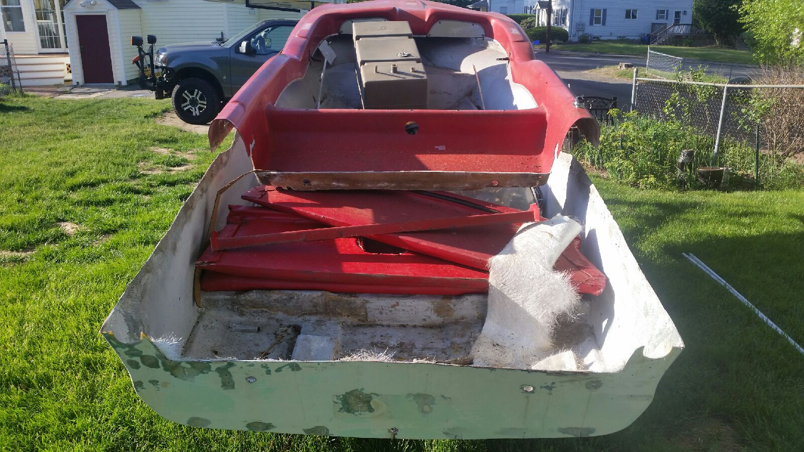

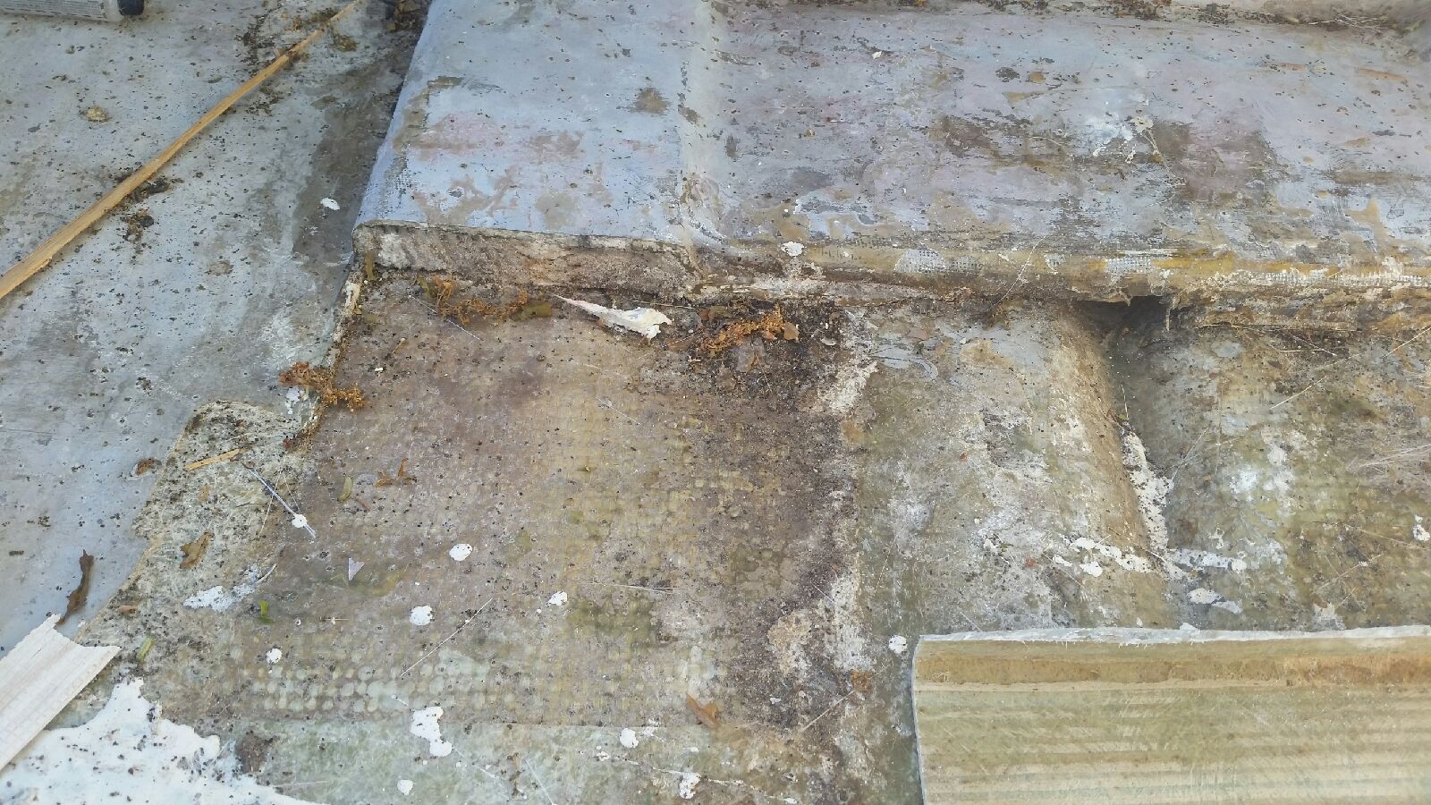

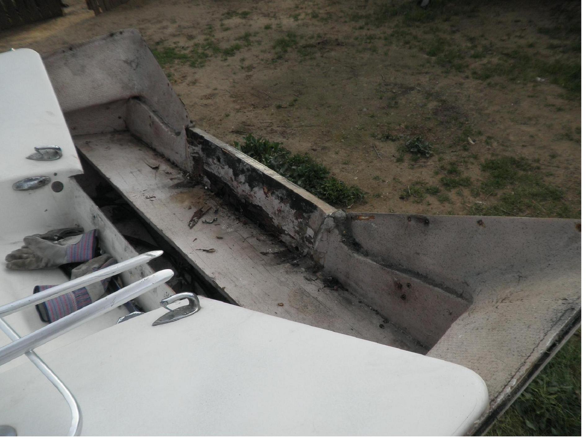

This is the floor you can see one of the planks ,it is layed flat side down not on edge like you would think. To the port is the floor witch is just the hull and this is whT flexes and i dont like it and this is why I want to core it. You can also kind off se were there should be a keel layed yet there isnt .This will also be addessed.
Re:Fireflite resto 10 years 6 months ago #117074

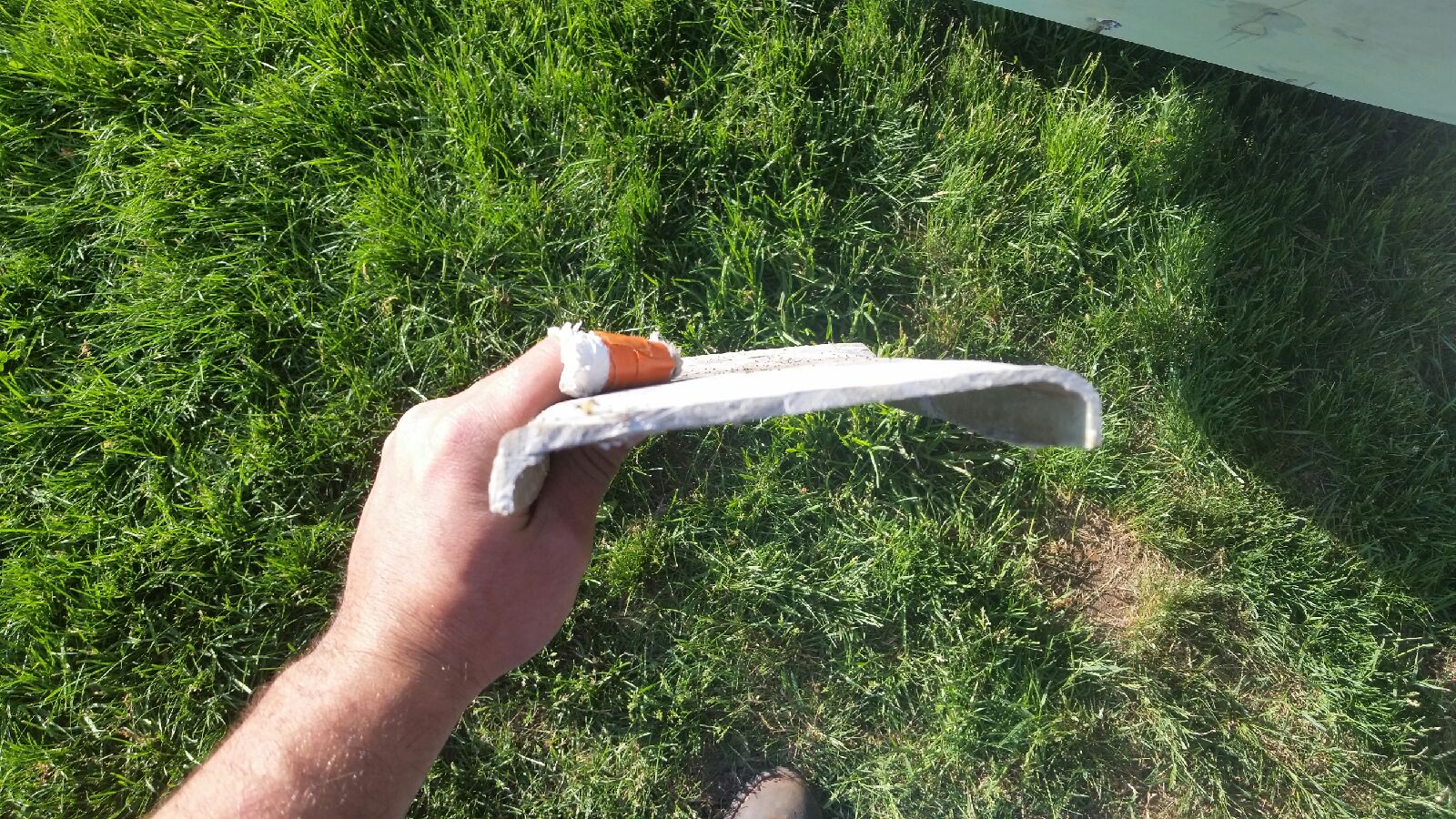

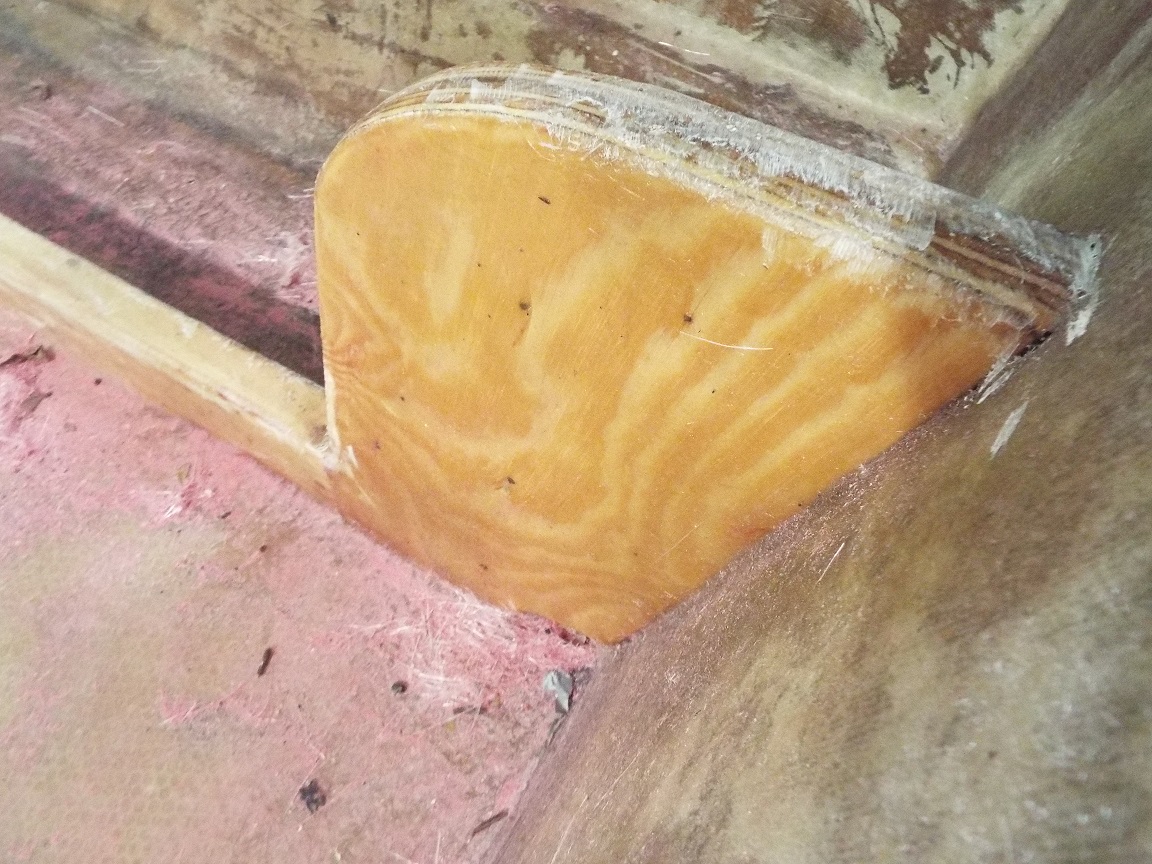

Here is a shot of the glass that was cut of the top of the stringer so it could be removed to install the transome .I used a fine tool man I wish I had this on the frist boat I restored. It has made such quick and neat work of this restoration as apoised to the scraper and griding I used last time. You can see just how thick it was layed on .
Re:Fireflite resto 10 years 6 months ago #117075

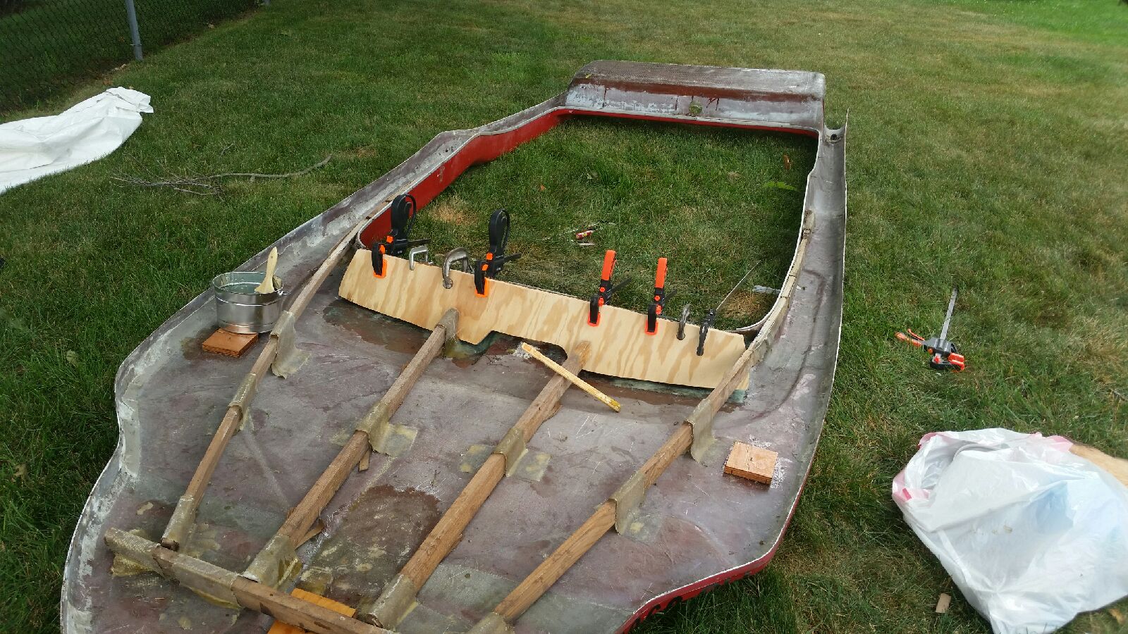

Heres two more shots not sure if they help everyone see the strange floor design
Re:Fireflite resto 10 years 6 months ago #117076
Another angle

I like glassing the knees in with the floor,make sure you cut a gap so water can go from side to side,,also make sure you grind the cracks clear down or they will come back in time,as far as the tops are concerned my theory is if you make some then your isn't as rare,,they have been made before,,I have only seen 1 other retractable,but that can be copied too, good luck Bill

Just to clarify a bit on the knees, they are braces, like shelf brackets, that tie the transom to the floor to eliminate flexing when using heavier or higher HP motors than the boat was built for originally. Since you are doing both of the above, make them a must-do. Add two, go 12-24 inches on the floor, and as high up the transom as your design allows. As suggested, cut a 2" notch at the corner to allow water to pass to the drain. Also, DEFINITELY use a Transom Saver when trailering.
Re:Fireflite resto 10 years 6 months ago #117101
How thick is the new transom plywood? Because you have already cut the back out of the splashwell, it is a good time to make it more robust if it is of questionable thickness. If you go ahead and cut the splashwell all the way to the bottom, you can simply trim the bottom pan "forward" to allow the deck to fit. Then you can glass the deck / spashwell area to the new transom face.
Also, with the splashwell tub in the way, I'm not sure knee braces will be practical. The strength of knee braces comes from the formation of a triangle. A knee brace in this boat would be an "L" shape, which while better than nothing, isn't the best brace. A triangular brace that is too low on the transom face (to clear the splashwell) won't offer much additional strength.
In a case like this, I believe that a lateral brace offers more support and better way to couple the transom to the rest of the boat. A panel of plywood can be fitted just below where the splashwell belly will be. This is tabbed and glassed to the transom face, and the sidewalls of the hull. The wood is tied to the transom and hull only by fiberglass - no hardware is needed.
This is all just my opinion, and as everyone who has ever worked on one of these knows, just about anything you do to this boat will be better than the way it was originally built.
