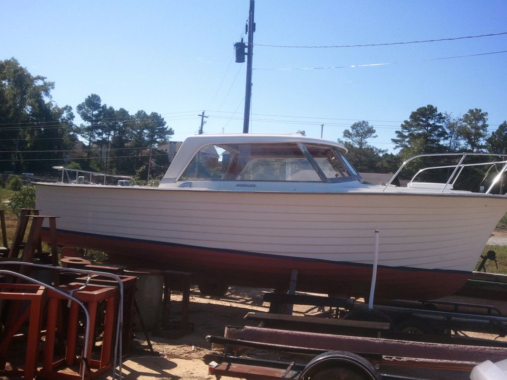

My name is Mike, and I am new to this forum but have visited this site often over the years and enjoy seeing every ones passion for these old boats. I have two classics, one 1950 aluminum Feathercraft firefly that has been in my family since 1953 and a fiberglass 1961 Wheeler 25'10" semi sedan cruiser.
I have joined this forum to tap into the knowledge of every one here to help me with getting the Wheeler back on the water as it may be the only one left as I have not been able to find any pictures or any major info on this boat to date, except what little info exists here and from a correspondence with Wesley Wheeler, the great grandson and son of the men who designed and built the Wheeler.

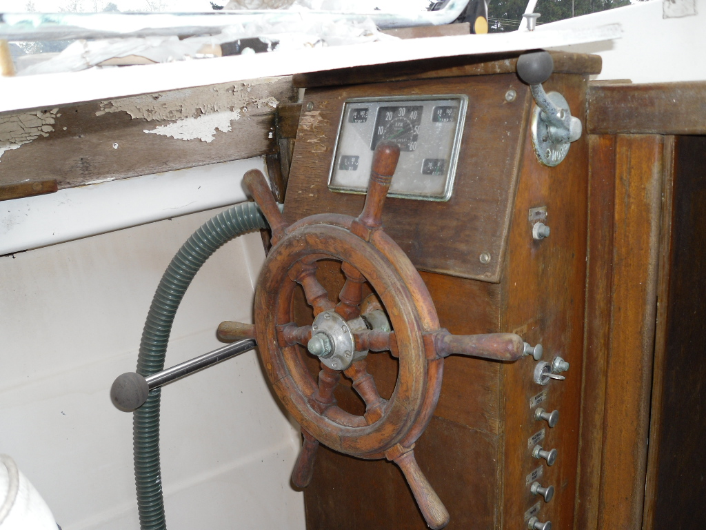

So my boat has been gutted at some point in its past and possibly had a small fire in what may have been a cook top area(some black char on the fiberglass headliner). The engine, marine gear, fuel tanks and seating all removed. The engine I have some knowledge of and know it was a 318 with a paragon marine gear. I also know it had 2 auxiliary fuel tanks on the deck. The v berth is all intact as is the porta potti, original helm station, and rear deck area. The vessel is very solid, except for the mahogany tilt out windshield.
Anyone that has info on this or other vessels like it I would be appreciative and pictures of any aspect of the boat too would be helpful to determine the original layout.

WELCOME ABOARD. = LOOKS like a nice design too.
(The WHEELER boats that I know of were built in wood (white cedar) near Baltimore, MD in the 1950s-early 60s.- One that used to be a frequent visitor at the Chesapeake Maritime Museum was probably about 50 foot in length.)

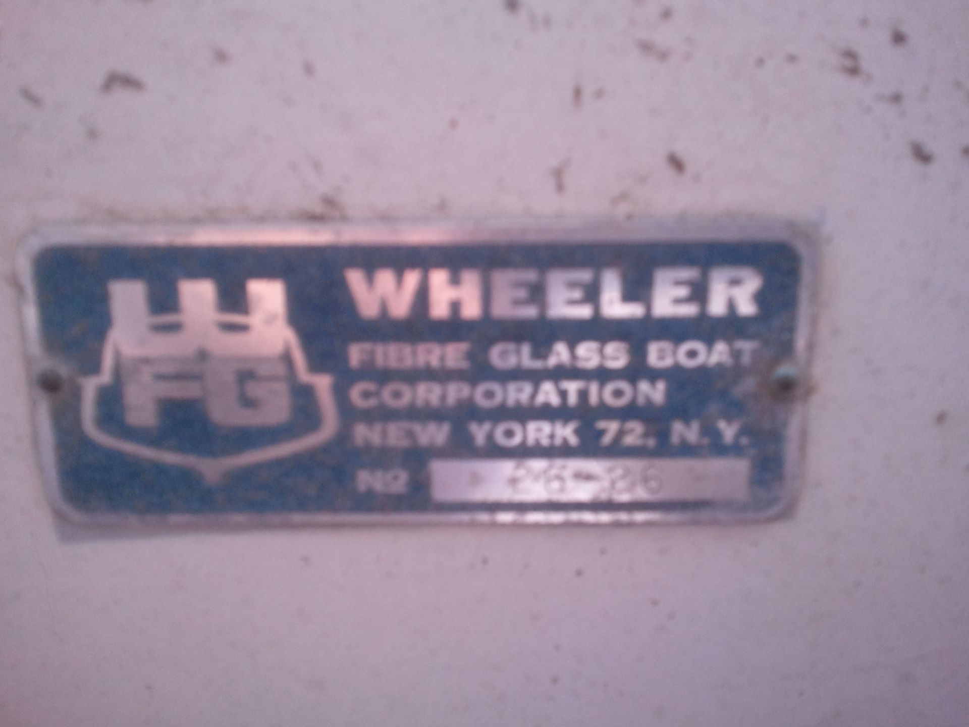

I too communicated with Wesley Wheeler about Wheeler Fibre Glass Boat Corporation. The man I communicated with has since passed away.
The "Fibre Glass" firm was a spin-off or subsidiary of the Wheeler Yacht Company. The fiberglass entity was a very short lived operation and it helped pull the parent company down. The guy who purchased Span America Boat Company around 1960 was also attempting to buy Wheeler Fibre Glass. It did not happen.
I have some corporate history in my files at home in Minneapolis. I think I have a copy of a stock certificate. I am in Peshtigo, WI right now. When I get home I will check the files.
I do NOT have any information on the boats or how they were built.

Welcome to 'Glassics! My Owens Concorde 27 was in worse shape than that when I started. It will be a substantial project, should you go for it. A 350 Chevy with a Borg-Warner Velvetdrive would be my choice of power.

sailor58, the boat is actually in really good condition. the pic I posted was when I found it. Once it was cleaned out and gone through I realized that there is no rot, except windshield and some plywood floor around where the battery was and the engine hatch has a broken rib. The stringers are good as is the deck. The hull on this boat is about 1" thick and around 1/4" in non structural areas.
I have always planed a 350 engine with borg warner marine gear, but did have a volvo 4 cylinder marine diesel I played around with, but was too tall and would have required raising the engine hatch a little or buying an expensive marine gear that would allow the engine to mount flat, yet have the angle for the prop shaft. Will probably even do fuel injection for reliability.
I will probably have someone else remake the mahogany windshield, and I will do the rest. I already have a roll of flexiteak to do the floors with. I just am having a hard time picturing an interior layout and a few things like that.
