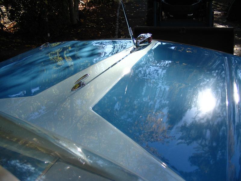

I used Rustoleum Pro Oilbased with the added acrylic enamel hardener on the deck of my boat. 3 Coats. I also sprinkled a bit of Playground sand on the second coat and then rolled on the 3rd coat over the sand to give it a bit of texture. It's been on for 3 years and it's holding up extremely well. I must say I don't get a lot of "Traffic" on the deck and not a lot of exposure to the elements either but my entire boat is painted with the Rustoleum + hardener and I'm Loving it!!! Using the Hardener basically makes it a two part paint soooo, I'm thinking you might THINK about using it. I know lots of guys that have, and are very pleased with the results!!! ;)
