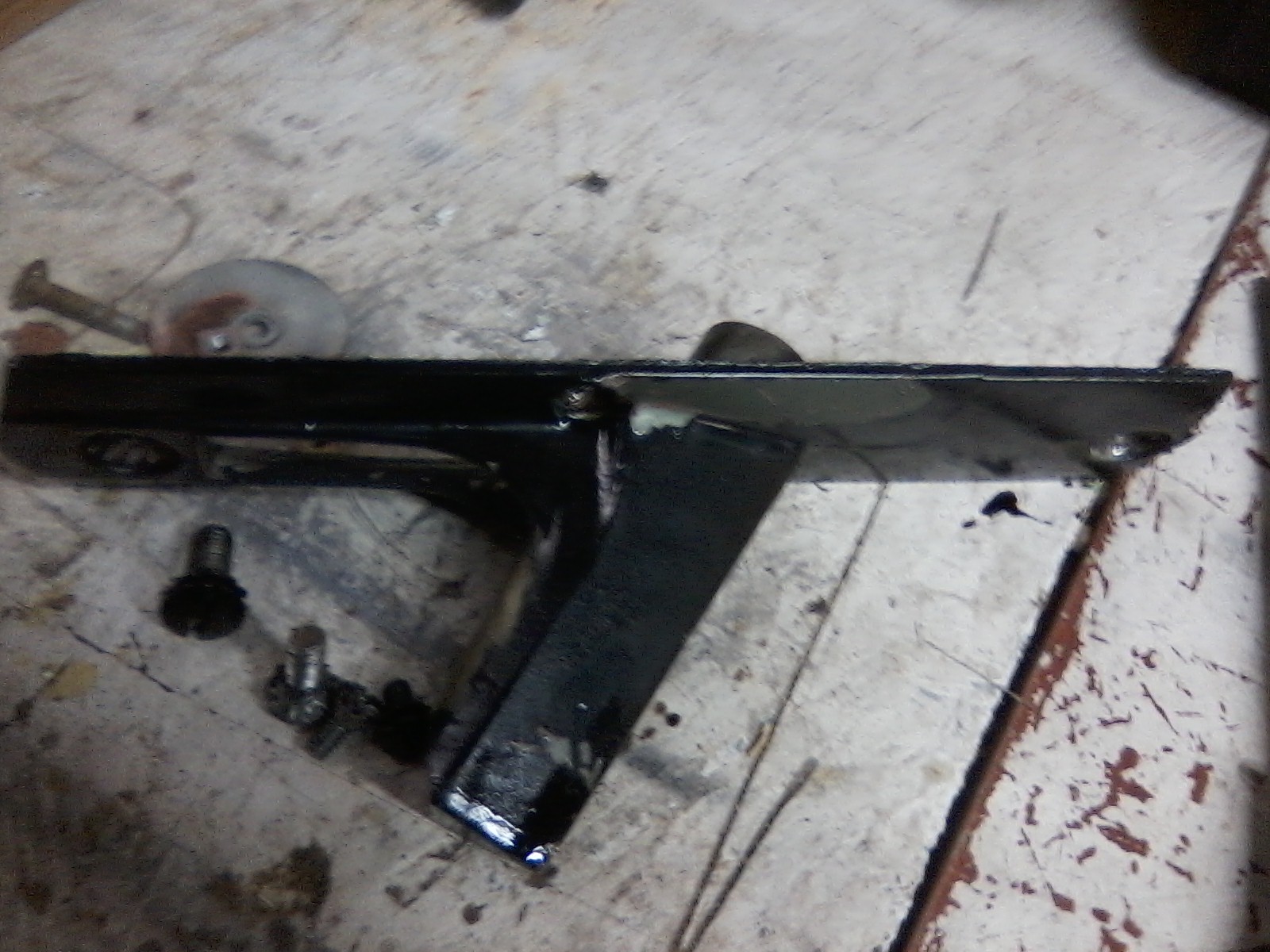

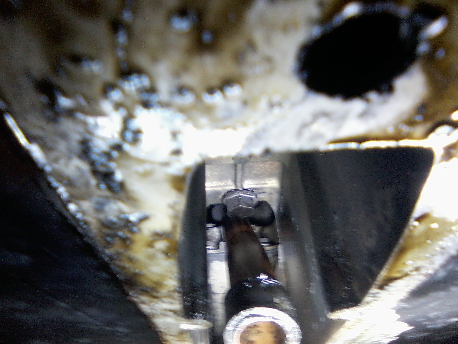

Couple things here. I also have a '67 100hp golden meteor. Never heard of the splines freezing up in the crankcase but I suppose everything is possible with these workhorses. This may be a dumb question but how old is the mechanic? Not the motor, we know that, the mechanic? Some of the younger generation just don't want to tackle these guys. The obvious bolts you can see from the outside are not the only ones holding the LU in place. I believe there is a hidden bolt inside the LU. I'll check mine and send a pic.
Remove the water pickup tail (4 Screws)
There is a hex head bolt, hard to get at but I believe it has to be removed.
