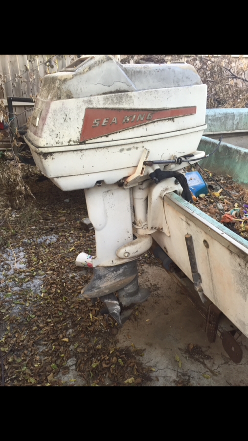

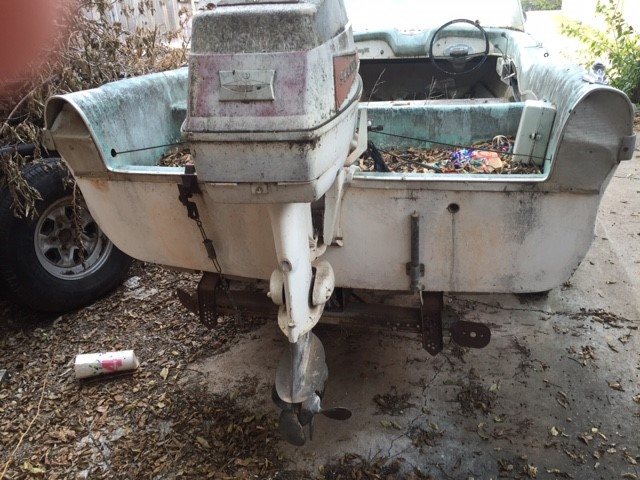

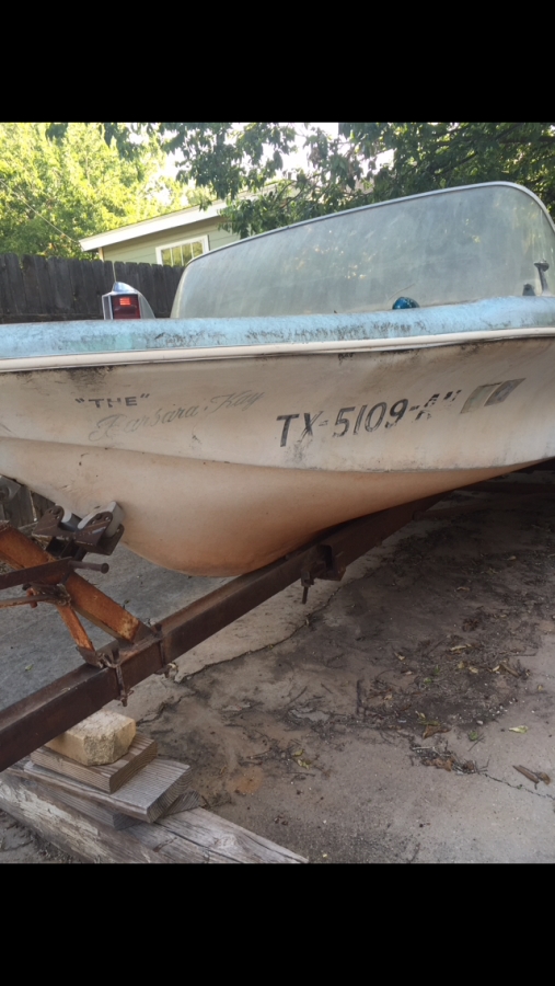

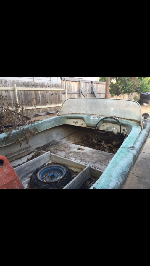

So I was able to get a very cool boat for free from a family member this week, a 1959 Glastron Surf-flite with what looks to be an old Montgomery Ward Sea King Forty or Fifty, I am not sure . I really want to restore the boat and it is in desperate need of lots of repairs and restoration. I was wondering if y'all could give me some advice on what to be on the look out for and maybe where to start and if I should have the boat re-gelcoated or try and use some sort of marine epoxy paint or something like that? I am fairly handy but I have never worked on a boat before so I am a complete newbie on this front

I think you have come to the right place for information and help in your pursuit of restoring the Glastron. You will also find a supportive group of people to make you feel less alone in this process.
You have chosen what looks to be a nice candidate for restoration.
Nearly all of the questions you will have about restoring the boat have been asked many times before on this forum. By using the site search feature, you can tap the archives of the message boards for answers to your questions. There is an absolute pile of information contained in the archives - use them to your advantage.

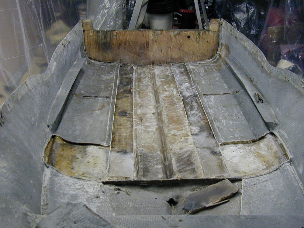

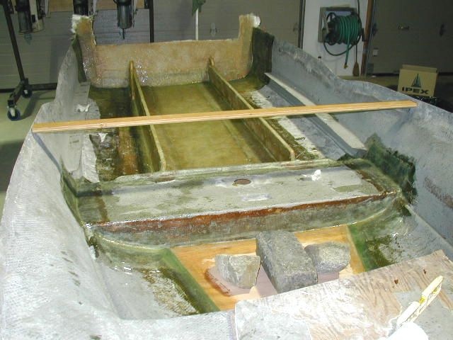

As tempting it may be right now to think about making the boat pretty, you want to check the structure of the boat before anything else. Chances are very high that the plywood reinforcing under the fiberglass is on the way to being rotted, or it is completely rotted.
Replacing transom wood and structural members is one of the most intimidating and least fun part of the restoration process. The payback is a solid boat that performs as good as it looks.

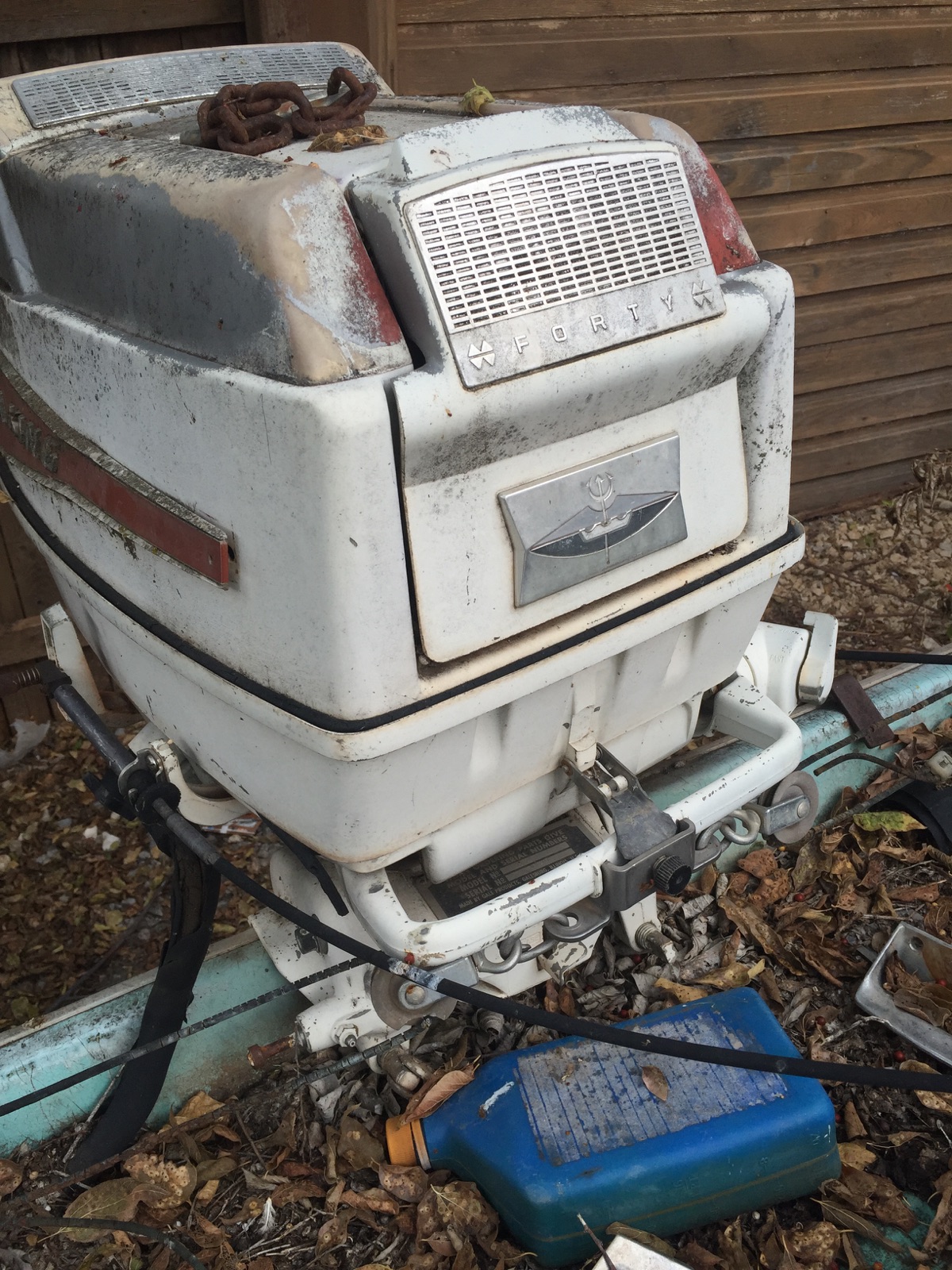

The motor was made my OMC, the builder of Johnson & Evinrude motors. it is either a 25, 30, or 35 HP. Parts are all over the place for that motor, and they were very rugged and reliable. Your boat should have at least 35HP and somewhere between 50 to 65 hp would be ideal. 35 may be a bit weak if you have a load of passengers and an ice chest aboard.

WELCOME ABOARD. = NICE Glastron. - I think that your SEA KING outboard is a 40HP.
(Almost all the internal parts are interchangeable with the Johnson & Evinrude.)

Yea Bruce the floor is definitely rotted out and will need to be replaced so I assume that the stringers will also need some work and maybe replaced and all will need lots of refiberglassing. I have seen some stuff on line where people take the tops of the boats off and work on both sides but I didn't even know they could come off until today. I agree with you, before anything I want to make sure that once the boat is restored it is done right and won't need to much work again in the future.

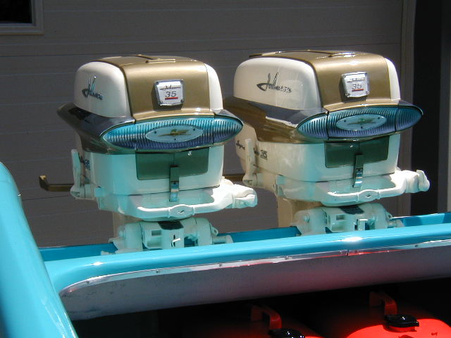

Fwiw, IF it was my boat I'd find & install a matched PAIR of restorable 1959 OMC 35HP outboards by Johnson, Evinrude, Sea King or Gale.
(I just looked it up & the Fireflite will easily handle 70HP.)
A hint: Virtually ALL of the interior parts of the 35HP OMC outboards interchange.

That's a very cool boat, but your in for some work. Looks like it's sat out in the weather for some time. But many of us have been there. While I feel that there are quite a few boats that if that rough, not worth the effort of a full blown restoration, but that one is.

The late '50s & early '60s Glastrons were designed for a pair of OBs OR a single larger OB. = They run fine with a pair of 35-40 OBs or a Mark 78.
(In my misspent youth in Northeast TX I knew many people who were running pairs of BigTwins on Glastrons of that period & some of those rigs are still around up there on Lake of the Pines, Caddo, Lone Star Lake & on some the other newer/larger lakes.)
Finding dual controls for a pair of OMC motors is NOT hard either, though they may cost as much as a good-running BigTwin does.
(I'm currently looking for a pair of BOSON dual controls to match a pair of 1961 Gale 40 Sovereigns, that I have "squirreled away" to power a Carter-Craft 17 foot runabout.)
