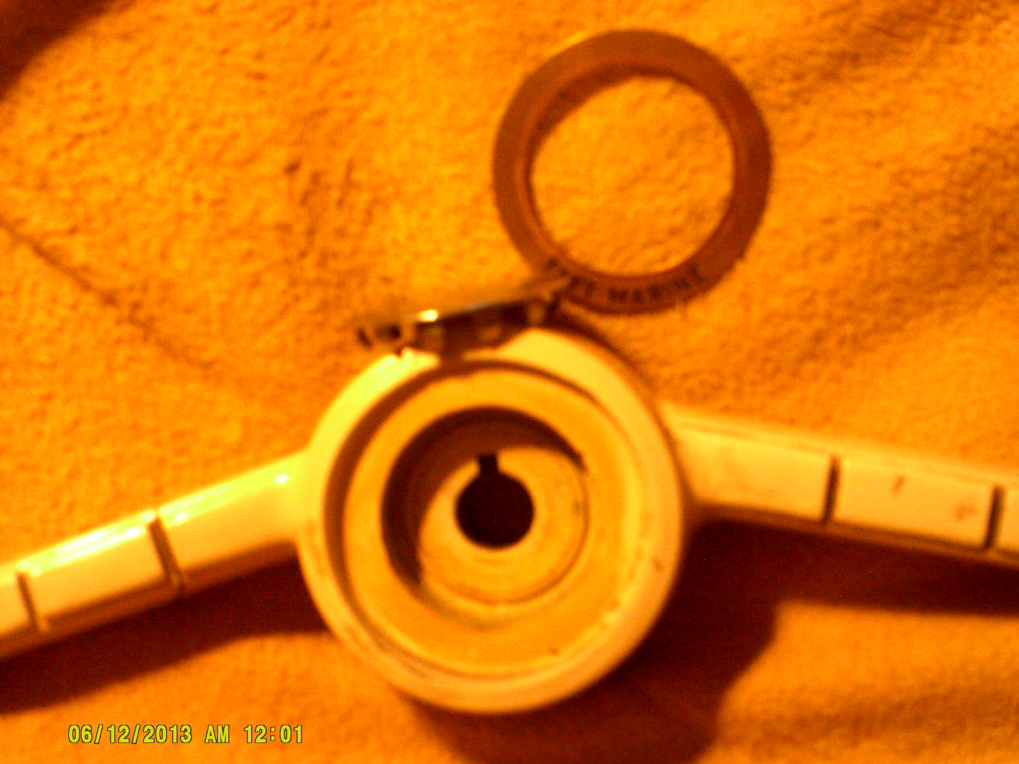

Re:ATTWOOD STEERING WHEEL CENTER CAP - TEXAS MAID 10 years 5 months ago #115722
here are some pics.

Re:ATTWOOD STEERING WHEEL CENTER CAP - TEXAS MAID 10 years 5 months ago #115759
Chuck in Cincinnati,
WILCO & THANKS again.
Re:ATTWOOD STEERING WHEEL CENTER CAP - TEXAS MAID 10 years 5 months ago #115763
refer to pictures above
gold trim ring:
ID - 1.776 dia. or 1-3/4 by measuring tape
OD - 2.411 dia. or 2-7/16 by measuring tape
Thickness - .021 inches (less than 1/32") don't even bother with measuring tape
Chrome cap:
OD of chrome - 1.921 dia or 1-7/8 / 1-15/16 however you look at it
OD at spring clips - 1.784 dia 1-3/4 but you can bend the springs ?
height of spring clips - .231 inches or 1/4 inch
Disclaimer: Measured with Harbor Freight calipers.
I am not responsible for any dimensions off, due to non-certified
Calibrations
