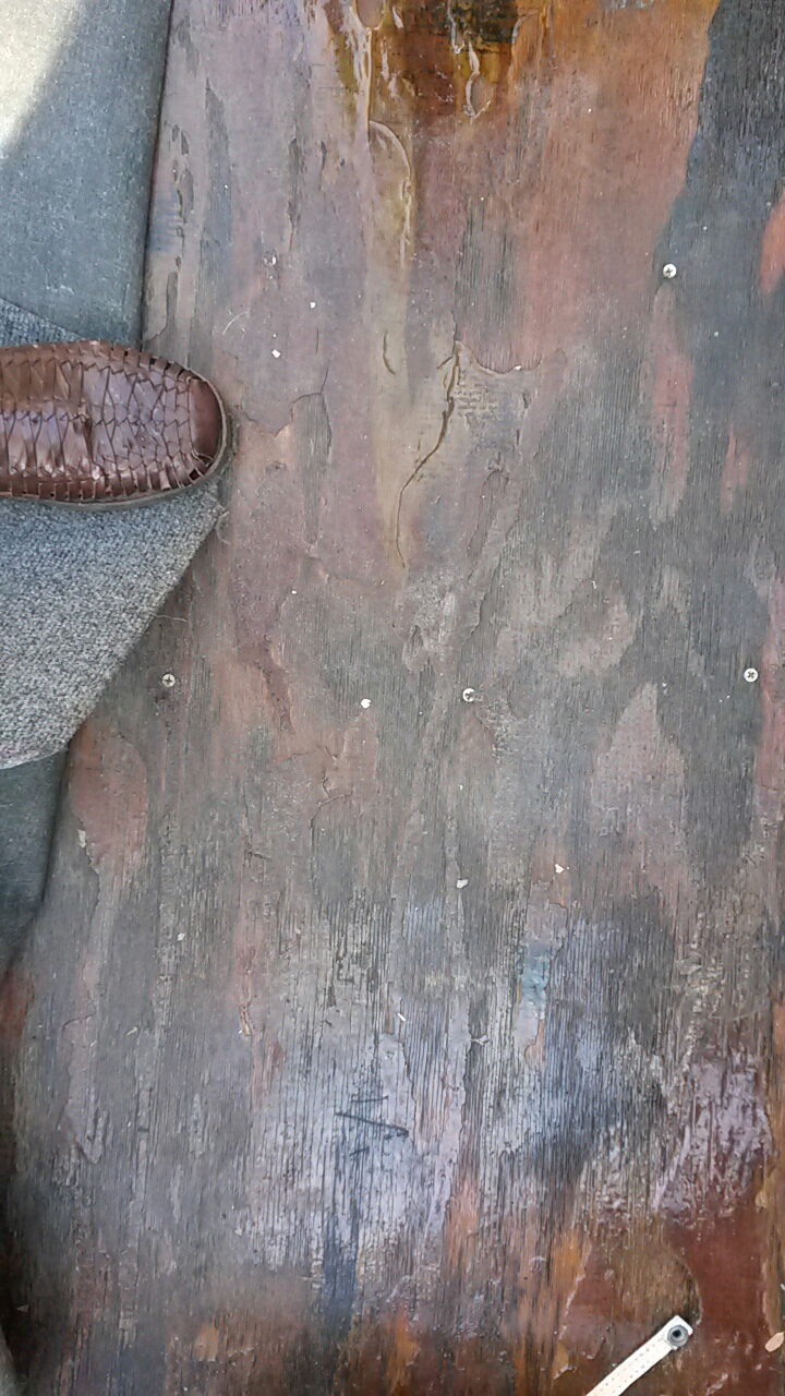

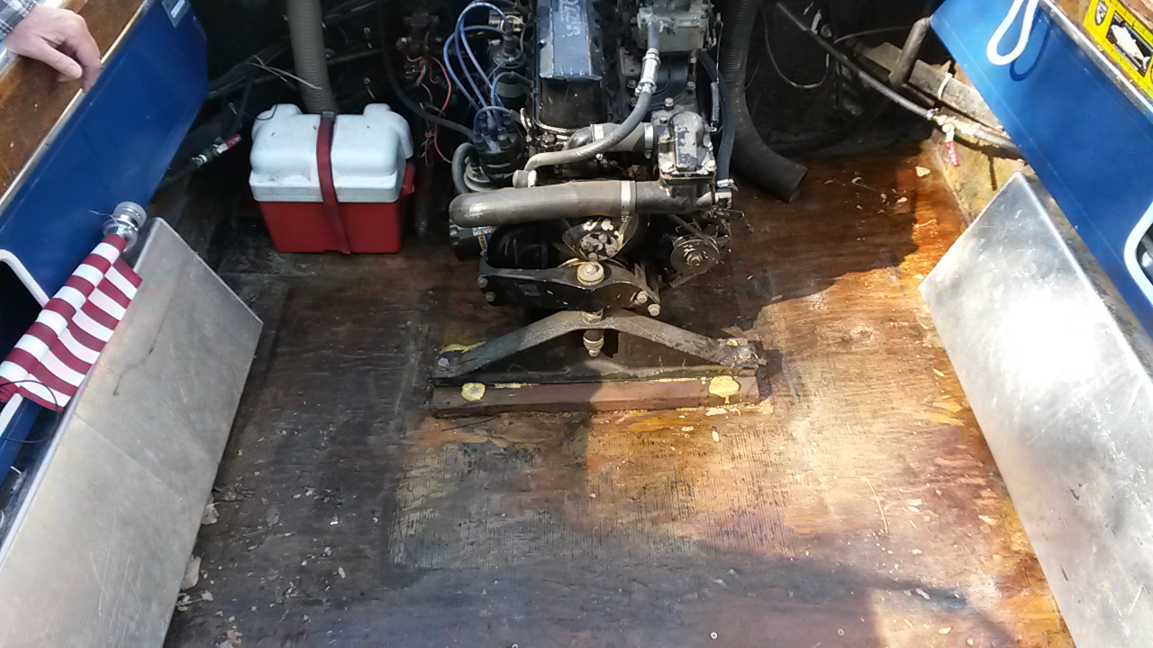

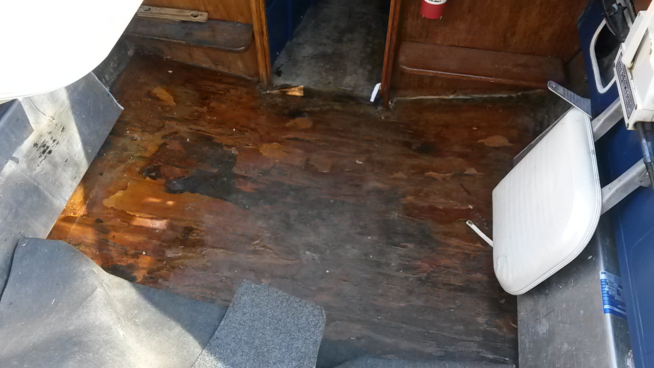

So I really do appreciate all your inputs and I can tell that you all seem to think there is quite likely water weight sponged up under the floor. So I pulled the carpet up, and looked at the entire floor. And there was a small spot or two of a little give, I was surprised how good and decent the wood looked. Now, the wood is screwed down, but on the edges, where the wood meets the fiberglass, it is fiberglassed to the fiberglass sides of the boat. On top of that, the wood floor has a coat of fiberglass on it. So....how can I check the foam and stringers with out tearing up the floor? It may be a dumb question, please just keep in mind Im new to all this. And if there is anyway to mitigate tearing apart something that doesnt need it, Im all for that as Im sure you would understand. Thoughts on how to proceed with floor?? And I took pictures of the floor today, and will post them. Maybe they will help give you further insight.
I will be doing a compression test with the help of my Dad hopefully in the next week or two. And thank you split for the further insight, I am already trying to track down those you items you suggested.
And several of you asked for photos, I will try and upload them right now. I know that just because no visible wood rot or holes in which water could flow into the stringers and foam below, but I will say what I saw looked to be in very good condition if there was indeed water damage underneath.

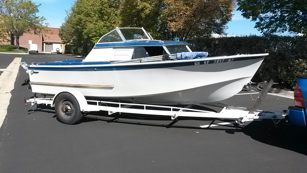

Re:I/O Glasspar Seafair Sedan, need engine advise... 10 years 10 months ago #115905
1967 seafair sedan

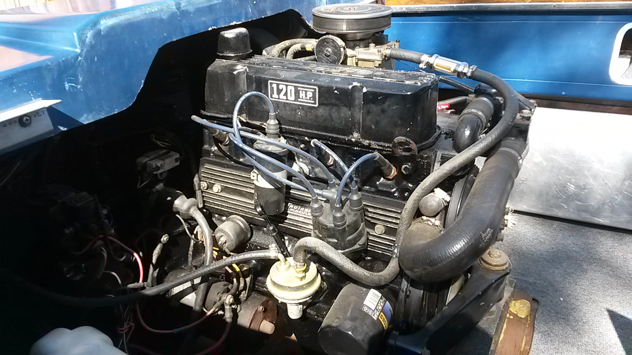

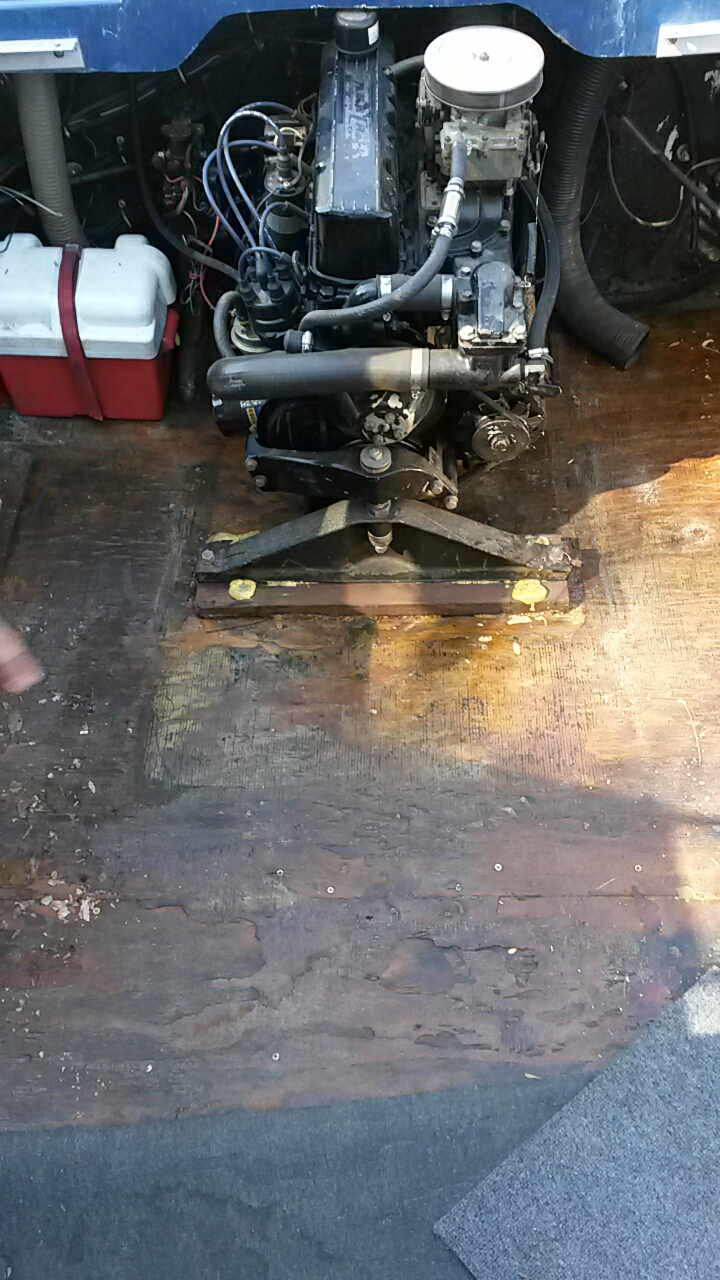

Re:I/O Glasspar Seafair Sedan, need engine advise... 10 years 10 months ago #115910
120 mercruiser. All original I'm assuming, without any other reason I can see to the contrary.

Re:I/O Glasspar Seafair Sedan, need engine advise... 10 years 10 months ago #115913
Rear floor

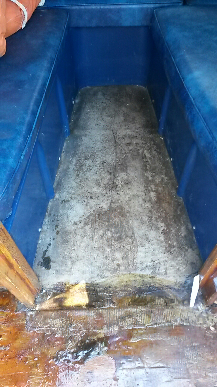

Re:I/O Glasspar Seafair Sedan, need engine advise... 10 years 10 months ago #115914
Floor

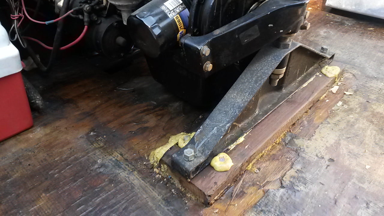

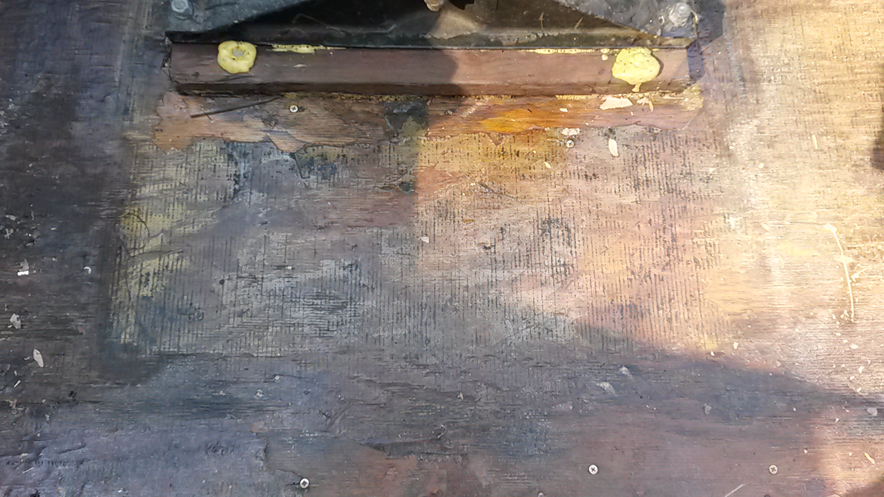

Re:I/O Glasspar Seafair Sedan, need engine advise... 10 years 10 months ago #115916
Floor, under engine and motor mounts.

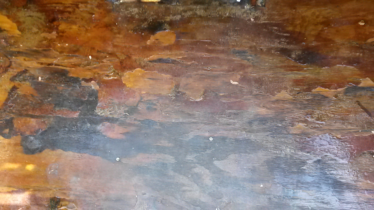

Re:I/O Glasspar Seafair Sedan, need engine advise... 10 years 10 months ago #115917
Floor under the carpet in the cabin.
Re:I/O Glasspar Seafair Sedan, need engine advise... 10 years 10 months ago #115918
Upper deck floor
Re:I/O Glasspar Seafair Sedan, need engine advise... 10 years 10 months ago #115921
Upper deck floor
Re:I/O Glasspar Seafair Sedan, need engine advise... 10 years 10 months ago #115922
Mid deck under carpet.
Re:I/O Glasspar Seafair Sedan, need engine advise... 10 years 10 months ago #115923
Mid deck flooring.

If you have a small hole saw that can fit on your 'lectric' drill just drill a hole in the lowest part of your floor (not through the floor :) )and take a "core" sample. I use a 3" hole saw and save the plug that comes out. If you're happy with the results you can just place the plug back in the hole and glass it back into position.
Re:I/O Glasspar Seafair Sedan, need engine advise... 10 years 10 months ago #115969
Thank you much! I sure like her. Ahhh, that sounds like a good approach. But aren't there several rows of stringers? Wouldn't I need to take at least a core sample from each row of stringers? Or is the lowest column of stringer good enough?
Re:I/O Glasspar Seafair Sedan, need engine advise... 10 years 10 months ago #115973
Funny you should ask...If there is water present in one part you can almost bet it's throughout the entire bilge. That is a simple way of looking without compromising the integrity of the boat. I have drilled as many as six around the floors of some. With the older boats you can usually see where the stringers are, they are somewhat elevated, discolored etc.
On another subject....hate to rain on the parade but if there is water or soaked foam you might want to check the transom around the outdrive, drill a small hole on the inside if you can reach back there, maybe 1/8" bit and see if the wood comes out dark and damp. Although I/O's don't rely on the transom for motor support they are still vulnerable to rot. There are videos on youtube that cover just about all replacement procedures, some are simple other fellas really go overboard (pardon the pun)
Hope things come out positive for you.
If you do need help with replacing or repairing that beauty there is plenty of help here.

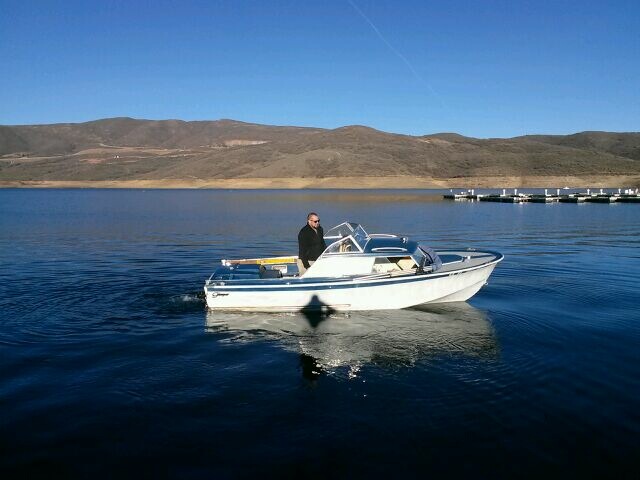

Re:I/O Glasspar Seafair Sedan, need engine advise... 10 years 9 months ago #117029
Hey you guys,I hope all is well. I did want to give you an update on where I am with my boat especially since you all offered so much valuable info to help me. So I found an amazing shop here in Salt Lake City, Davidson Marine. I took it to them and not only were they the most polite and helpful mechanics iv ever met, they loved my boat and felt strongly that the power and speed I need was only a tune up away. They performed a compression test that yielded great results. The old spark plugs had heavy corrosion and we're rather old. They felt that all should be well, with it and instead of taking the opportunity to take me for more money, they continuously gave me tips and money saving ideas that i could do to improve its performance. They saved me money left and right. So, I just took it out yesterday to jordanelle. I was blown away. I can best describe it like someone completely swapped boats with me. It drives, runs and performs amazing. Immediately in the water at idle speeds I could easily feel an improvement. And in the open water, she takes off. Plenty of power, more than enough speed and she planes so fast and is smooth as can be. The engine is actually a little quieter. I still can't get over the difference. I couldn't be more pleased. I have to make a shameless plug for both my boat, and my new mechanics and friends at Davidson. The are both in ship shape shape. So look out for one fast and sleek Seafair Sedan out there on the water, I'm gonna be out ALL the time now. And thank you all again so much for your input. I'll try and post more info as she continues to get better and better.
Re:I/O Glasspar Seafair Sedan, need engine advise... 10 years 9 months ago #117030
Cookin on the lake with a sweetly tuned merc 120.
Re:I/O Glasspar Seafair Sedan, need engine advise... 10 years 9 months ago #117031
Movin along. She definitely has all the power and speed I want/need. So very pleased.
Re:I/O Glasspar Seafair Sedan, need engine advise... 10 years 9 months ago #117032
Dream boat being just that.Running like a dream.
Re:I/O Glasspar Seafair Sedan, need engine advise... 10 years 9 months ago #117033
Lots to smile about.

Great to hear how well your 120 did. Those inline GM fours and sixes are hard to beat. Just noticed your pics of the floor in your boat. Looks to me like they may have already been replaced.
