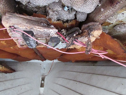

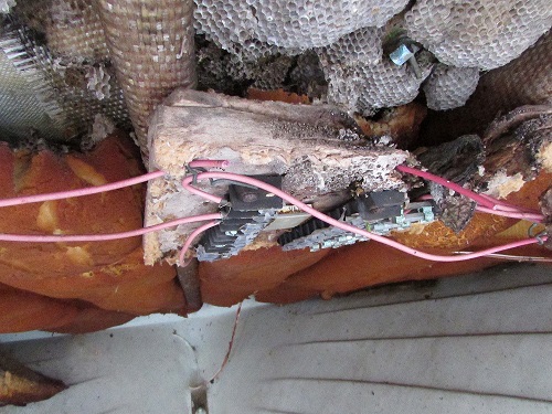

I am rebuilding a 1963 MFG Edinboro Custom, and while stripping the boat down ran into a fiberous board under the console to which the old fuse panel is attached. My concern is that it is asbestos. Does anyone know what this is? Has anyone else encountered this? I am including a few pictures. Yes, quite a few paper wasp nests under there.

Re:Does anyone know what this is? 10 years 11 months ago #115502
I highly doubt that is asbestos it is more likely MDF bored. If it truly worries you simply wear a dust mask, wet the material, remove it, throw it in a trash bag, tie up the bag and throw it away. Asbestos is only dangerous if it is airborne that is why you wet it down before removing.
Re:Does anyone know what this is? 10 years 11 months ago #115505
I blew up the photo, and it sure looks like simple MDF board to me. Why they would use it on a boat befuddles me....,., the stuff disintegrates in moisture'

Re:Does anyone know what this is? 10 years 11 months ago #115509
I'd wet it down either way, the stuff gives ya the "itchies" when it's cut or ripped apart.
Re:Does anyone know what this is? 10 years 10 months ago #115598
Thanks all! Well, its not MDF, but out it goes. Wetting it is an excellent suggestion, thanks! Turns out there is a lab that does asbestos, mold, lead, testing etc., so I dropped a bit off for them to check out. Probably some sort of fibergalss board, but I will post what the result is. As for the wasp nests, there were about 14 under there. They dont get to stay. The boat is probably not rated for 100 passengers anyways.
Re:Does anyone know what this is? 10 years 10 months ago #115964
Well, I took some material into a lab and had it tested. It does not contain asbestos, which is great. The analysis did not identify the material, but did indicate it was extremely flammable. Perhaps not ideal for a fuse panel? Anyways, wanted to post the results in case others encounter the same material.
Re:Does anyone know what this is? 10 years 10 months ago #115968
That fuse panel and other material was added by some previous owner. Fuse panels were not used in those days.
Looks like part of the original foam was removed, also, IT often detached from the deck when that old, so proabably partially removed at some point.
